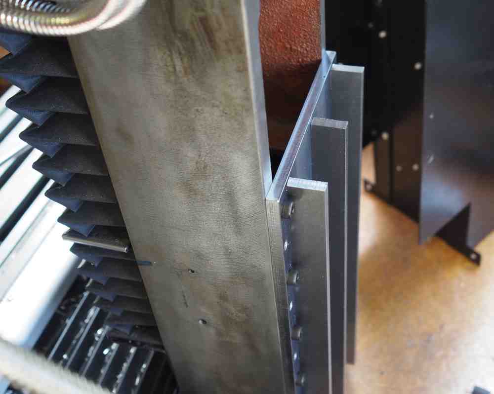

    Whilst fitting the DRO you will have seen that I created a space between the column and the power supply case.
    Enough space for a bracket.
    And so I created a Sieg SX2.7 stiffening bracket
    This has increased the static stiffness by 1.5x
  9. #7

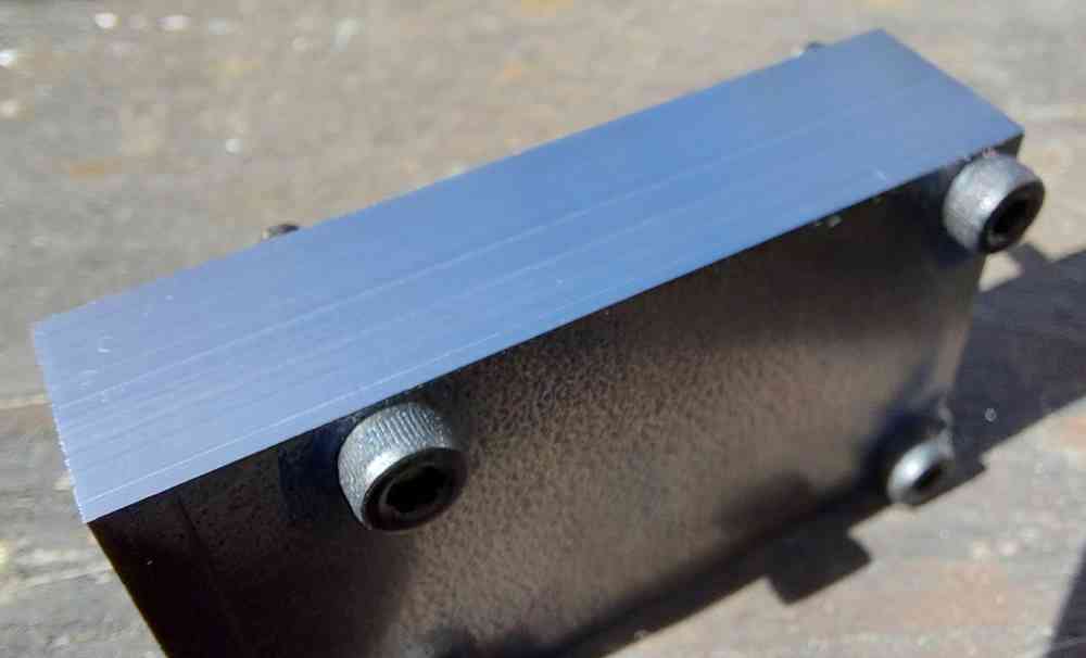

    Thanked 484 Times in 136 Posts
    editor@glue-it.com's Tools
    Mill Stiffness = Top Finish is definitely true, I made this end mill cut on 2 off 1/4" thick mild steel plates bolted together. I can feel that the vibration on the column is significantly reduced with the bracket fitted and when making this type of cut.
