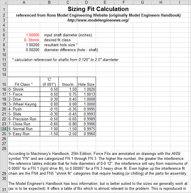

    Yup, I made a spreadsheet out of what looks to be the same info, select fit type from a drop-down menu. Just used it the other day in fact!

    Where can I find that, petertha?

    From my hard drive - Haha
    Hmmm.. I only see upload pictures & videos, do you know how I can upload .xls file?

    No, I'm a newbie here. Email me a copy if you don't mind? cdakers at fastrans dot com.

    Quote Originally Posted by petertha View Post
    Could you email me copy of your spreadsheet.
    jensor4 at Verizon dot net

    done & done
