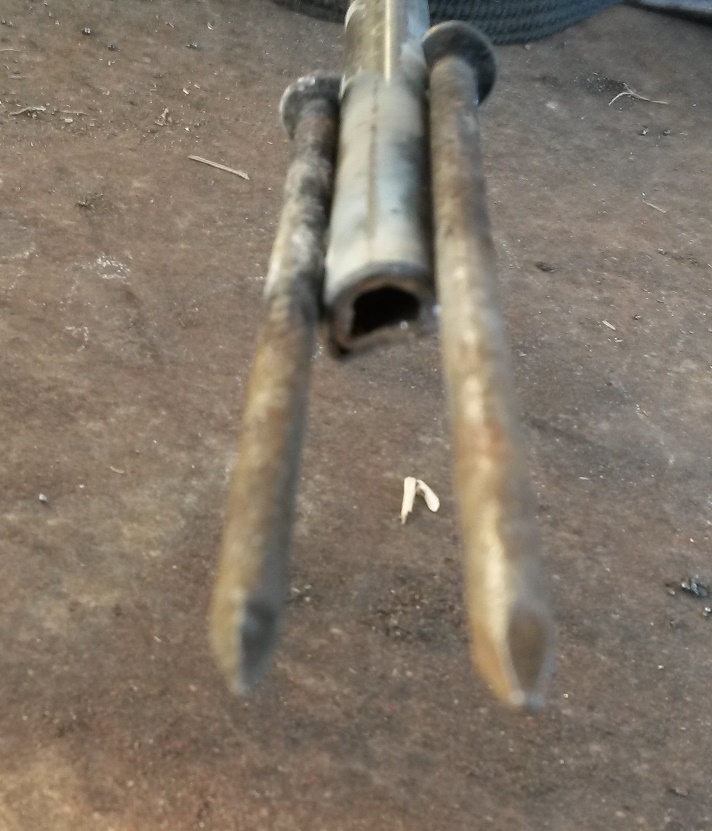

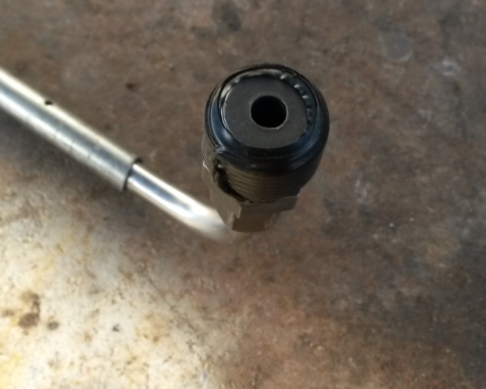

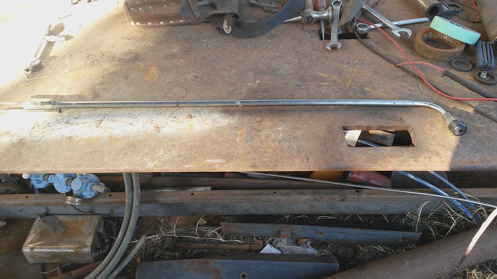

    I had been just using a length of SS tubing and never thought of adding lifting spikes until you posted this so I went out and slid a 1/2" tube over my 3/8" tube to give it more strength then welded a pair of 30 penny nails to it so now my blow tube is a blow poke Thanks Jon for the idea
    Fireplace blowpoke - photos and patent-20180111_155408.jpga.jpg Fireplace blowpoke - photos and patent-20180111_155450.jpga.jpg
    Some day I might make a proper mouth piece for it not just now though because I do not run my lathe when the shop temps are below freezing unless it is an emergency

    Nice! I was going to suggest to bend the nails a bit, but then I saw that the top of your tube is bent. Interesting. I do kinda have to hunker down a little to use my blowpoke; perhaps I do want the end bent.

    Just tended the fire while observing my blowpoke use more carefully; I think I might want both a bend at the mouthpiece like you have, and bent forks.
    I just realized that I use the bent forks as a simple coal rake. Rarely I will also use this fork as a stray coal pickup tool; I press the fork down on the hearth vertically, around a fallen coal, and then I tap it inside the woodstove to discharge the coal into the fire.

    Ijust left mine straight since I already have a rake which works admirably For heating your hot tub with a wood stove try constructing a Rocket Mass heater around it. Instead of a straight line horizontal mass with the flue inside, make it do a near full circle, then have the chimney Tee" into the horizontal part. This way you can circumvent the 25 or 30 feet of flat line chimney when starting up the rocket stove. Once the secondary combustion chamber reaches critical mass temps you close the cut out causing the super heated exhaust to be routed through the horizontal flue which in turn heats the cob mass encompassing the hot tub and water lines you have embedded in the cob following the pathway of the flue. Add a brick or stone wall around the whole thing leaving a small air space between the cob mass. Then top with a nice teak deck made of 1 by 3 slates set on edge spaced 1/2" apart. Build a gazebo over the whole thing with roll-down bamboo curtains for privacy, and to retain the heat for those cool evenings. If it works mention my name once in a while to friends. If it doesn't work tell them who the idiot was that suggested it anyway
