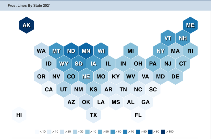

    I am presuming the depth of the pipe is to prevent freezing?

    To prevent freezing, but also to get down to the depth of the water main. Intrastructure has to be installed to satisfy many requirements. One of which freeze protection. But others include protection from physical damage, interference with other utilities, accommodations for terrain changes, etc.
