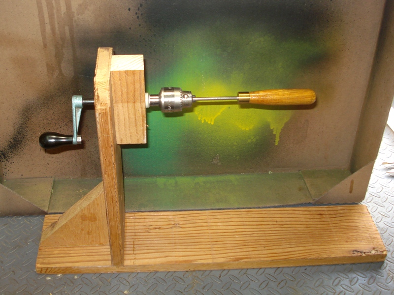

    In woodturning, the easiest way to apply a finish is while the piece is still mounted at the lathe, either with the lathe running, or stopped and turning by hand.
    When this is not possible or for finishing other small pieces, a device like the one I show is handy, and can be used along with a spray booth. The finish can be applied with airbrush, spray gun, aerosols, or even with paintbrush.

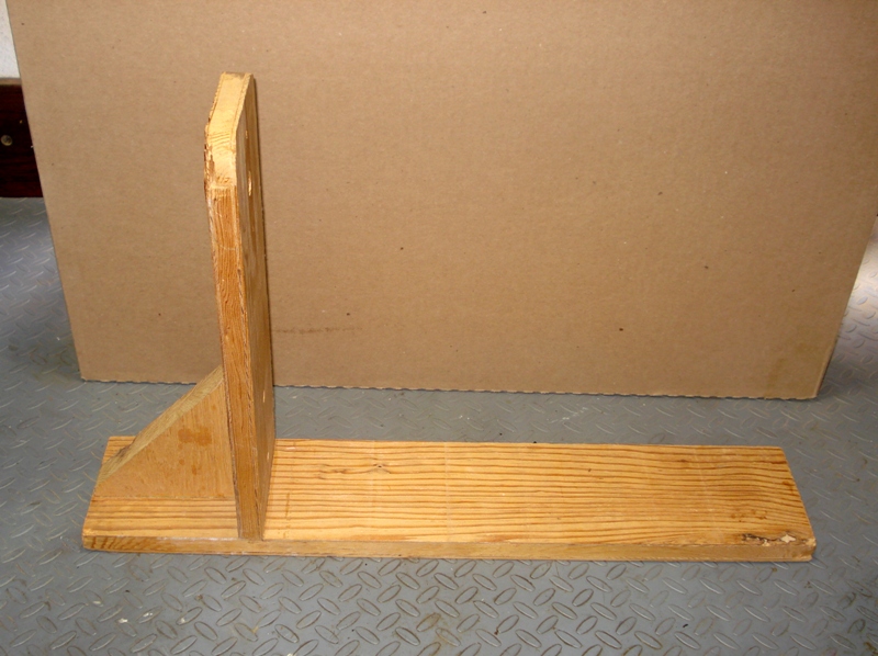

    The following photo shows a squaring jig that I made a long, long time ago (for assembling drawers, I guess), which worked fine for this project:

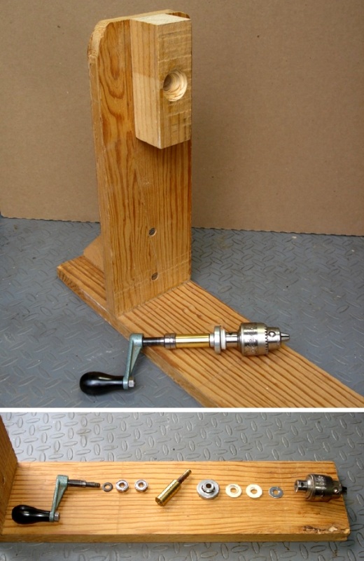

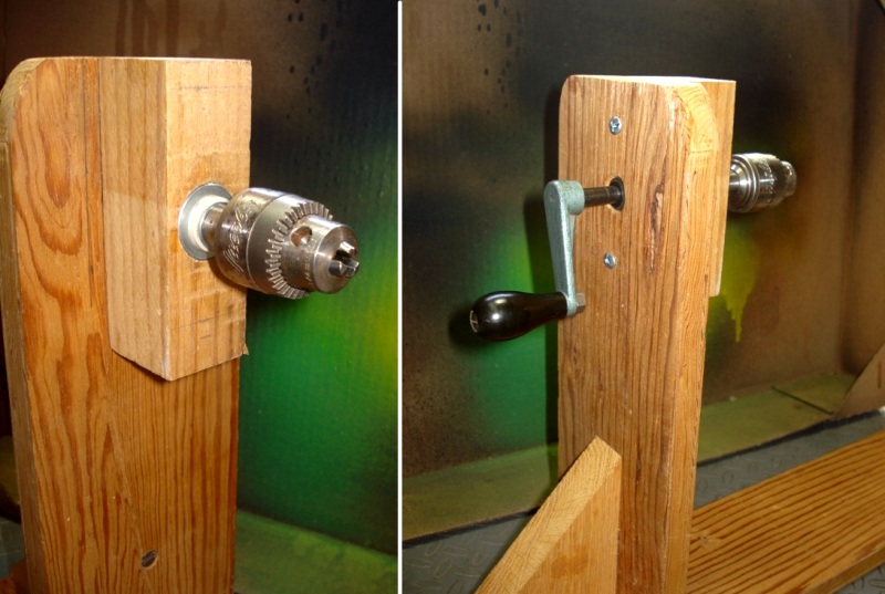

    The turning mechanism consists of a crank attached to a drill chuck, plus bearings and washers, all of them reused items, stored in the workshop.

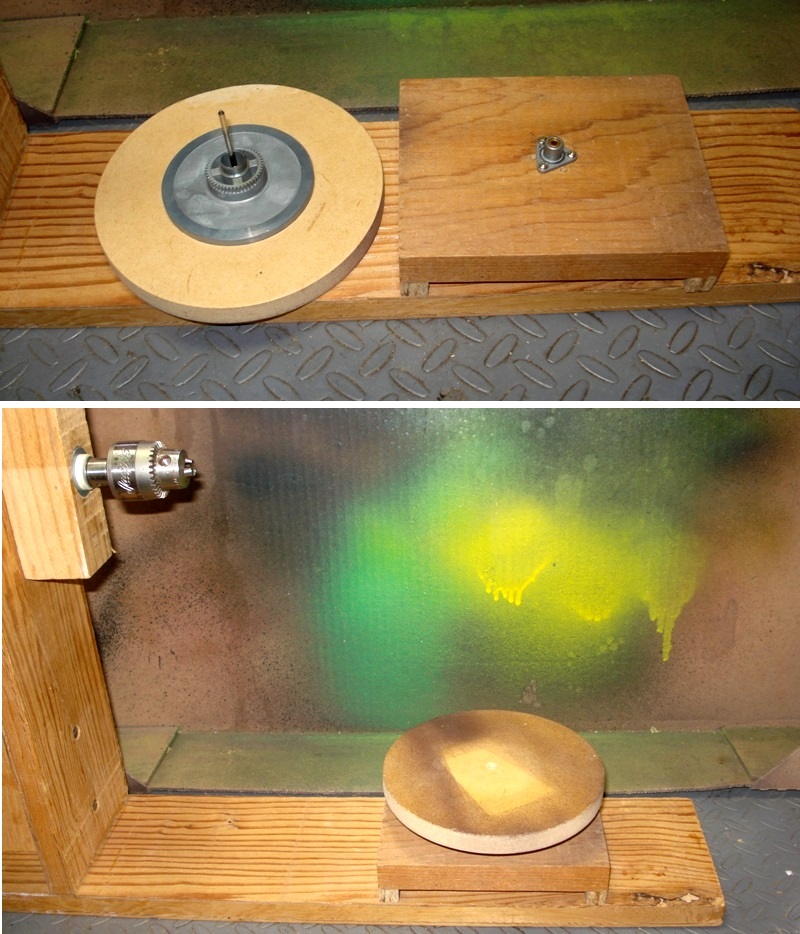

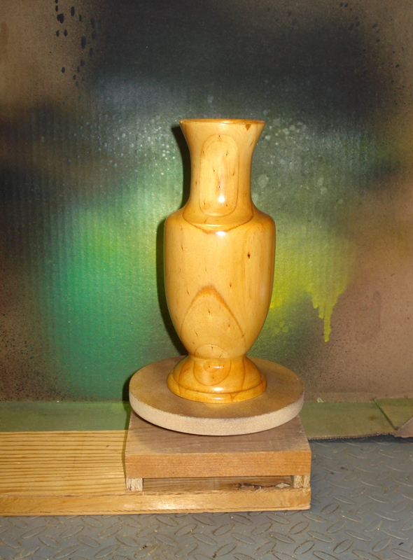

    A rotating horizontal plate (lazy Susan-like) was added to finish standing pieces.

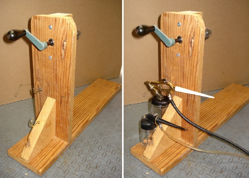

    Finally, the device is provided with hooks to hang the airbrush, while it is not in use.
