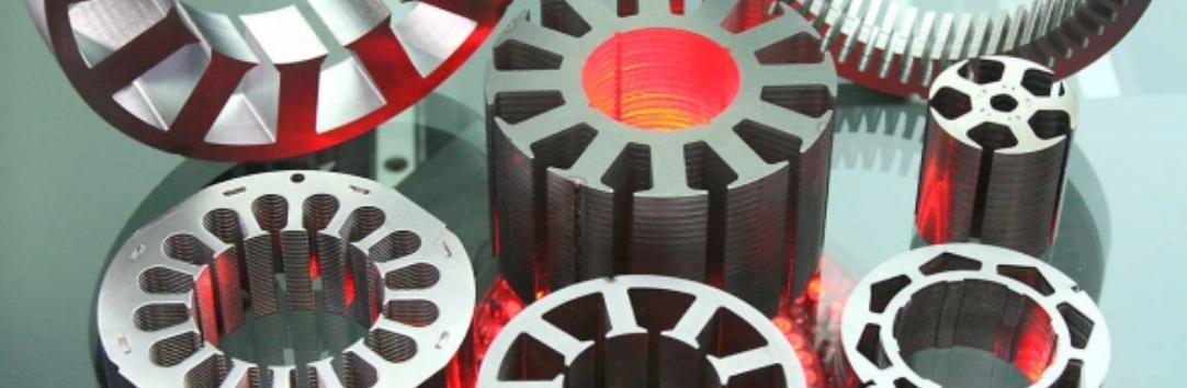

    Dear Gargoyle,
    thank you for the video. I saw some more of them but didn’t find them anymore. What scares me is the filed pieces under the feeler gauge.
    Devotion to hand tools is (was) decisive to the tool makers trade. The apprentice learns 2 prerequisites to be a master: 1. To know the importance of 1/2 thousanths of an inch and 2. to be resistant to fatigue and boredom. Remember that 60 years ago the dies for rotor and stator laminations were (after a rough milling) filed by hand;Filing rest for vise-ankerblech.jpg12 or 24 or 36 identical shapes, in some cases already hardened. And even when the dies were dimensionally correct: The dies of certain toolmakers lasted, say, 150.000 strokes, whereas the dies of others lasted just 100.000. It was a ‚game‘ of competition and reputation.
