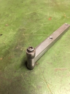

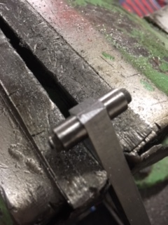

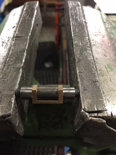

    Hi All

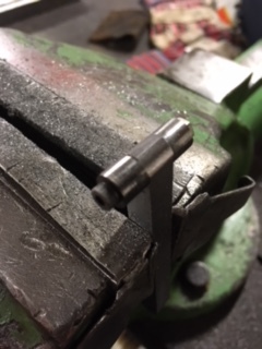

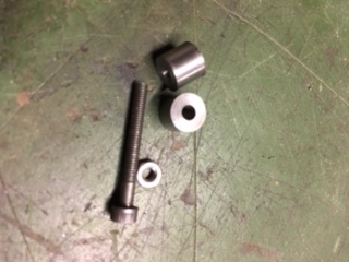

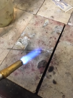

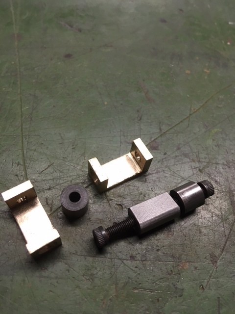

    This is a method I use whenever possible as it is quick easy and accurate to file a radius on a component. I have a tin of these I have made over the last 30 years all types and sizes. Sometimes I get lucky and find a pair of buttons I have previously made. The photos below show the method taken to put two radius on a key. The holes in the end of the key are, drilled 3mm to be a close fit on the clamping bolt. Once the radius are, filed to shape, these holes will then, be opened up to 3.3mm and tapped M4. The reason for this is, if I ever need to remove the key, I can use these M4 threads as jacking points.

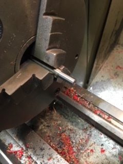

    Turning and drilling silver steel rod
    Parted off and faced both end square
    Heating the silver steel to harden, I do not bother tempering as I feel there is no need.
    The harden buttons, are clamped in place with a M3 socket cap screw, which is a snug fit in the holes of both the key and the buttons (good engineering term lol)

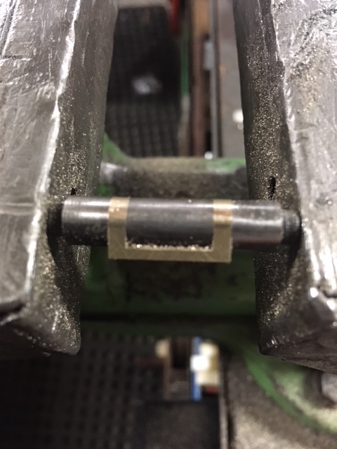

    Held in a vice and just file down until the file is in contact with the buttons.

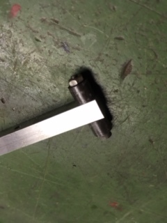

    Finished radius.
    Key fitted with no additional fitting. Nice tight snug fit
    Thank you for taking the time to view
    The Home engineer

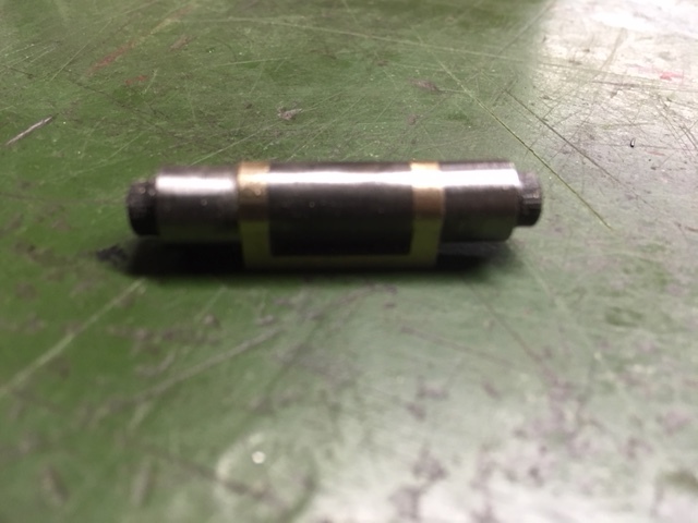

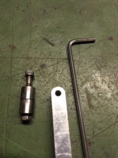

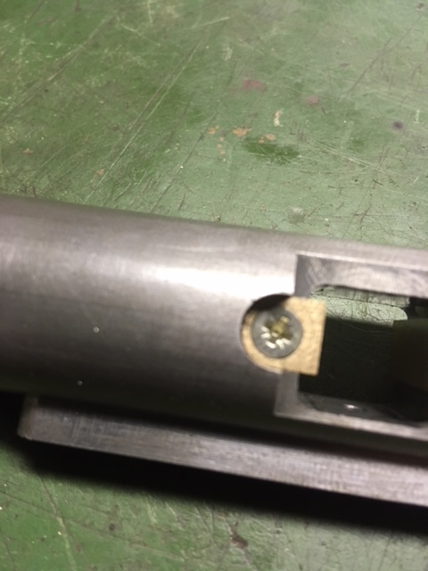

    File button follow up
    Hi All

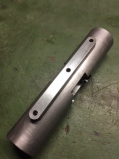

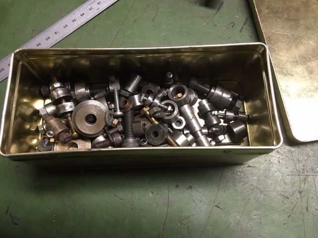

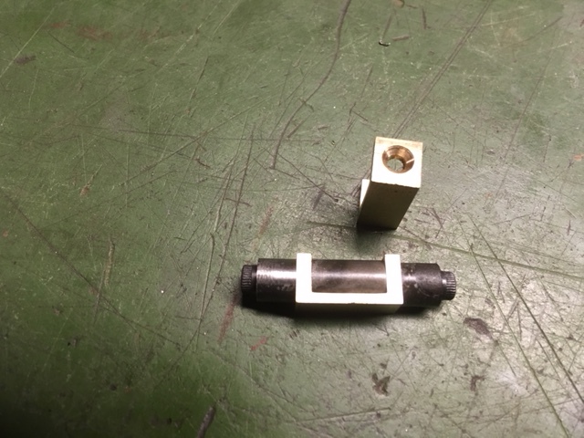

    This is a follow up to my post on file buttons. I had to file two radiuses on one component last night and made a button for this application. The other two buttons are the ones I previously made for the key.
    The middle button was, machined with a flat so it would fit on the correct centre line of the component and tapped M3. The reason for tapping the button, I did not have a long enough M3 bolt so used tw0 shorter ones bolted from either side. Once finished the two items fitted a treat with no fettling needed. It takes longer to make the buttons and harden them, then to file the radiuses on the work piece but well worth the effort. The tin box is a selection of buttons I have made in the past.
    Thank you for taking the time to view.
    The Home Engineer
