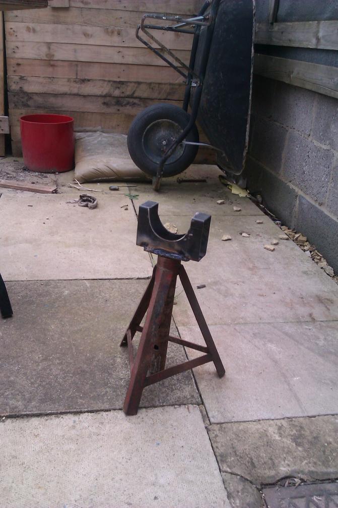

    heres a couple of bits i made to make life easier whilst restoring my 110 landrover.

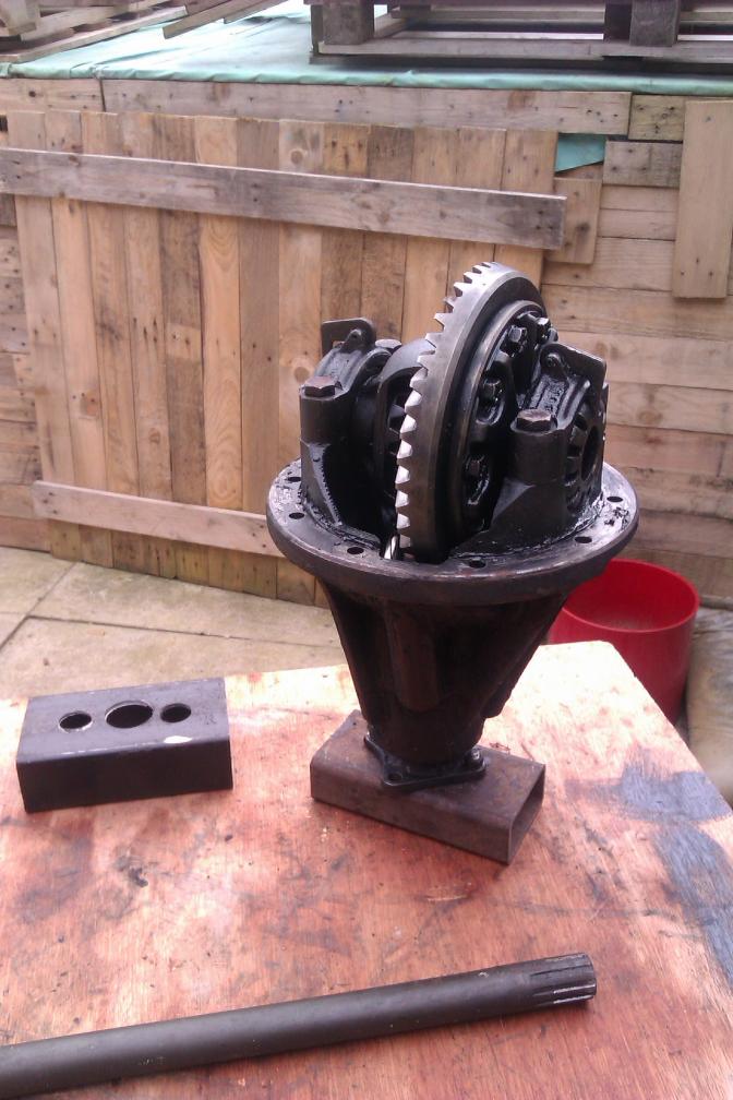

    1 is a stand to make it easier to store spare difs, next to it is one to show how its drilled.

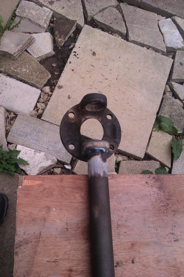

    2 is brace bar to make it easier to undo pinion nut as they can be a pig, its made from scrap part of propshaft with an old half shaft welded to it.
    can be used on or off vehicle.
    3 is a modified axle stand that supports the axle by fitting round it rather than small area under it.

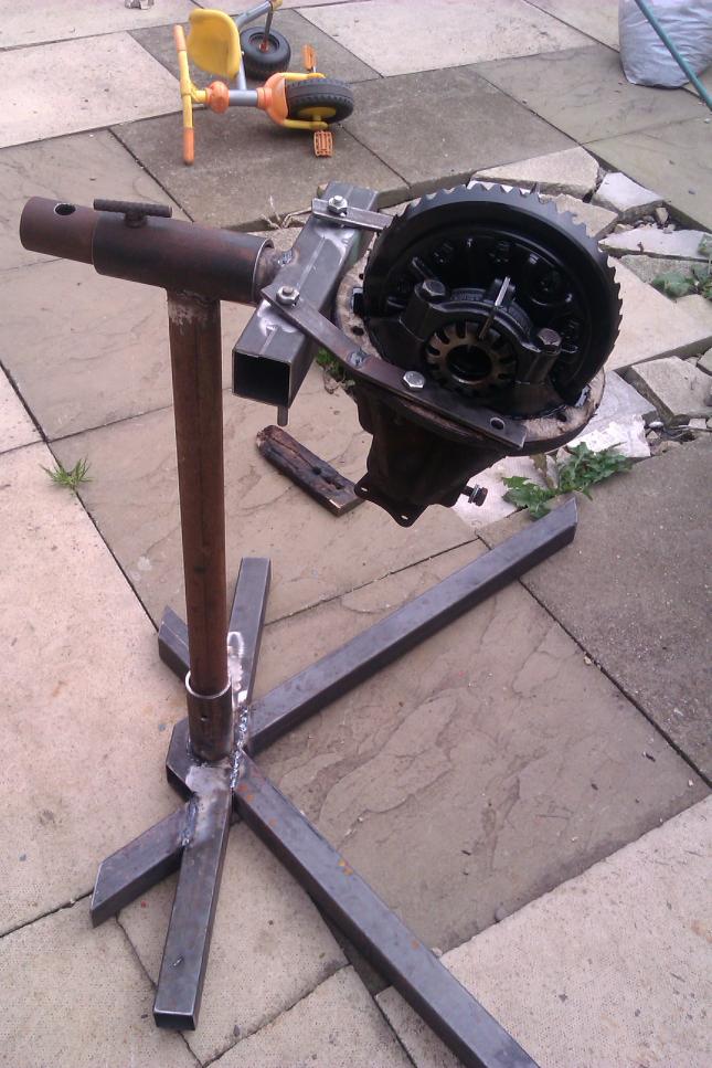

    4 is a work in progress multi-purpose stand it comes apart for storage.
    at moment its got diff holder on it to allow working on diffs, later on will be making holders for engine, gearbox, transfer box, axles and front hub/swivel assemblies.
