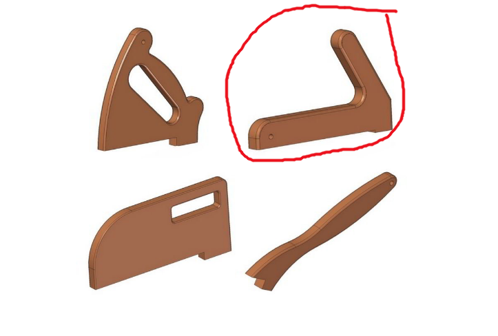

    Quote Originally Posted by therosehermit View Post
    I ended up making this one:
    duct tape, frank, what do you mean really?
    cause I've looked at the ones you suggested duck and except for that one:
    Attachment 45039
    except for that one (if I were to hold it from the very top), the hand position for the rest all seem to run pretty close to the blade (well I'm ignoring the obvious sole stick).
    It could be the angle of the photo that causes it to look unstable. I shouldn't have been so quick to judge, because everyone has their preference. A few close calls with push sticks that have a horizontal handle makes me not want to use that style.

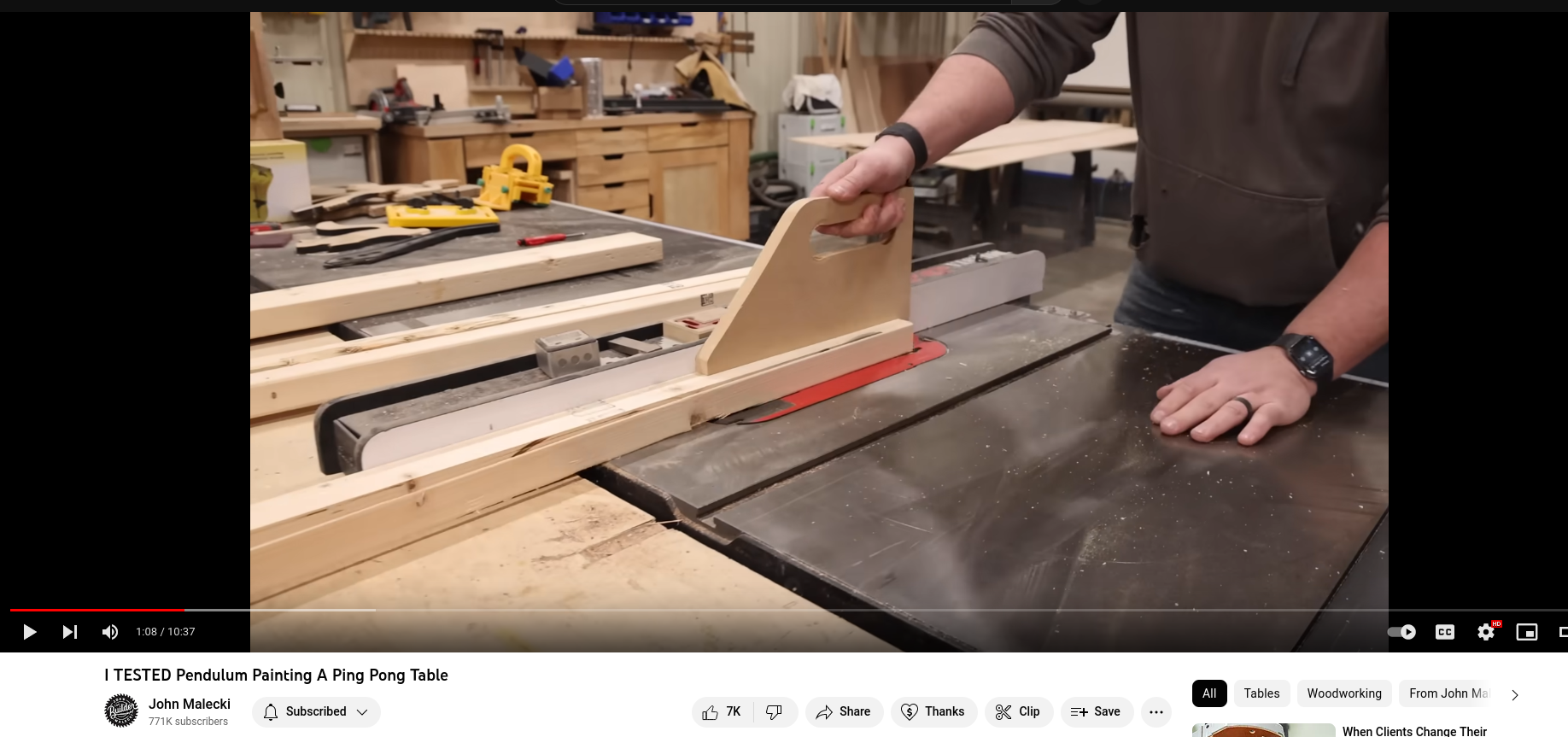

    y'all check this bad boy from John Malecki xD... solved the close to the blade problem!:
Name:	pushstick genius.png
    Plan for that flange on the end to break, or for it to slip off the end of the workpiece.
  11. #20
    therosehermit's Avatar
    Feb 2023
    5
    Thanked 0 Times in 0 Posts
    fair point. will improve it.
