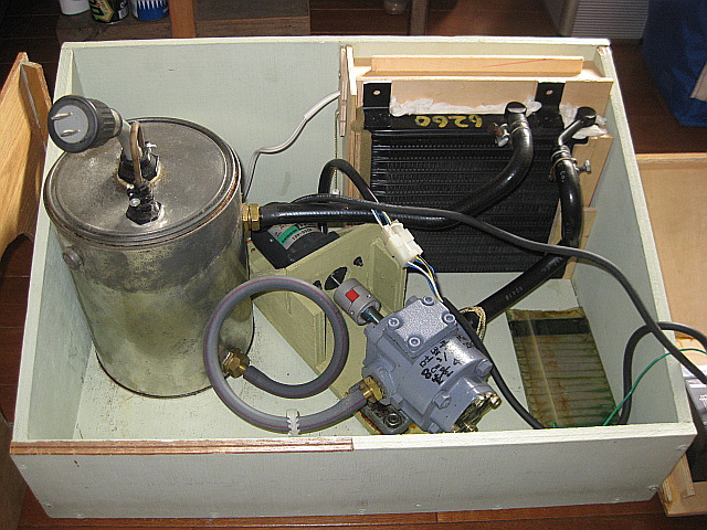

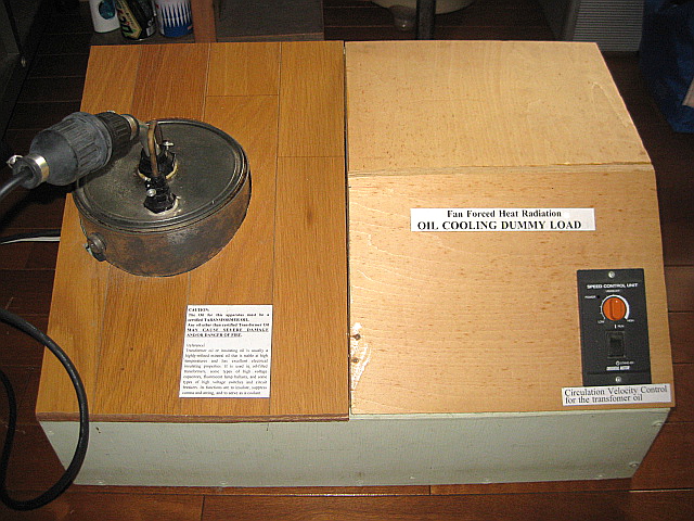

    Oil Cooling Dummy Load with Radiator
    Made a dummy load with cooling fun.

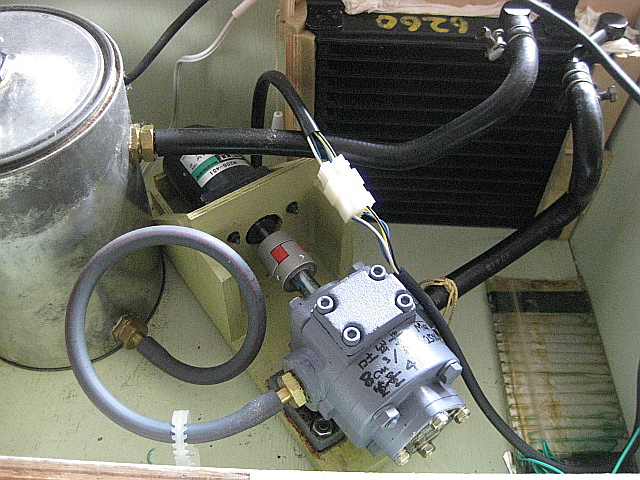

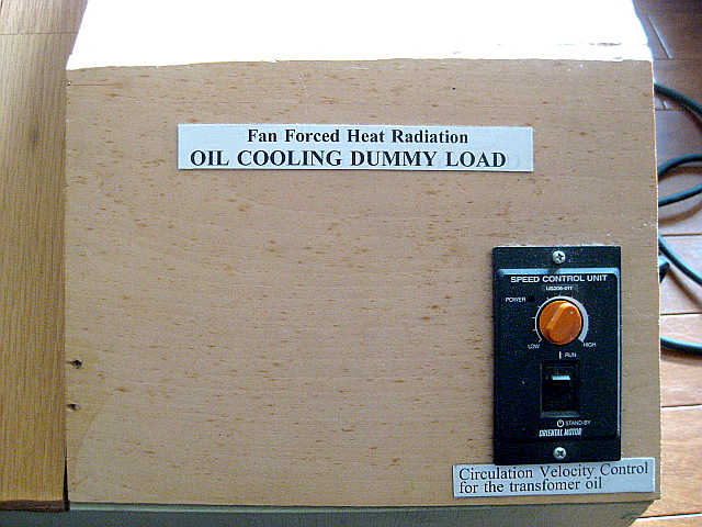

    She has a circulation unit for the cooling oil, this is the speed controller.

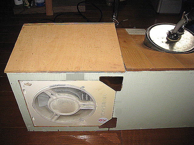

    At the back a fan is built in next to the radiator.
    I got a nice radiator from a junk yard in the vicinity.
    It was fortunate to me that I got a new-old-stock trochoid oil pump, but it seems to be a tad over-killing.

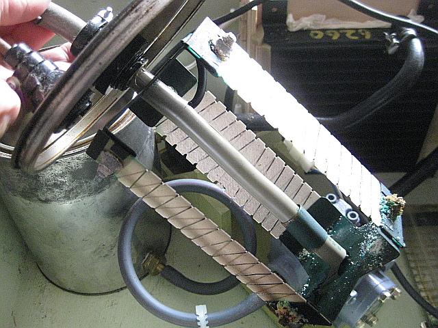

    I made several types of load, this one shown below is of 50ohms, a standard type.
    Not yet calculated the capacity, but I suppose this can withstand more than 3kw.

    Nicely done cooler. And I like your load. Nichrome wire?

    Hello,@mwmkravchenko thanks for comment. Yes it's nichrome wire.

    And it's wrapped around on a mica plate.

    Nice. The other possibility is a ceramic tile. You will have a great amount of cooling capability with your setup.

    That will be also fine Mwmkravchenko, ceramic one may last longer in higher amperage.
