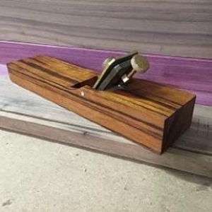

    Here is my family of Shop-built Hand Planes. Each one was hand-crafted by me from brass and exotic hardwoods. That is, scratch-built; no kit was involved.
    Attachment 9173
    From left to right we have a roughing smoother (designed to remove wood quickly), then a fine smoothing plane that gives a quality finish. Next a high-angled polishing smoother, 60 degree pitch (This plane can produce the finest of shavings. A painter/decorator friend of mine observed that he would not be able to get the same finish as this plane can get, with sandpaper). It works a bit like a scraper plane; it's really cool! Next comes an old-style smoothing plane with oak-leaf front, designed for small works (This little plane is a delight to use) and finally a low-angled mitre plane.
    Here is a rear/side view of the set.
    Attachment 9174
    Most of my planing needs are catered for with this set of planes, except perhaps chamfering. But Look!
    Here is an adjustable Japanese style champhering plane I made a few years ago which covers that problem:
    Attachment 9175 Attachment 9176
    Oddly, this is the only plane in the entire set that has an adjuster; the rest are hammer-adjusted. I moved away from Norris style adjusters a few years ago after reading Ron Brese's theories on adjusters. Now, any plane I make is hammer adjusted. There is a certain skill in hammer adjusting but it is learned quickly, and once mastered the finest adjustments can be made by the deftest touch of the hammer. It's fun to do as well.

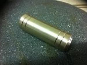

    I use either a small conventional type hammer or my preferred, palm-hammer, which slips easily into my shop-apron pocket and is therefore, always at hand. I find the palm hammer gives me greater control over the hammer tap than a handled hammer. This is the palm hammer:

    There is real satisfaction and an exquisite pleasure in constructing projects using tools that you have made yourself by your own hand. Words cannot describe that feeling. You have to immerse yourself in it to appreciate it.

    Brendon, by the way, to come back to your palm hammer, could you explain a little bit more how you proceed, how you handle the plane, the palm hammer, where you tap ? A little video with that would be great !

    OK, how to adjust a hand plane. Let's say you are putting the blade back in after sharpening.
    I usually proceed as follows:
    Place the plane down on a dead flat surface (I like to use a sheet of glass but a clean melamine surface will work too).
    Slide the blade down along the bed gently until the tip of the blade makes contact with the glass surface.
    (With many planes you will be doing this with the blade bevel down; with low angle mitre planes it is usually bevel up).
    Be gentle, you do not want to damage the newly sharpened point of the blade. Keep the blade as straight as possible in the plane. In other words, don't let it lean over to the left or right. Once you feel the blade touching the glass, tighten the lever cap knob to snug, do not overtighten but tighten it enough that the blade isn't going to slip when you begin to use the plane. With practice you will get to know how tight this should be.
    Because you have set it up on a dead flat surface the blade should be sitting straight in the plane.
    Gently try to take a test cut on a piece of wood held in a vice.
    You may be lucky and plane may cut nicely first time. If that has happened, Well Done!
    If the plane does not cut at all, gently tap the top end of the blade (very gently does it, you are not driving a nail!).
    This will push the blade a little further down the bed.
    Try another test cut. You may have to do this a couple of times to get the plane to cut.
    If, on the other hand, the plane is cutting too deeply, tap the rear end of the sole of the plane. The little shock wave that this sends through the body of the plane will retract the blade ever so slightly. Make sure the lever cap knob is tight and take another test cut.
    This cut should be lighter than the last one. Keep repeating this exercise until the shaving is a light as you want it to be.
    If the plane is cutting deeper on one side than the other, you can gently tap the upper side of the blade to coax it over a bit until the plane cuts evenly across its width.
    All this sounds like a lot of work but after just a little practice you will set your plane in a matter of moments.
    As regards the hammer, you can use any small hammer. I just like my palm hammer because it gets me closer to the blade, if you know what I mean. I usually hold it a bit like holding a pen, between the first finger and the thumb and tap with the forward end of the hammer. I find the palm hammer is more accurate (for me anyway) at gauging the force of the tap. In my mind I don't have to compensate for the extra force created by the leverage of the long handle on most hammers.
