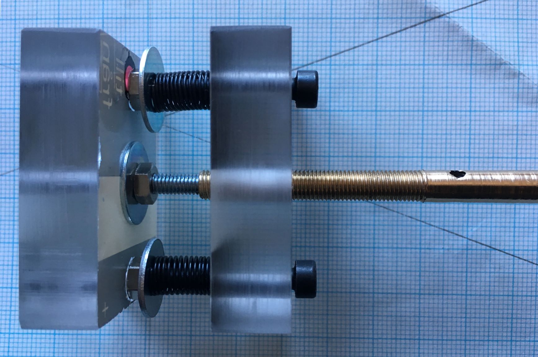

    Coincidentally I'm into another upcoming metrology project where I'll need a zero backlash differential screw as well
    (same solution as in this post: Repeat Reading Gage - DIYSwede's "Cheap-O-Meter"):
    Special RH thread M6 x 0,75 mm and standard RH thread M4 x 0,70 mm, will give a LH screw with a 0,05 mm pitch...
    Proof-of-concept "acrylic vise":

    Now we understand the zero-backlash:
