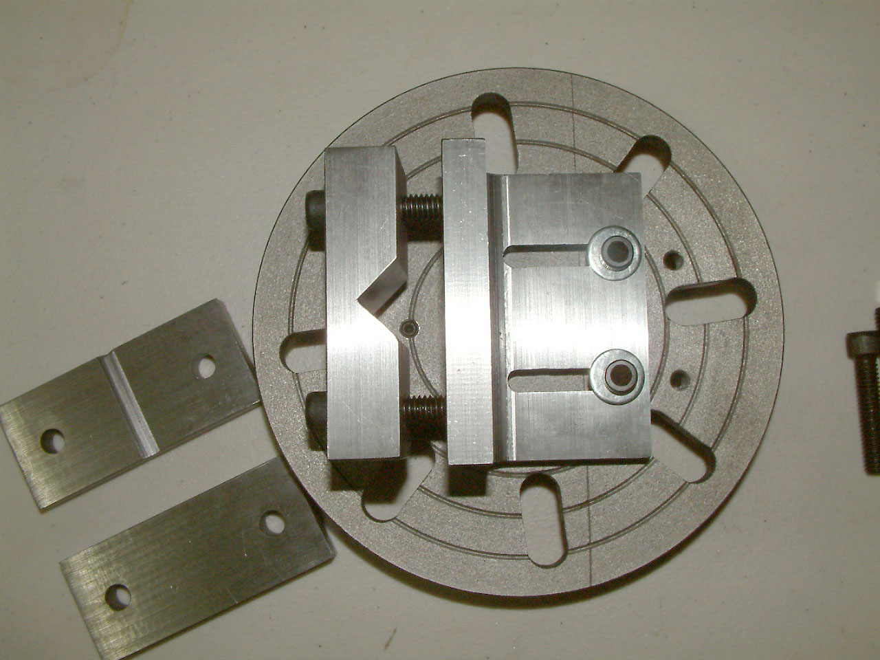

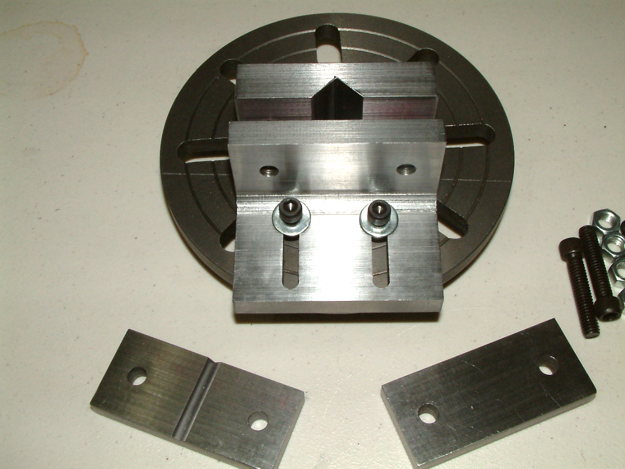

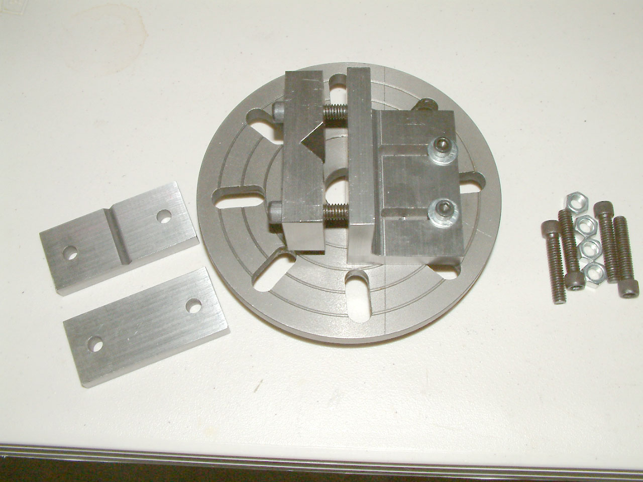

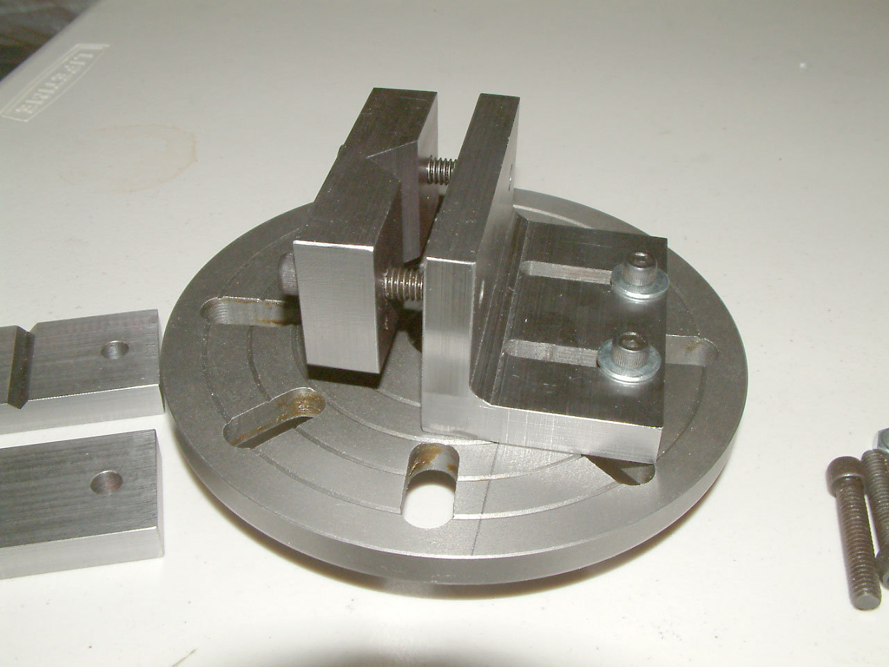

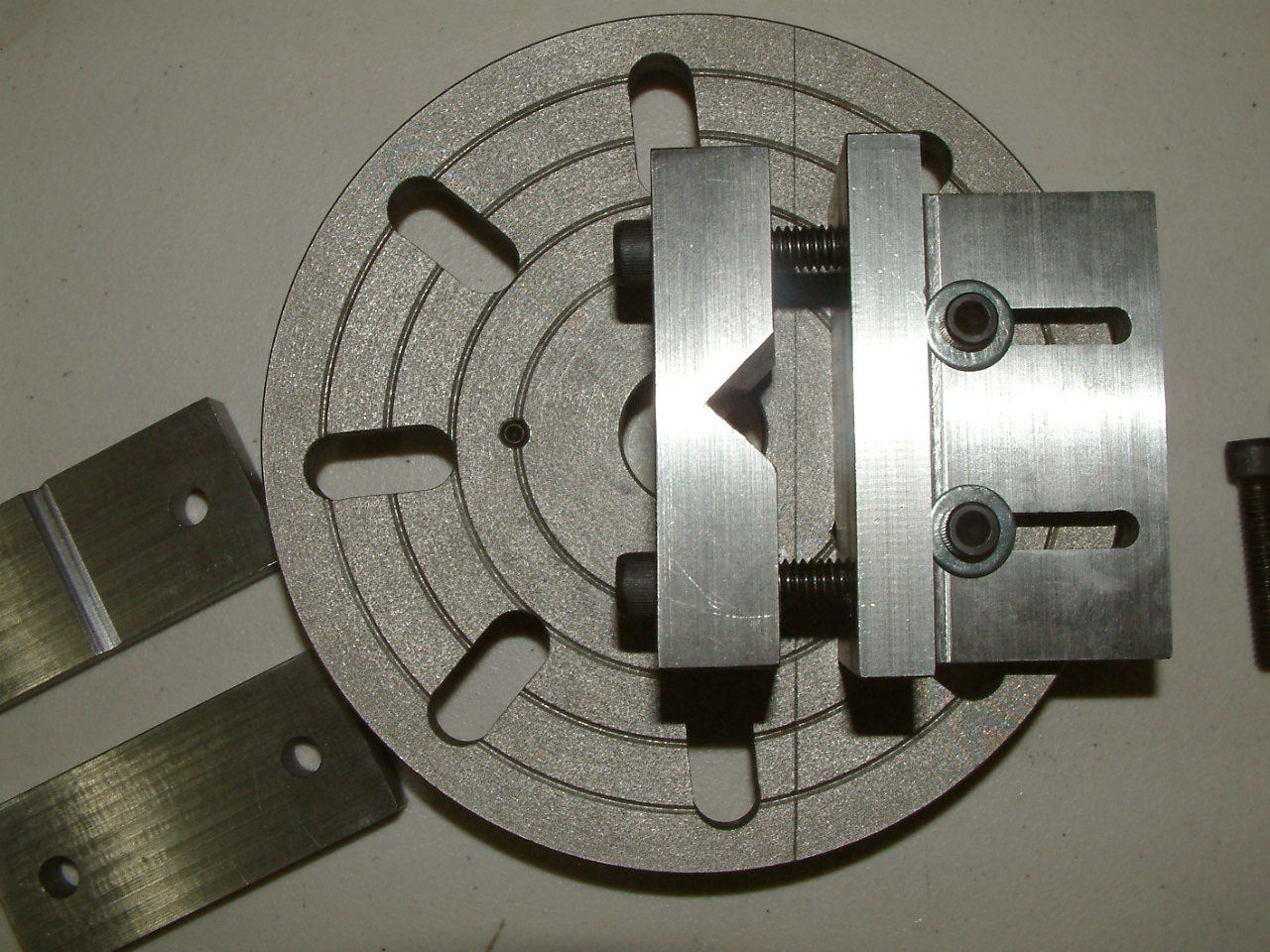

    Just a little fixture for my face plate to allow holding parts that may be odd shaped. The face plate is cast iron from Little Machine Shop. Holes were drilled and tapped in the face plate for this jig. There are 3 sets of "jaws" shown, one for large diameter, one for small, and one blank for whatever. Works with round also but then so does a 4 jaw chuck. Made from hot rolled steel plate and one slice from some hot rolled angle iron. This was really just a test of my "surface grinder" but I wanted to make something usefull that I could use when I get around to making my steam engine.

    You've almost made yourself a "Keats angle plate", a mainstay of model engineers in the UK. One of the best of the latter had an extensive discussion of the tool over at MEM...
    http://www.modelenginemaker.com/index.php?topic=632.0
    You might enjoy reading it.
    Regards, Marv

    Thanks Marv,
    I have enjoyed your tool posts for quite a while now. Even before I had my mini lathe and mini mill. I have all of your freeware (stored in more than one hard drive) that I have seen on the net. Thanks for all of your hard work and inspiration for machining.
    And now the secret is out. I almost titled my fixture "Keats Like Plate". The Keats angle plate is the exact inspiration for my fixture but I thought I would simplify it a bit and use some of my in house stock.
    This is one great hobby that has replaced my model airplane building or at least put it on the back burner.
    Cheers, JR
