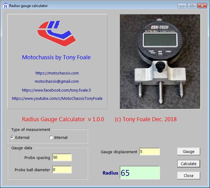

    Here is a link to my calculation software, it is an unrestricted download.
    RadiusGauge software
    It will work equally well with Marv's method.
    Extending the range of calipers-software.jpg Click image for full size version.
    To use with Marv's method.
    1. Chose "External" for type of measurement.
    2. "Ball diameter' set to zero.
    3. "Probe spacing" is the caliper reading.
    4. "Gauge displacement" is the height (length) of the caliper jaws.
    As a test I used Marv's figures, which were:
    For the bench block pictured, I made the following measurements...
    c = 2.859 (no. 3 in my list)
    s = 1.159 (no. 4 in my list)
    and computed a diameter of 2.922.
    The software came up with a radius of 1.461 which is the same as Marv's result.
