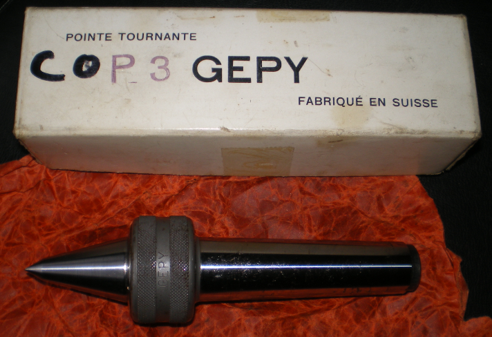

    These extended centers are great and you made a typically nice job of yours.
    We used to use these at work and I bought a new Gepy No 3 in anticipation of also buying a Bantam lathe but the receivers got it first.
    I cant use it so its going on Ebay if anyone wants to look out for it.
