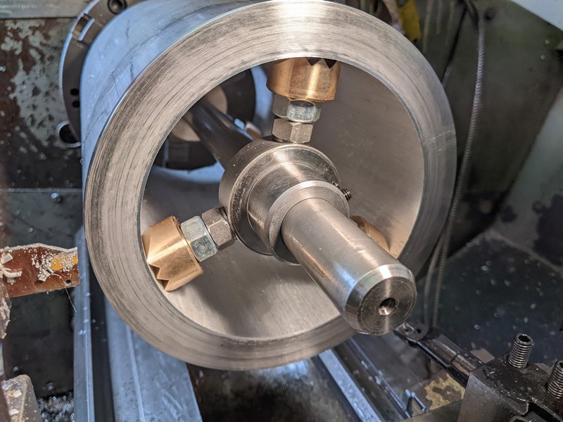

    Cutting a large thick-wall tube to make antenna support rings on my lathe was a big challenge. Southern Comfort and too much coffee resulted in an internal mandrel fixture that works quite well. I can now hold large heavy tube and machine the outside and both ends with ease.
    I can't claim any originality for this fixture. It's probably got a proper name but I don't know what to call it. "Expanding Tube Mandrel" will have to do.
    Expanding Mandrel for turning large tubes-pxl_20211224_221429892-small.jpg Expanding Mandrel for turning large tubes-tube-fixture-v23a.jpg
    I don't have a steady rest, but machining the outside and ends of a tube when using a steady rest means a lot of extra steps, and this thing can stay with the workpiece if I part off a thick ring then want to machine it before cutting another. Once the lathe is clear again, I can just pop the tube back on, complete with the mandrel still inside. Also, finding a big enough steady rest to fit 7+ inch tube on my Colchester 1800 would be amusing.

    As Frank S will say "That is thinking outside the sphere!". It certainly is. Concept of 'the box' actually has limited coordinates, whereas a sphere contains unlimited points of reference.
    That said, I've run a lot of tube, most often from paper manufacturing and printing industry. It has to be supported at each end, for concentricity, lack of taper, and plain old safety. The go-to holding method(s) securing outboard end, always limited to a] false center, b] steady rest, c] bell center. Job requirements often relied on a tailstock mounted 4 jaw first, getting both ends centered up and turning a band for steady rest bearings to run. An interesting complication; some rollers have rubber bonded outside. Good luck spinning that in a steady rest! (Hint; tooled up clamp-on rings).
    Thinking back how many times your mandrel would have offered a solution OUTSIDE those mentioned, without discounting some of those rollers were 10 and 12 feet long, several hundred pounds, one of a kind - no spares, late at night - no replacement material......or killing whole production line.

    As consolation, your fixture has a name; it's called a Spider. Related version commonly used outboard the spindle end, supporting small material.

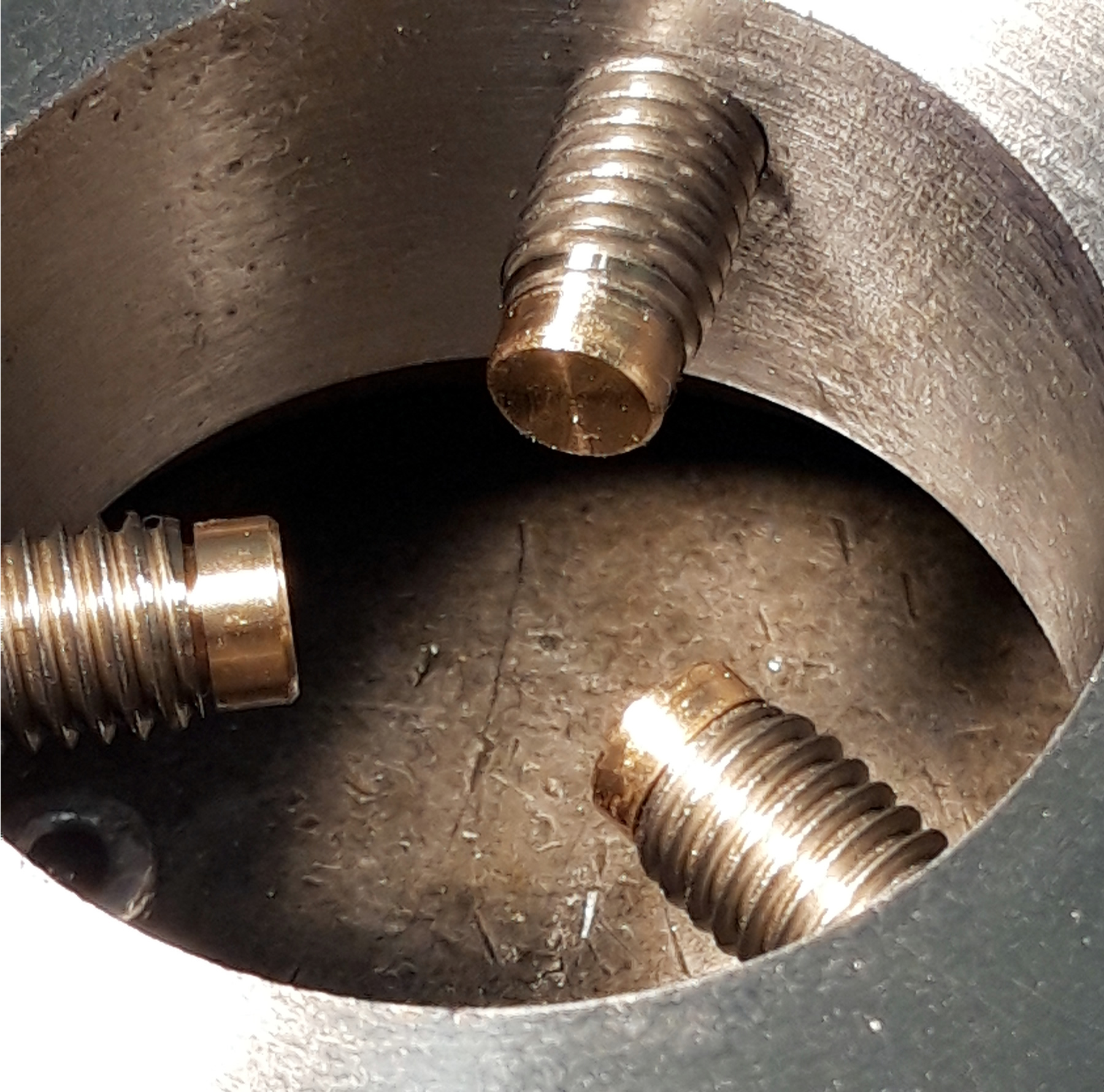

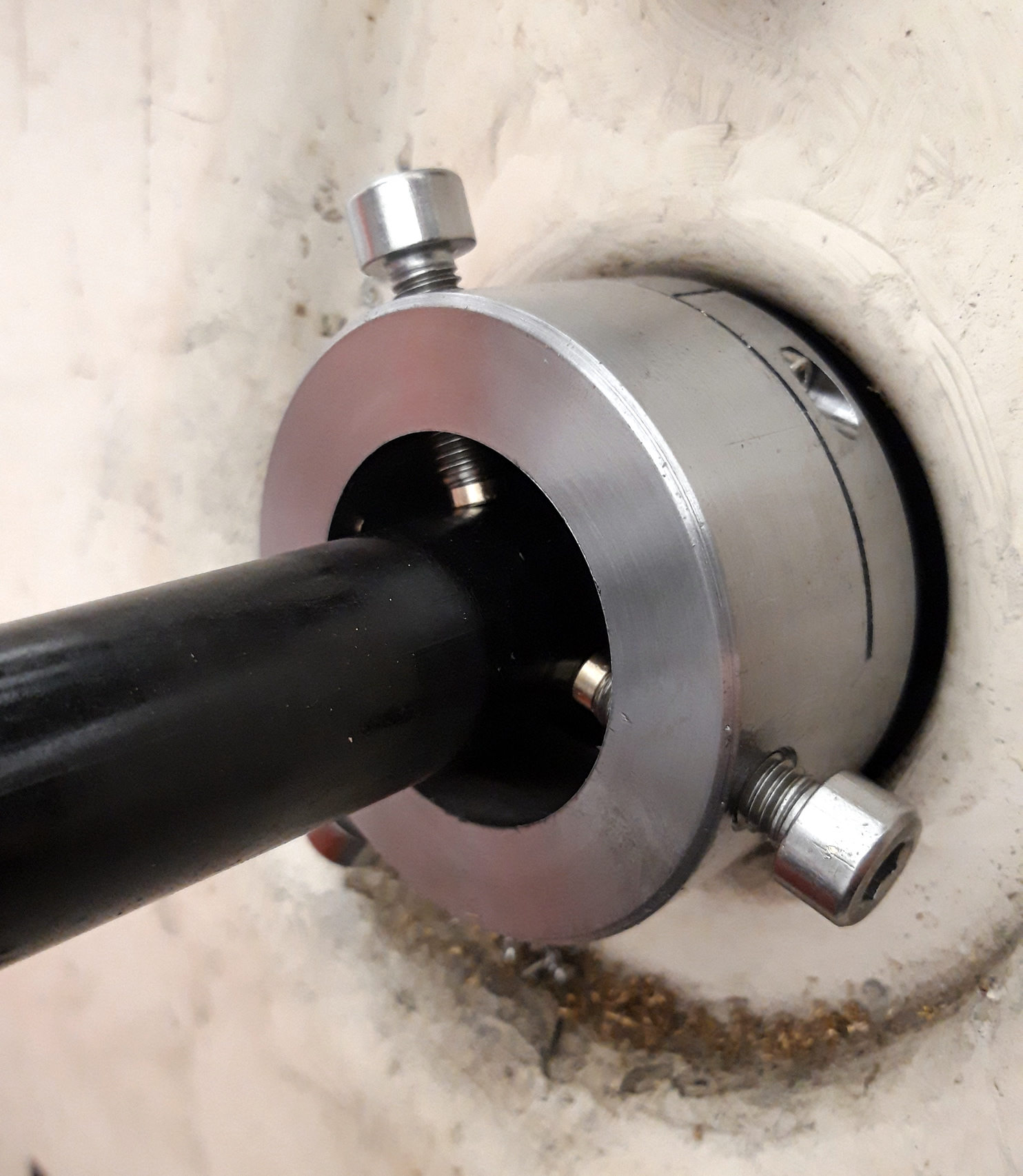

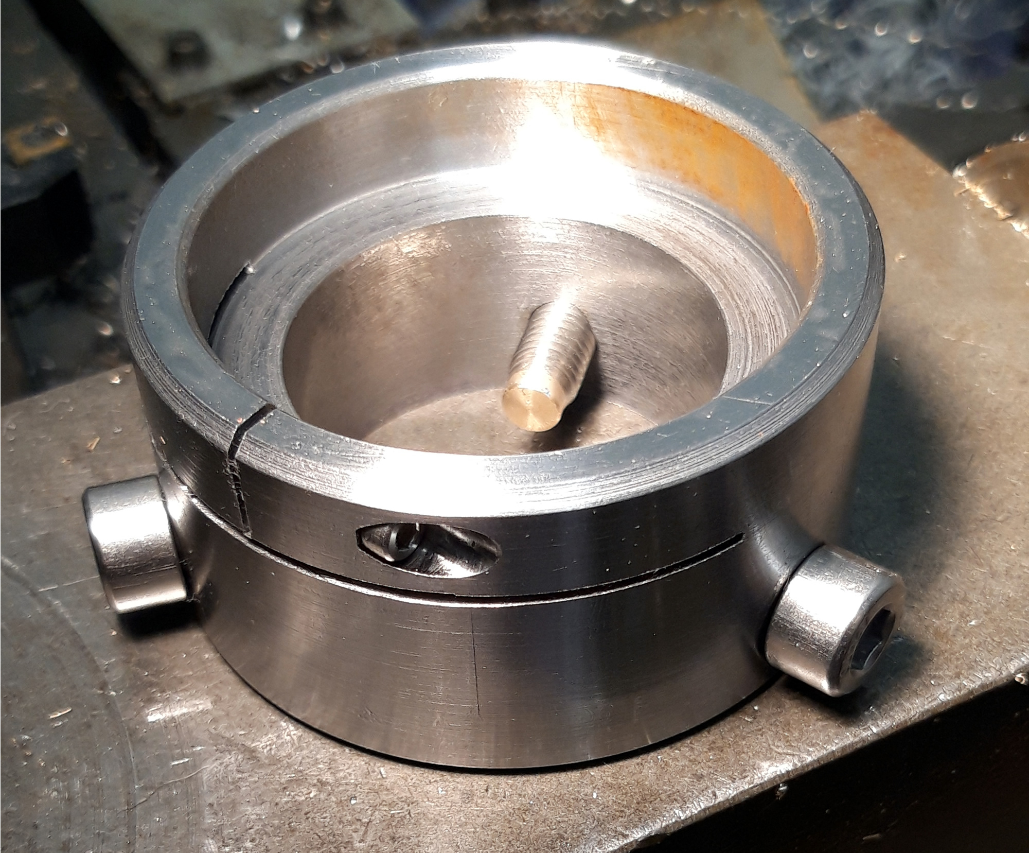

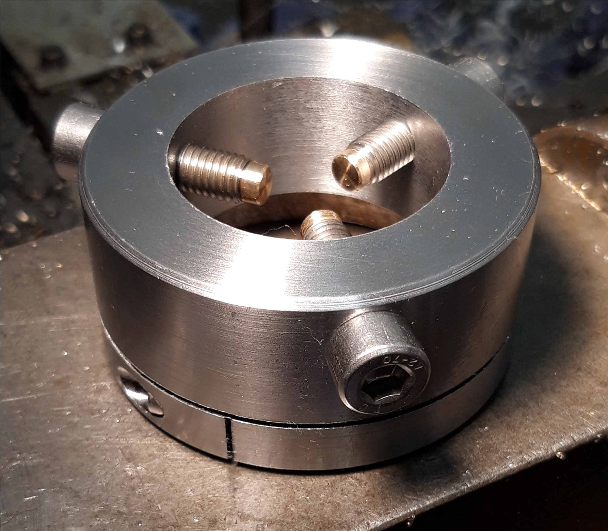

    That makes sense, it's sort of like an inside-out spider. Thanks very much. I wondered if there was a name similar to Cat's Head.
    This is the three-screw spider I made to support mostly long hex bar through the headstock. It's got more holes now, so I can use four screws or three. Much easier to align round or square stock with four screws.
    Expanding Mandrel for turning large tubes-lathe-spider2.jpg Expanding Mandrel for turning large tubes-lathe-spider4.jpg Expanding Mandrel for turning large tubes-lathe-spider6.jpg Expanding Mandrel for turning large tubes-lathe-spider5.jpg
    Now I need to bore a two-inch hole in the outside wall of the shop and fit a bearing and spider to it so I can turn REALLY long workpieces through the headstock without any danger of whip!

    I like that grub screw expansion method, my smaller mandrels use a tapered shaft and nut to open up a sawn cylinder, but the grub screw method is almost like a Taperlok fitting, very neat and easy to adjust from the end.
