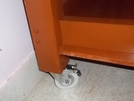

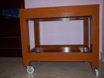

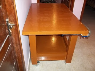

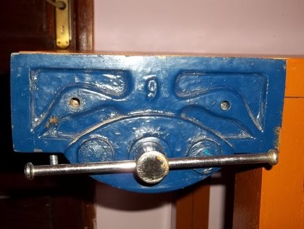

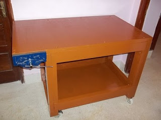

    I wish to share briefly, few details and few pictures of the Workbench, I have built recently. In fact, every woodworker, at some stage, start dreaming of building his own workbench. I was no different. Though, woodworking being my pet hobby, from my childhood and have made several things, using wood in combination with metal and glass to create lasting products for Homes.
    My table is almost similar to many such 2" X 4" solid lumber framed Benches, except that i fixed the bottom shelf to the bottom of the frame instead of placing it on top. Now the bottom shelf is in fact a 4 inch deep box of 27”X39”. I would be placing a 4 mm thin lid on this, to protect it from dust. The Bench is not yet fully complete in the sense, I am yet to bore the bench dog holes. For bench dogs, i found nice 3 inch long SS rods of 20mm dia and i would machine it flat on one end for about 5/8”.
    Bench Legs are two 2"×4" lumber joined together and all shoulder pieces and cross beams are all 2" X 4"s. The table top is 18 mm plywood doubled up to create a solid 36mm table top and shelf is also made of 18mm ply. Castors are 5” nylon wheels, two of them lockable, to provide stability. Vise is 9” steel cast. Overall dimensions of the finished Workbench, with castors, table top 27" X 48" and height is 35" and bottom shelf is 27" X 39" and table top provides 9" overhang to accommodate the vise.
    My 8020 framed MFT table top (shared separately on this Forum)i place it on top of this table, when I need the versatility of the MFT features, otherwise, my workbench is a outfeed table for my HomeMade table saw (shared separately on this Forum) and also functions as an assembly table.
