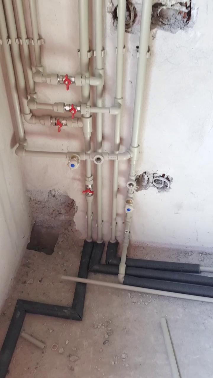

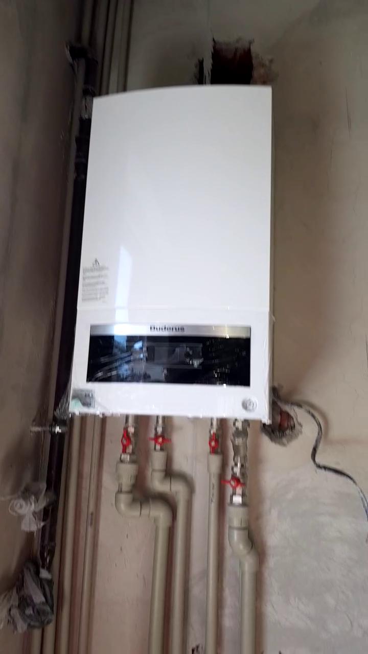

    Boiler mostly installed. The system has since been tested at pressure and heat (yesterday).

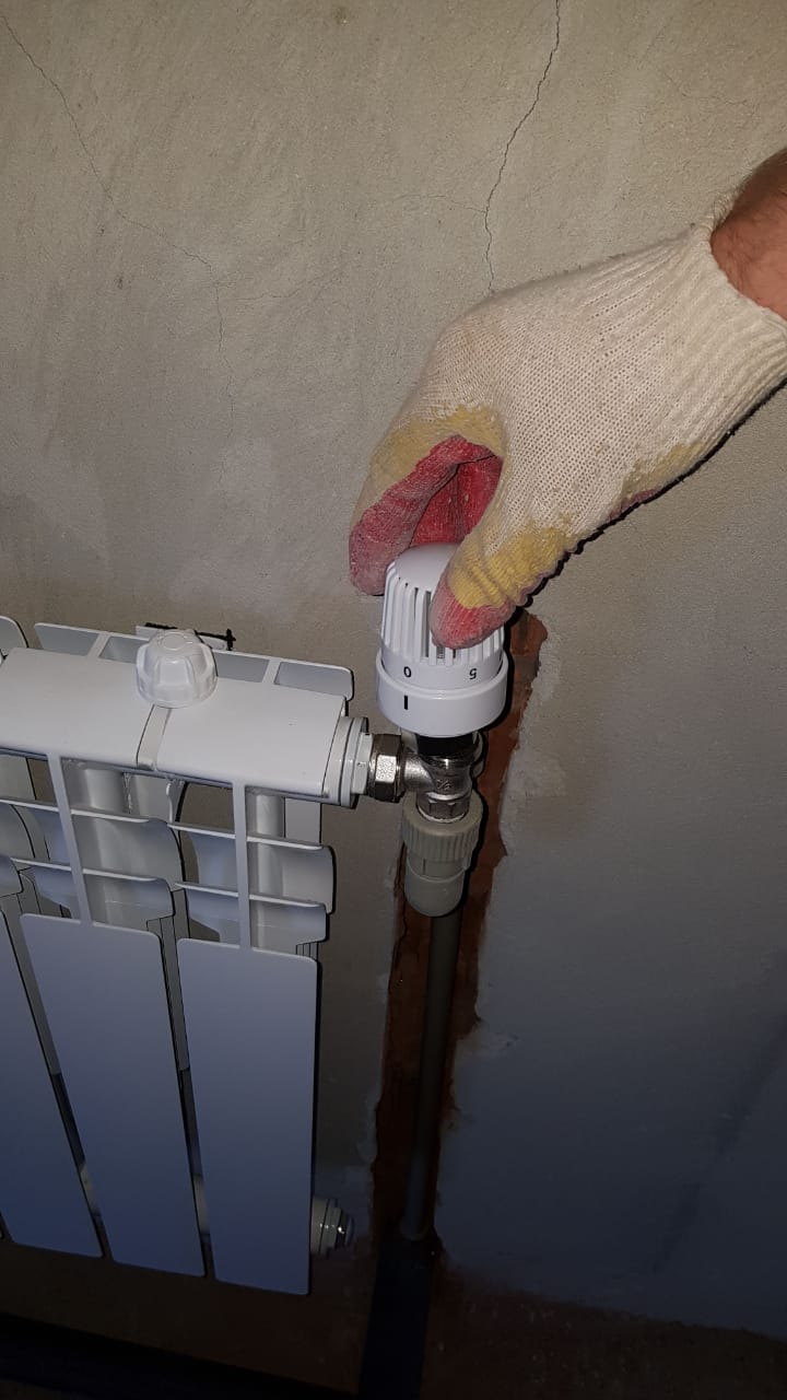

    Radiator controls
