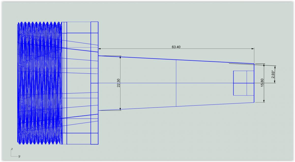

    ER40 Tool Holder for Versa mill
    It is MM Model C but it is the same as Versa.

    The master mill is made by the same folks who made the versa mill The model C and the versa Model 2 are about the same size I think. the one difference other than gear box casting shapes is the versa draw bar had male thread. you could simply cut the tang off an MT#3 then drill and thread to 1/2 20 TPI
