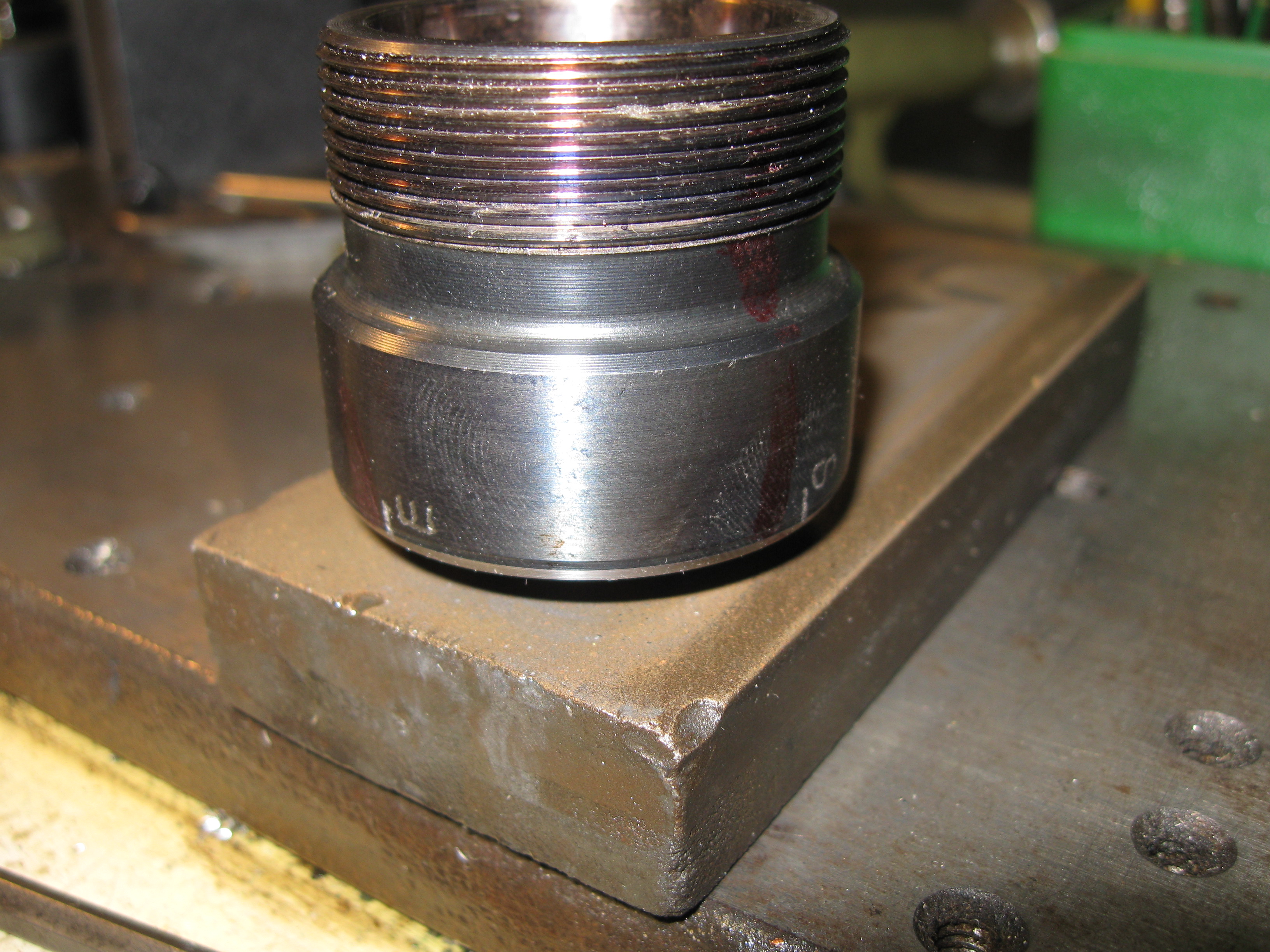

    Hello Paul:

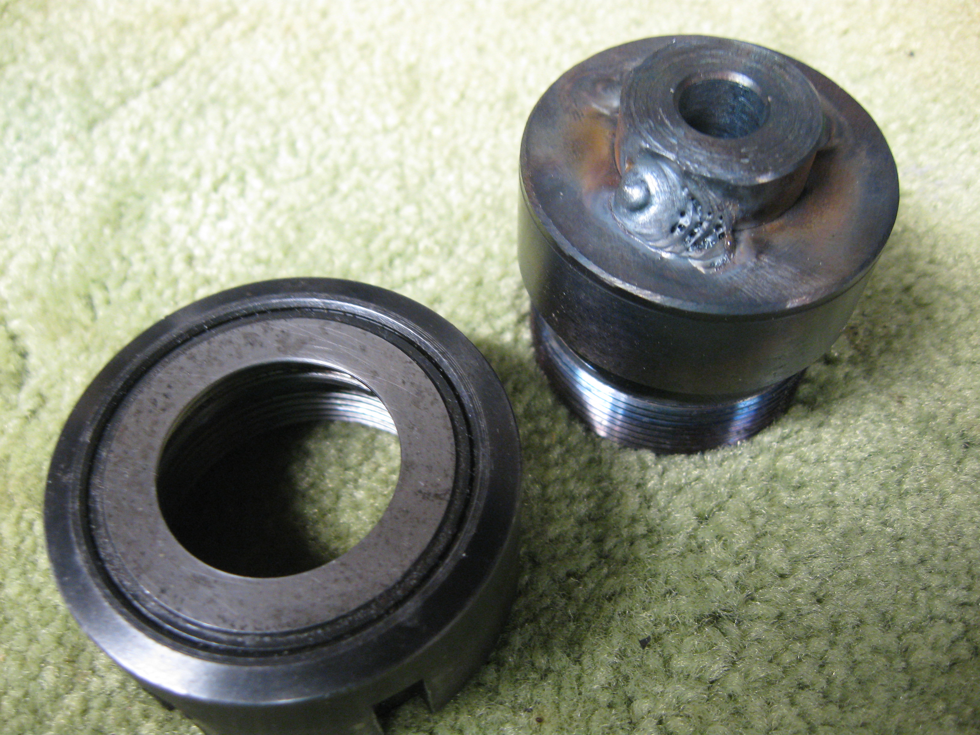

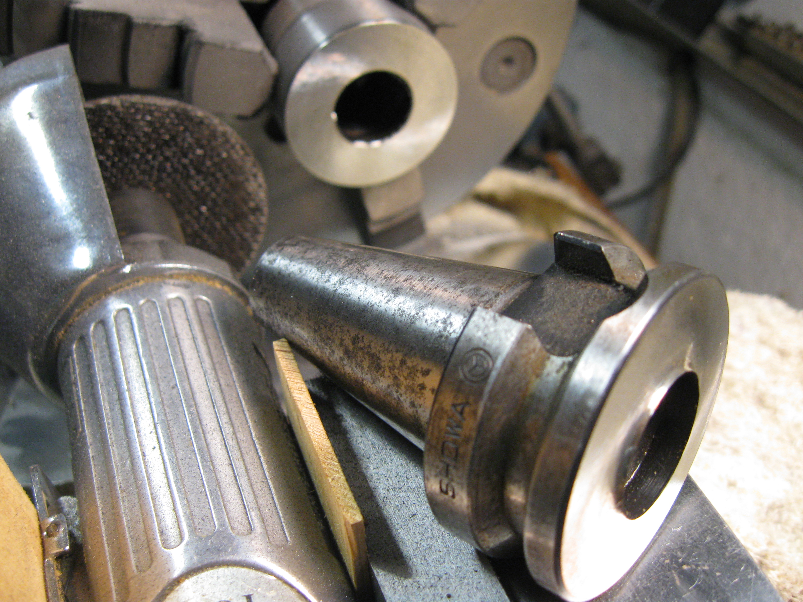

    I have a full set of ER-32 collets and decided I wanted a chuck for my Unimat too.
    So I bought a Cat40>ER-32 chuck and cut the Cat40 end off:

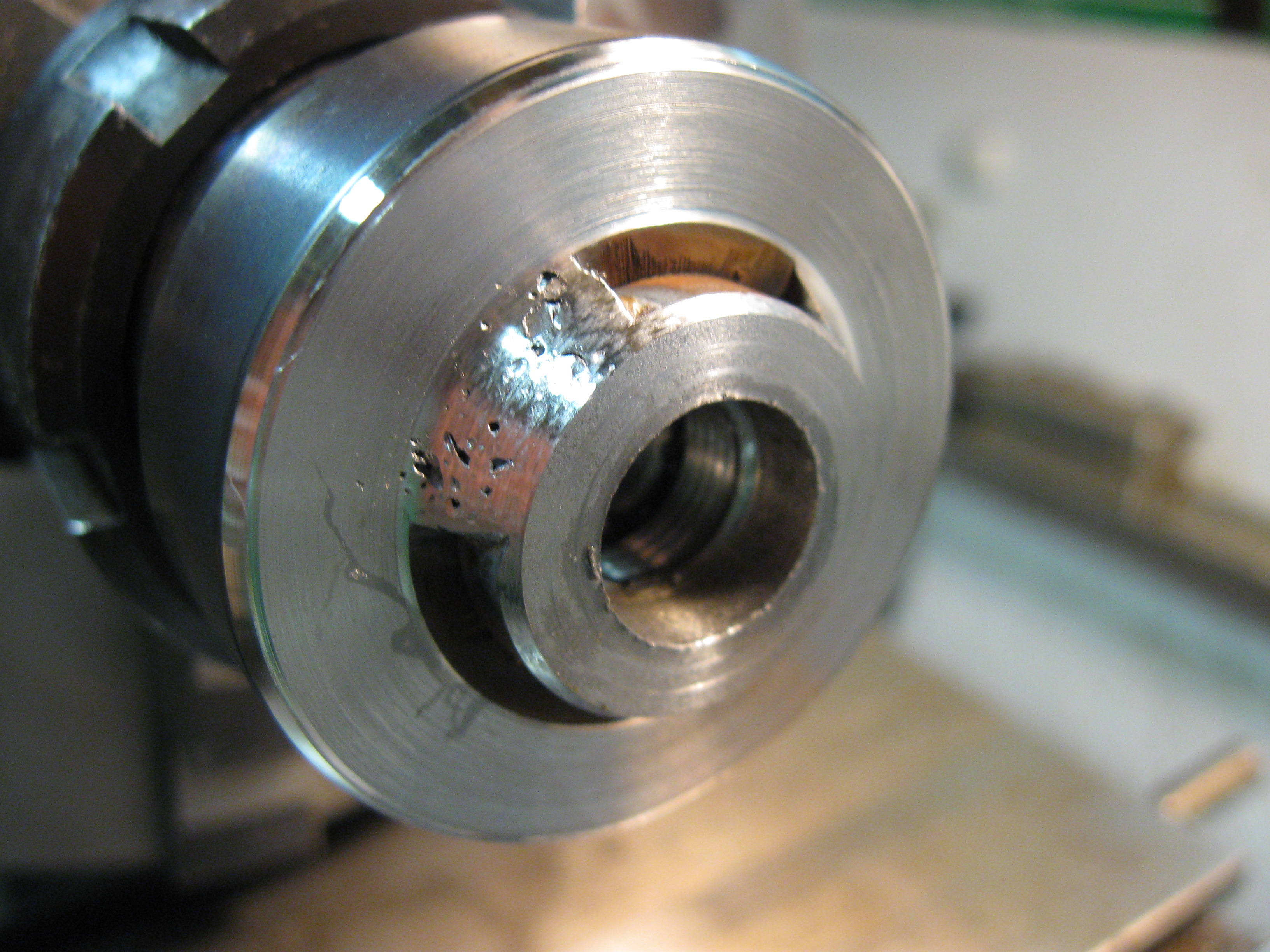

    Then I bored the back of the ER32 section for a new bushing and welded it in:
    ER16 Collet Chuck for Unimat M12X1 Spindle-img_4772.jpgER16 Collet Chuck for Unimat M12X1 Spindle-img_4781.jpg

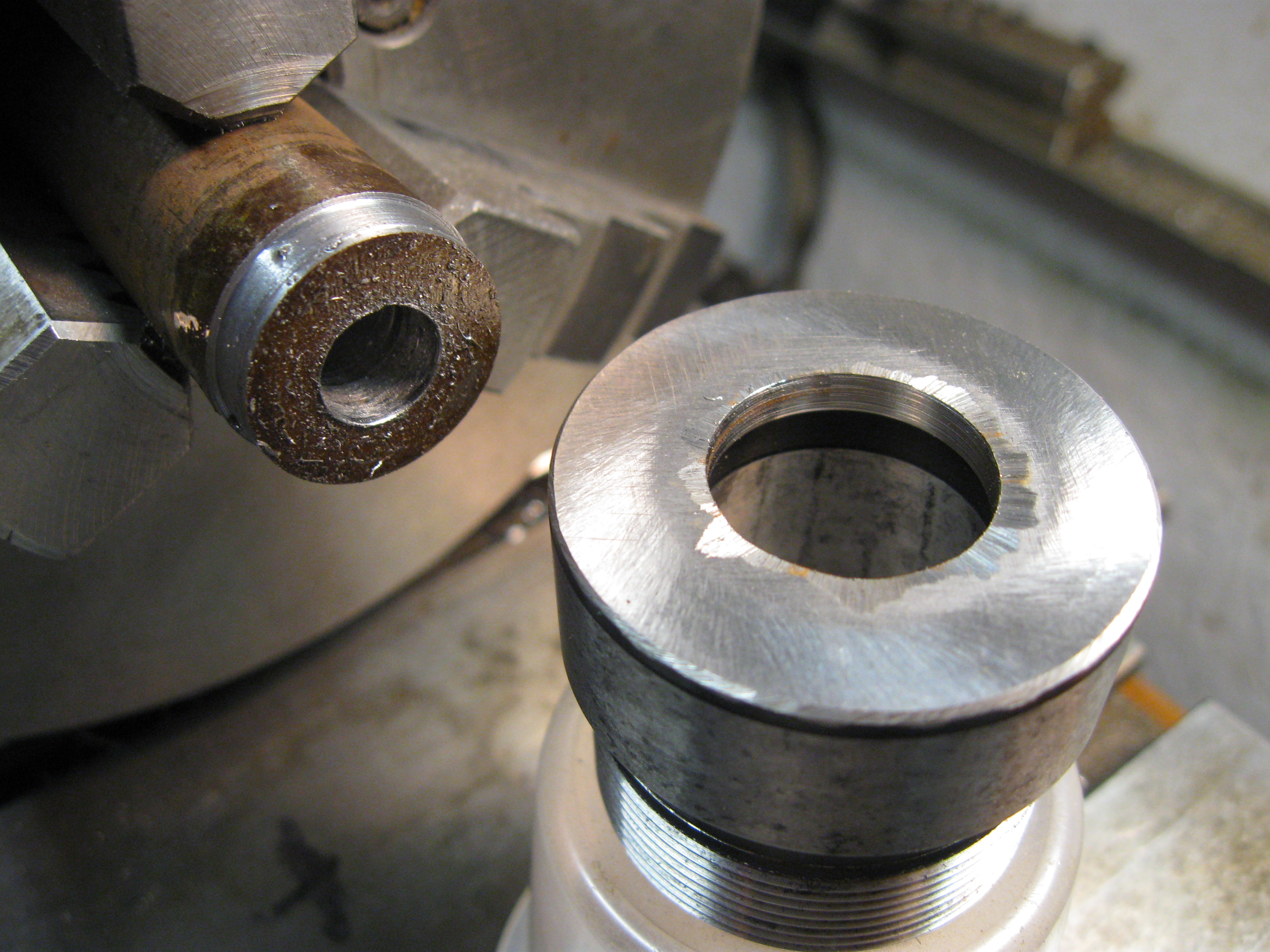

    I clamped the ER32 collet on a trued shaft in the lathe and tapped it M12x1 for the Unimat:

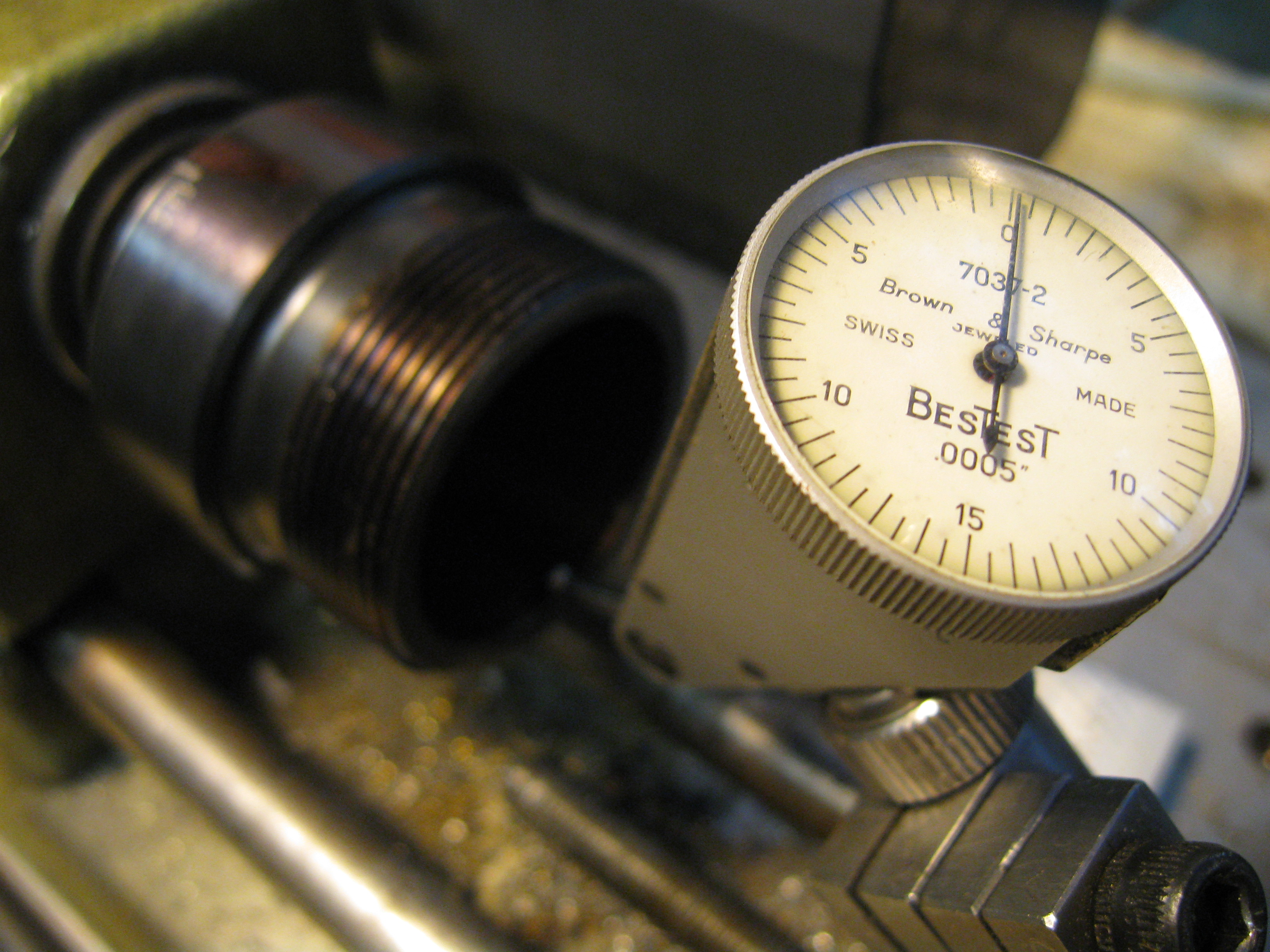

    Then with some checking and stoning I had it running true:
    ER16 Collet Chuck for Unimat M12X1 Spindle-img_4806.jpgER16 Collet Chuck for Unimat M12X1 Spindle-img_4807.jpg

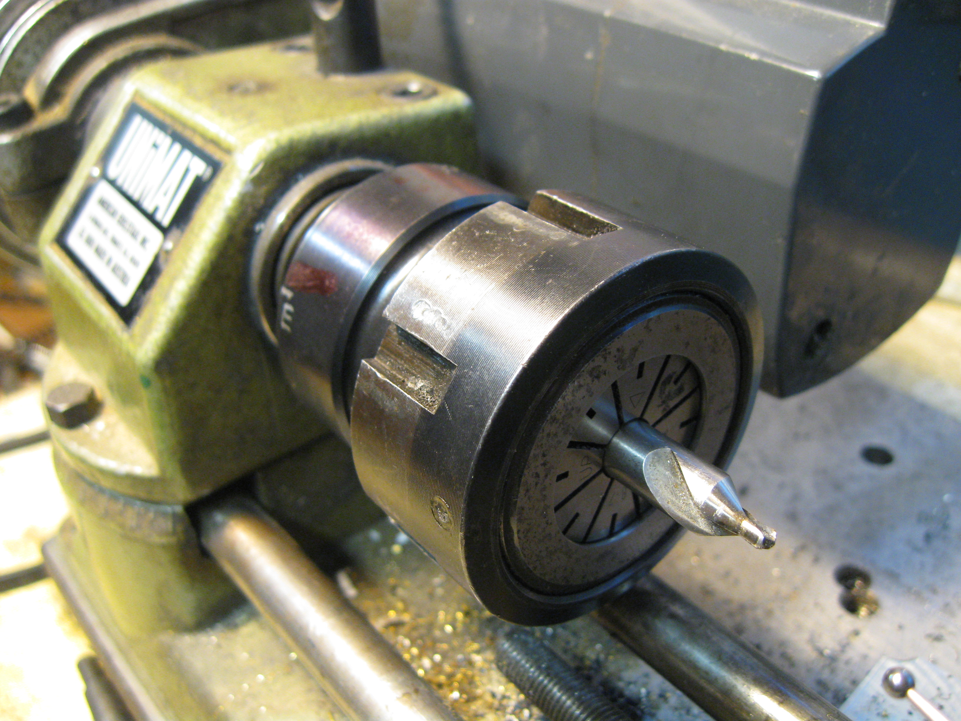

    Now it is all finished and it is great. I used it to hold wood dowels and the range -1mm really helped.
    Some said the chuck would be too large for the Unimat, but it isn't much larger than the 4 jaw chuck.
    Good luck! Carl.
