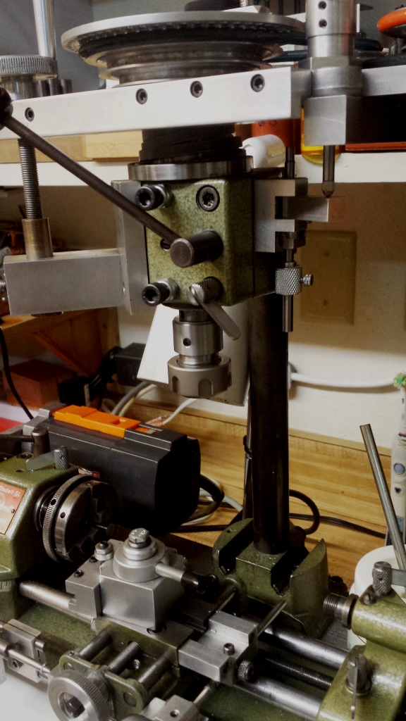

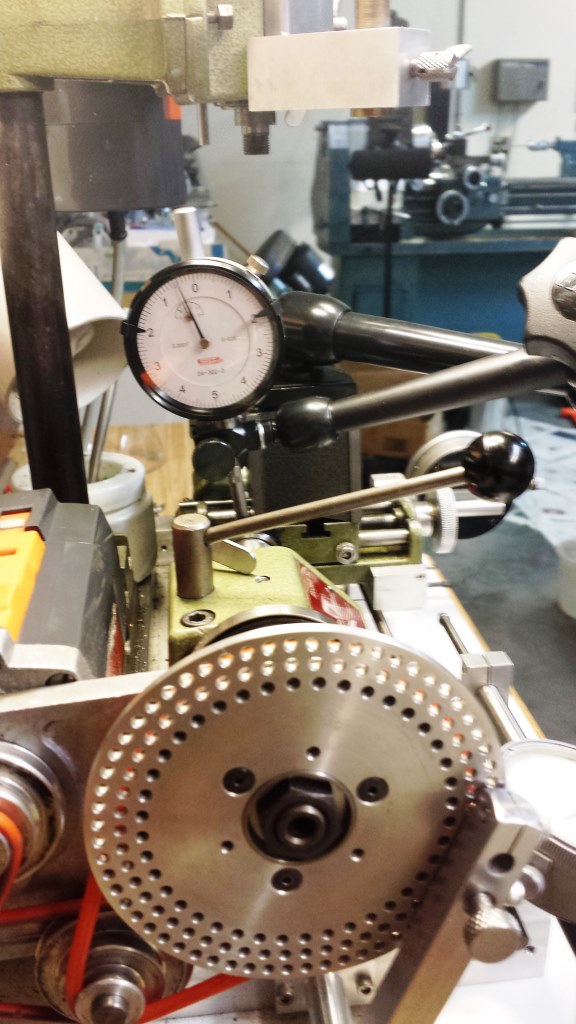

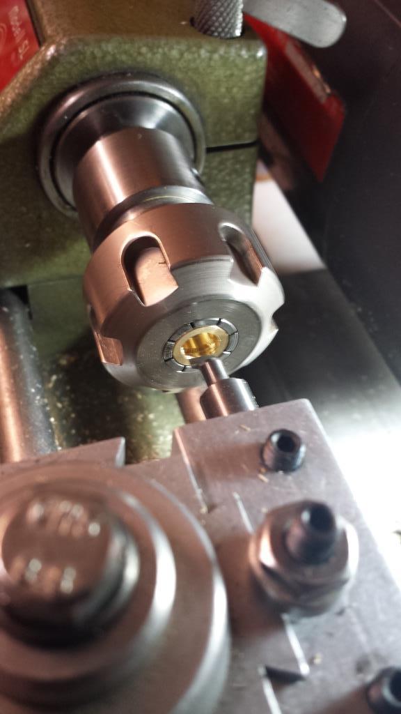

    I have been using my Unimat E16 collet chuck to hold my ER16 collets but this is not a good long term solution. I finally decided to make an ER16 collet from a 1” diameter rod of 1144 stressproof steel. Usually the Unimat 3” swing lathes use M12X1 threaded chuck adapters (chuck backplate) to ensure concentricity of the chucks to the lathe spindle. I wanted to see if I could create an accurate ER16 collet chuck without resorting to using a chuck adapter (as used for the E16 collet). The collet chuck uses a commercially available ER16 collet nut with a M22X1.5 thread. The combined collet chuck and collet has a measured 0.0004” TIR.
    ER16 Collet Chuck for Unimat M12X1 Spindle-er16-collet-chuck-shars-collet-nut-mounted-unimat-milling-head.jpg
    ER16 Collet Chuck for Unimat M12X1 Spindle-er16-collet-chuck-generic-collet-nut-mounted-unimat-lathe.jpg
    ER16 Collet Chuck for Unimat M12X1 Spindle-er16-collet-chuck-collet-measures-0.0004-tir.jpg

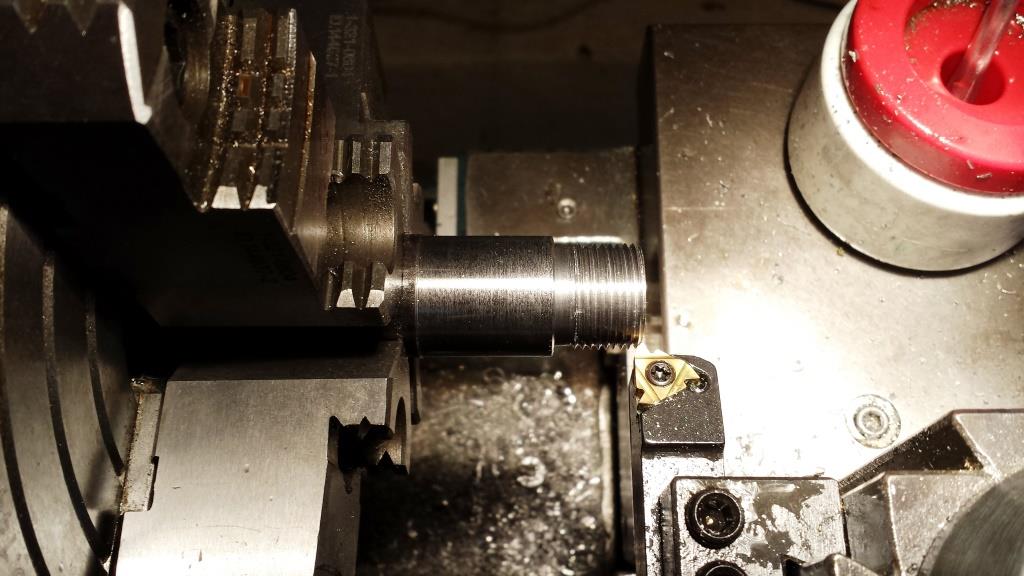

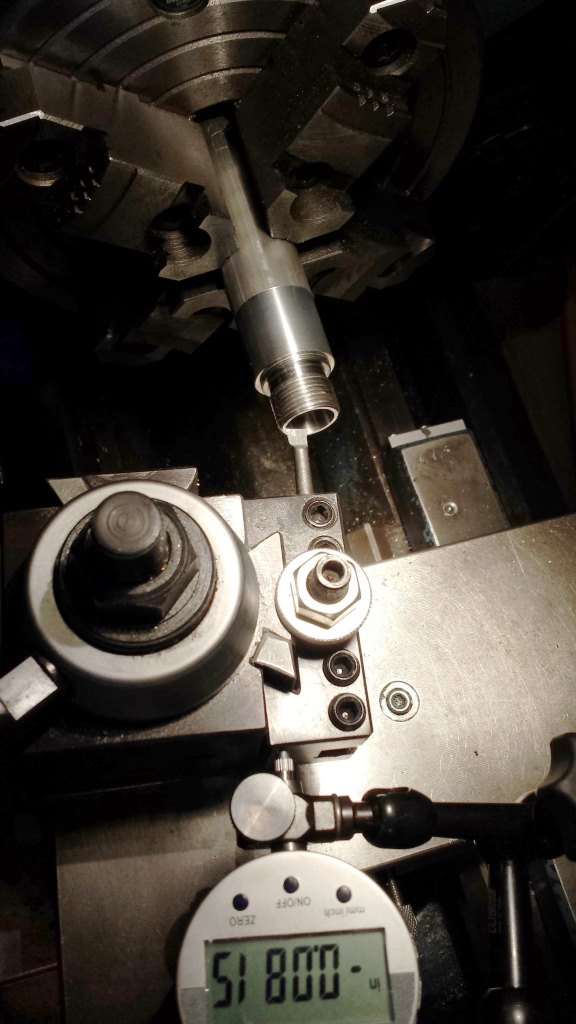

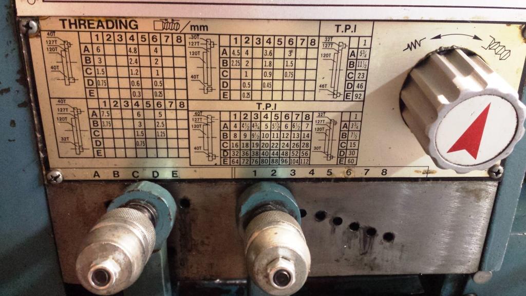

    I used the 12” swing lathe for the single point threading the M22X1.5 thread required for the collet nut. This lathe is designed to cut inch threads using a thread dial and engaging/releasing the lead screw half nut. Metric threading requires leaving the half nut engaged and reversing the lathe for each cutting pass (there are other ways to do this but this was the easiest way for the 0.700” length of thread). On the back side of the headstock, the lower 40T gear has to be reversed and adjusted to engage the 12OT gear (see the upper left hand Metric threading diagram in the lathe threading plate photo shown below).
    ER16 Collet Chuck for Unimat M12X1 Spindle-single-point-threading-m22x1.5-threads.jpg
    ER16 Collet Chuck for Unimat M12X1 Spindle-geared-head-lathe-thread-cutting-chart-set-position-c1-.jpg

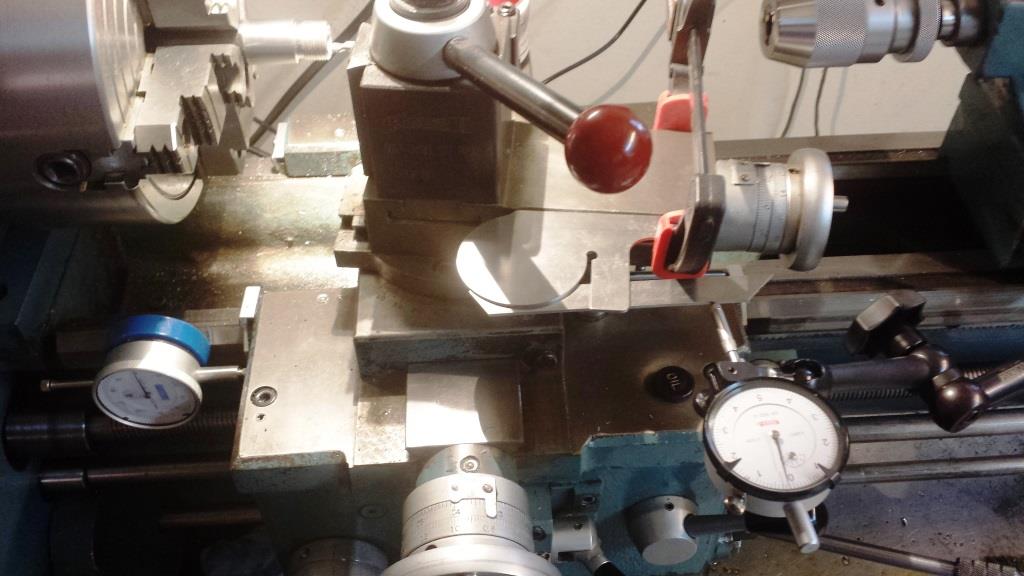

    Next I set up the lathe compound for boring an 8 degree taper required for the ER16 collets. I used a +/- 5 minute Vernier 6" precision angle protractor (made by Helios in Germany) and 0.0001” dial indicator to set the compound angle. A soft jaw adjustable clamp held the protractor and a 1-2-3 block ensure the protractor remained parallel to the lathe compound axis of cutting. An alternative would be a 5” sine bar and gage blocks for setting the 8 degree angle.
    ER16 Collet Chuck for Unimat M12X1 Spindle-setup-lathe-compound-angle-using-vernier-protractor.jpg

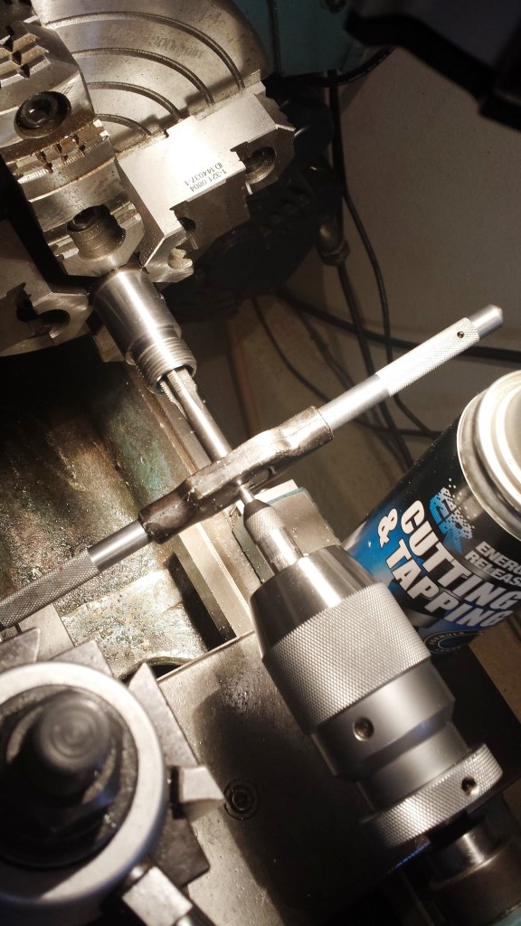

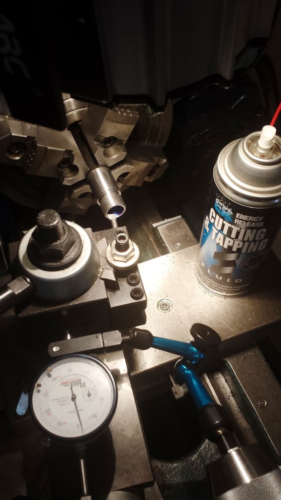

    Next the M12X1 tread for the 3” swing Unimat lathe was tapped to full depth from the open collet end to ensure the threads were very close to concentric and aligned with the collet axis. The lathe cut-off tool removed the roughed-in collet and the collet was then mounted on the Unimat lathe spindle after counterboring the threaded end to 12 mm x 4 mm deep.
    ER16 Collet Chuck for Unimat M12X1 Spindle-tapping-m12x1-thread-unimat-spindle.jpg
    At this point of the machining process the measured TIR is 0.0025” for a 0.250” gage pin mounted in the collet. That is the difficulty of machining the collet on the larger lathe because the M12X1 thread is not truly concentric with the 8 degree opening holding the ER16 collet (plus the high precision collets have a 0.0002” TIR when new and these are no longer new).

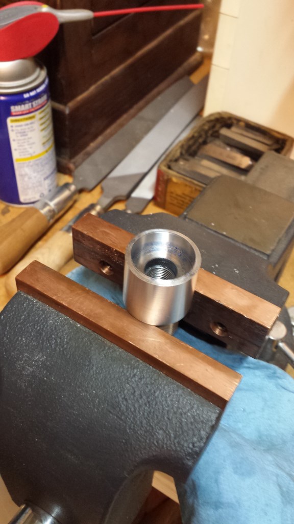

    After taking the skimming cuts, I used the lathe cutoff-tool to remove the collet with its surrounding press fit aluminum chuck “jacket”. The jacket was easily removed with a small brass hammer while holding the collet in the soft copper jaws of a bench vise.
    ER16 Collet Chuck for Unimat M12X1 Spindle-removing-er16-collet-aluminum-fixture.jpg

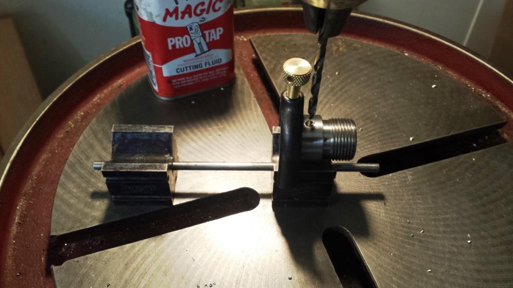

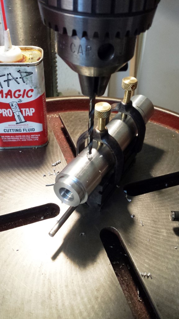

    Finally, 4mm tommy bar holes were drilled in the collet for removing the collet chuck from the Unimat spindle.
    ER16 Collet Chuck for Unimat M12X1 Spindle-drilling-tommy-bar-holes-er16-collet-chuck.jpg

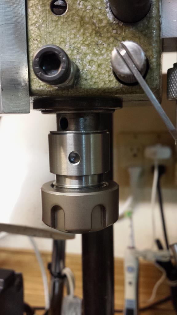

    The ER16 collet chuck is also used for milling operations on the Unimat. Below is a close-up photo of the collet chuck using a Shars ER16 collet nut. The Shars product is precisely made and not very expensive.
    ER16 Collet Chuck for Unimat M12X1 Spindle-er16-collet-chuck-installed-unimat-milling-head.jpg

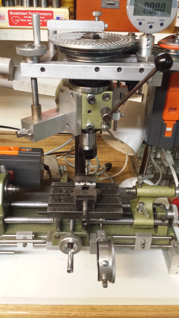

    The photo below shows the setup for milling with a 3/8" dia. four flute HSS cutter.
    ER16 Collet Chuck for Unimat M12X1 Spindle-er16-collet-chuck-holding-four-flute-milling-cutter.jpg

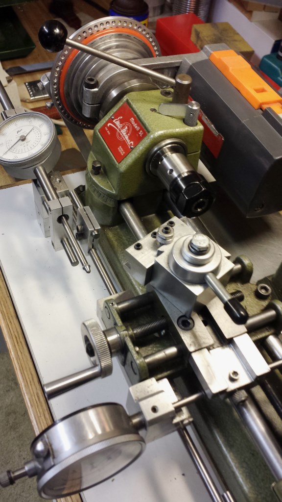

    The photo below shows the ER16 collet chuck installed on the Unimat SL1000 lathe and where it is used the most.

    Thank you for looking,
    Paul Jones

    Wow Paul! Great build and write up with a lot of complex set ups to get it done. Also Really liked the idea of holding your DI holder in the tail stock chuck...have to borrow that one! And the press on sleeve was brilliant!
    A little confused about the about the M22X1.5 metric thread and the .0700 thread distance with your lathe settings. It looked to me you had it set at 16TPI which would be .0625 and when I converted the 1.5mm it was .591 (not .0700-Typo?). So the .0625 would change the engagement by a skosh but still decent engagement. I didn't calculated the percentage because it really doesn't matter based on your Amazing 4 tenths TIR with the collet and tolerance stack. WoW!
    I recently tried to cut a 25tpi thread (measured .040+, definitely not 1mm) on my peanut using the same continual engagement of the half nuts. With the gears I have I was able to get 24.93506 TPI. It came out close enough in pitch but was too unstable to turn between centers like I needed to...got to get a collet set! Inspired now!

    Thank you for the compliments but in this case I think I may have been luckier than smart in achieving the 0.0004" TIR. Next time, I plan to cut the 8 degree collet taper directly on the Unimat. The Unimat headstock swivels for the purpose of cutting tapers. Ironically, I was trying to avoid realigning the Unimat headstock because two years ago it took me several hours to perfectly align the headstock within in 0.0002" over 5". Next time I am only using the 12" geared-head lathe to single point thread the M22X1.5 OD thread and do the rest of the work on the Unimat. The M22X1.5 thread is the standard thread of ER16 collet nuts where the thread diameter is 22mm and the thread pitch is 1.5mm. All the various ER series of collet chucks have a specified thread.
    I added a better photo of the lathe thread selection chart. I was using the quick change gear selections shown in the upper left-hand panel (there are six panels of selections depending on the change gear setup used for the lathe headstock). When using the metric selections in the upper left hand panel, it shows the lower 40T gear is reversed on its drive shaft so it is being driven by the 120T gear which in turn is driven by the 127T gear (25.4mm = 1", and 127T gears work perfectly for metric conversions because 25.4 X 5 = 127, which is the closest whole number for gearing purposes (a millimeter is exactly equal to 5⁄127 inch)). When cutting most of the inch threads, the upper and lower 40T gears directly engage the 127T gear which becomes an idler gear (see my other posting at Homemade Change Gears details on the gear settings and much clearer photo of the quick change gear selection plate).
    The 0.700" distance is from the open end of the collet to the shoulder of the thread relief groove. My 12" swing lathe does not have a brake so when cutting metric threads with the half nut engaged and never released, I have to be very fast with my left hand backing out the cross slide while using my right hand on the on-off-reverse lever to turn off the motor. The lathe carriage keeps coasting to a slow stop so the cutting tool has to be completely clear of the thread relief shoulder or it will crash (nooo!).

    Thanks for the great explanation Paul. I get it now. The better picture gave the detail of the pitch and gear setup. Didn't realize the .700 was the length of thread and obviously added the "0" before the 7...my bad. That's some tedious stop action on multiple passes...Hats off to you!! Luck or not a Great Build!

    I like your suggestion about the fine thread push/pull jig for the Unimat headstock. I made something like that for my 7" swing lathe tailstock adjustment and posted it on HomemadeTools. I think I could adapt something like that for the Unimat. That is great idea!
    I have been using "Unimatt Buddy Pin" (yes two Ts) for my general headstock alignments for many years and I highly recommend it for those using the Unimat SL 1000. It is fast and can get the alignment extremely close for most work. I use a ground test bar (remove the tailstock) and a 0.0001" dial indicator when I want the alignment close to perfect.
    Earlier this week I reviewed again the YouTube video by Tom Lipton where he shows how he aligned the lathe headstock after leveling the whole lathe. Tom uses an aluminum rod held in the chuck and with sufficient diameter so I doesn't flex due to its own weight. Tom removes material from most of the center length so just short sections on the two ends are left for making test cuts. Comparing the ODs at both ends measures the headstock alignment and how much to adjust.

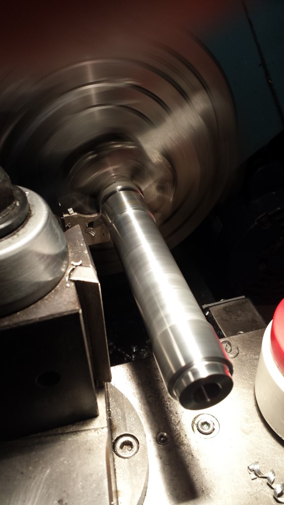

    Yesterday I made a similar 6061-T6 aluminum test bar but only 1.125" in dia. and 5.25" long for the Unimat. It has an M12X1 internal thread to mount directly on the Unimat spindle (but could modified for holding in the chuck). I made the test bar with my 12" swing lathe and decided to check this lathe before I cut-off the part for use on the Unimat. I used a Mitutoyo 1" to 2" digital micrometer to make the measurements over a 5" center-to-center distance. I used a blue Sharpie to blue the surface, machined off a few tenths, and measured several times, after waiting for the part to cool (and turned of the halogen work light). Each time the difference measured at either 0.00010" or 0.00015" but I was using a carbide tool and probably should have used a honed HSS tool (and perhaps a 2" bar of aluminum). The 12" swing lathe was re-leveled a couple months ago and I am calling the 12" lathe alignment test good enough.
    I plan on posting in Homemadetools my Unimat alignment work but here are two photos from my work yesterday. The first photo is machining the test bar just before cut-off (and I forgot machine a 12mm x 4 mm deep counterbore in the spindle threaded end and had but back in the 4-jaw chuck, indicate again to a few tenths (more like chasing back and forth a few tenths))
    ER16 Collet Chuck for Unimat M12X1 Spindle-machining-unimat-sl-headstock-alignment-test-bar.jpg
    This is the Unimat aluminum test bar ready for mounting on the Unimat headstock where I will be taking a few test cuts to check headstock alignment.
    ER16 Collet Chuck for Unimat M12X1 Spindle-drilling-4mm-tommy-bar-holes-unimat-test-bar.jpg
