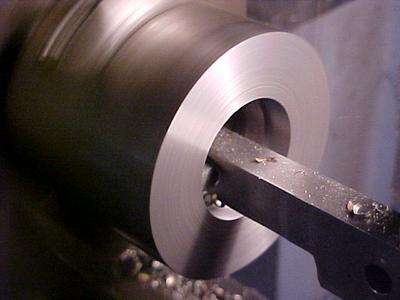

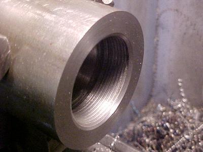

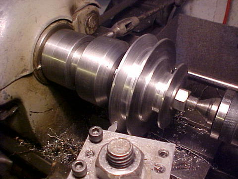

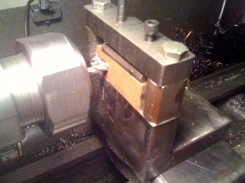

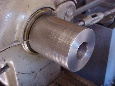

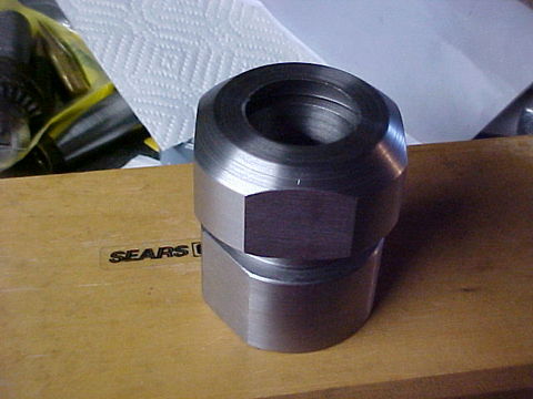

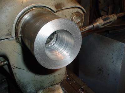

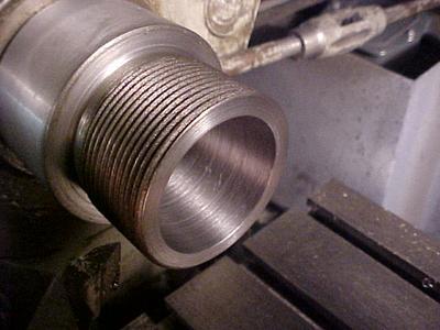

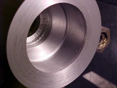

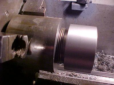

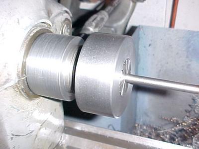

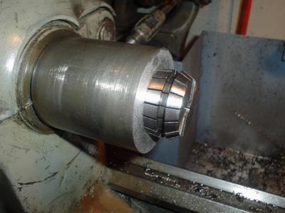

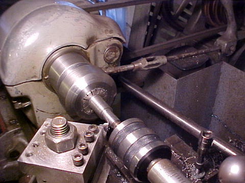

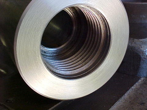

    Here is my ER-40 collet chuck i made for my SB 10K lathe. Its just a scrapbox steel bar threaded to fit the spindle and then the other end is threaded for a nut to hold the collet. The inside is taper turned to the collet angles as well as the inside of the nut end. I don't have plans just lots of building pics. I have lots of room so if the inside ever wears out i can recut the taper and freshen it up. Been using it for about 6 years with zero problems. The factory ER nuts have a ring to pop the collet free from the body as they do get tight gripping the part. I use an aluminum knocker bar thru my spindle to bump it free. Any ???? just ask...Bob
    Attached Thumbnails Attached Thumbnails ER-40 collet chuck for metal lathe.-5-threading-body-nose-cap.jpg   ER-40 collet chuck for metal lathe.-4-trying-collet.jpg   ER-40 collet chuck for metal lathe.-3-inside-taper-cut.jpg   ER-40 collet chuck for metal lathe.-2-chuck-body-threaded-spindle.jpg   ER-40 collet chuck for metal lathe.-1-chuck-body.jpg

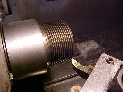

    Here are some more pics...Bob
    Attached Thumbnails Attached Thumbnails ER-40 collet chuck for metal lathe.-6-threaded-body-taper.jpg   ER-40 collet chuck for metal lathe.-7-boring-nose-hole-threading.jpg   ER-40 collet chuck for metal lathe.-8-nose-taper-cut-hole-bored.jpg   ER-40 collet chuck for metal lathe.-9-nose-threaded.jpg   ER-40 collet chuck for metal lathe.-10-collet-body-screwed-inside-nose.jpg

    Some more...Bob
