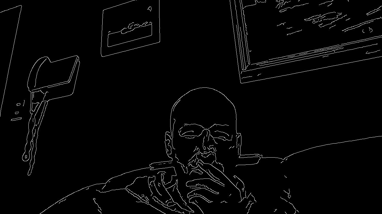

    This is neat, but the nuts and bolts are actually not that complicated. It's just a small computer running OpenCV and applying a Canny filter to the image. It's a great application for the technology, but the underlying technology is pretty old. I've used Canny filters in computer vision projects a number of times. If you want to replicate this on your own computer, the following Python code will perform a live Canny filter from your webcam:
    import cv2
    def canny_webcam():
    cap = cv2.VideoCapture(0)
    while True:
    ret, frame = cap.read()
    frame = cv2.GaussianBlur(frame, (7, 7), 2)
    frame = cv2.cvtColor(frame, cv2.COLOR_BGR2GRAY)
    edge = cv2.Canny(frame, 20, 50)
    cv2.imshow('Canny Edge', edge)
    if cv2.waitKey(20) == ord('q'):
    break
    canny_webcam()
