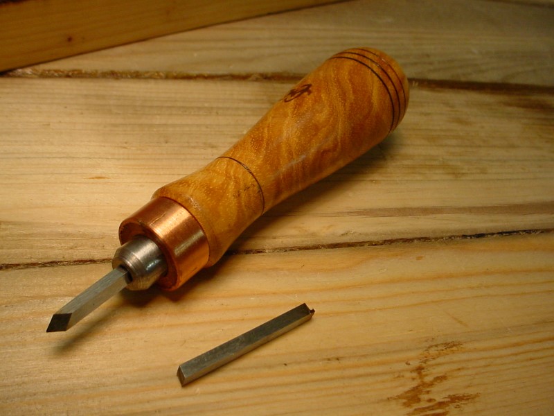

    This is a little engraving tool, with a lozenge point.
    It is made with a piece of square section HSS 3x3mm. It is inserted in a round section of mild steel (to avoid it engaging into the wood).
    Cheers !
    Christophe

    Thanks guys,
    It is a repurposed handle, I would have preferred a mushroom shape,
    next time ...
    This is curly ash, oiled, it's really good looking and nice for tool handles.
