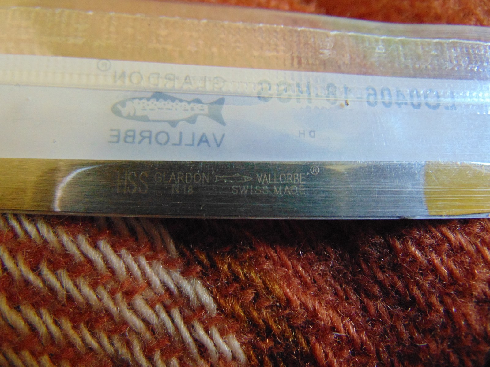

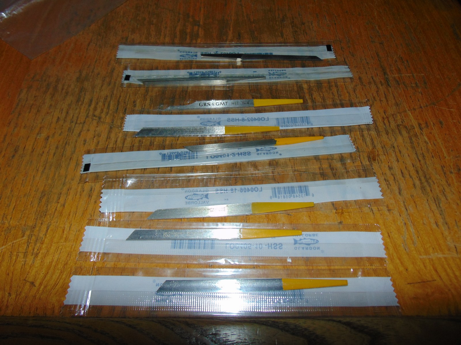

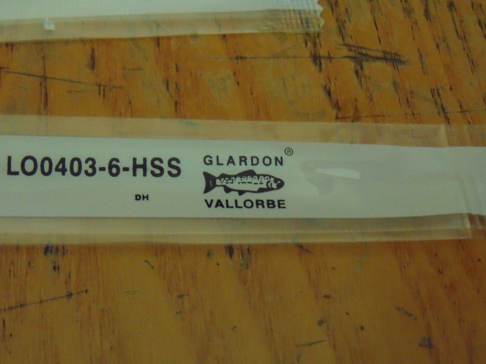

    Hi all!
    I just received the pack with the engravers. Different profiles, HSS material, a second pack with diamond wheels will arrive soon.
    I'm thinking for the future to buy (or build) a pneumatic engraver, for now I would like to start the classic way with hammer.
    I would ask you kindly, if someone has experience in engraving, which kind of holder and chasing hammer are good.
    For the holder I saw the common wooden short mushroom handle, or a long stick (12\15cm lenght), I remember someone used golf balls also, like file.
    Talking about chasing hammers, do you think a stainless or normal steel not hardened should be fine for the work? I noticed the hammers are from 30 to 40 gram (1- 1,5 oz). I saw even something in brass, Maybe could be a right choice? One face round ball and the other flat but round (I don't remember the eng name of curved surface).
    I have to think a good way also for a vice, I found some interesting project here!
    Any advice welcome Thanks!

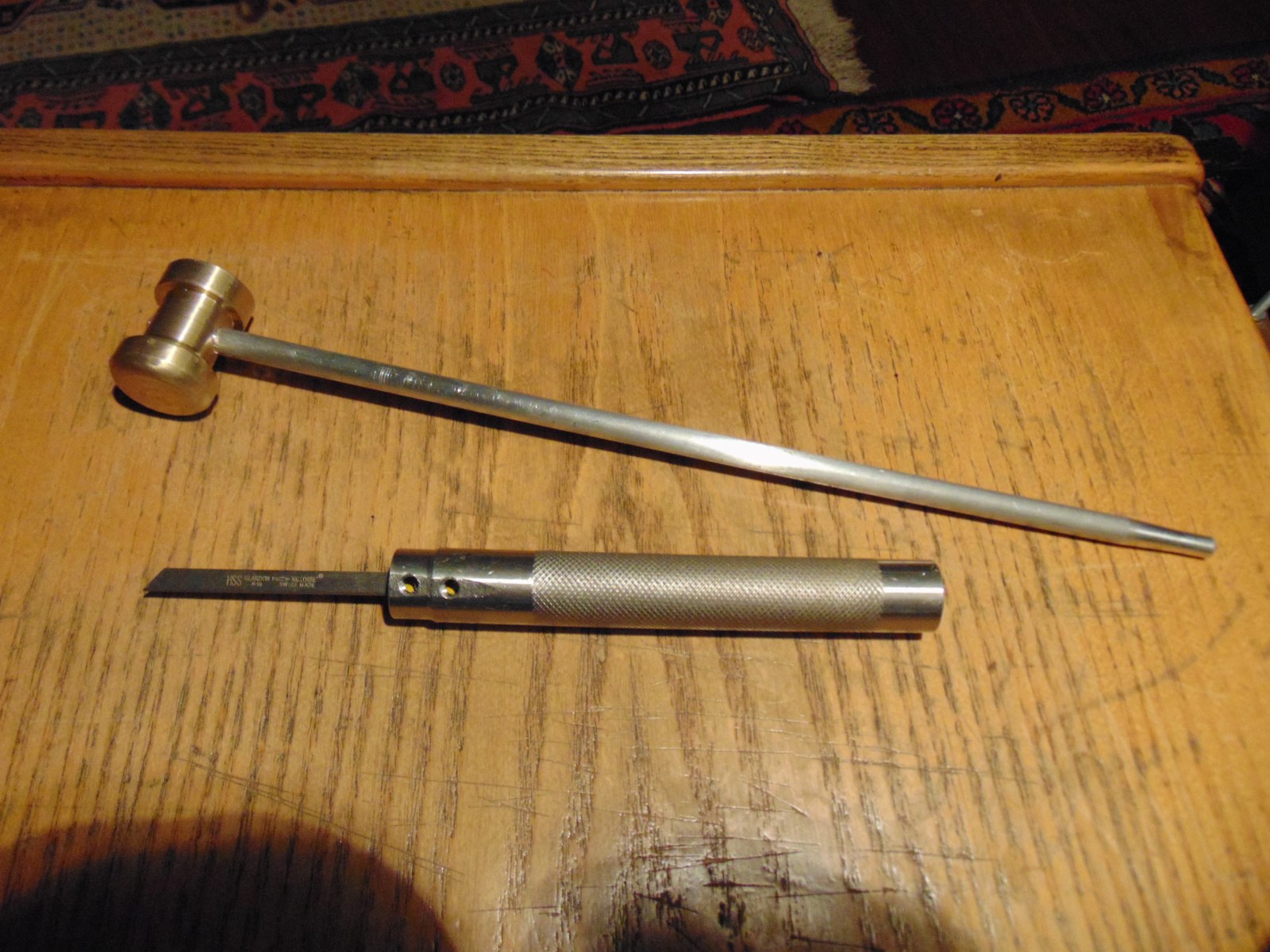

    Question for you: brass could be a good material for an hammer (with burin) or should I use steel or something able to take tempering? I suppose the use of hammer is related to light and fast, instead of slow and powerful strokes.

    Yes , right, that's not a hammer for blacksmithing, and personally, as my tools are for myself, I don't bother with hardenning, if they got worn (and so far they don't), I'd simply rebuild them, that's not a big deal.
    One of my Craftsman and Artist Guru Youtuber is Uri Tuchman, look at this video for instance :
    He also uses a lightweight aluminum head hammer.

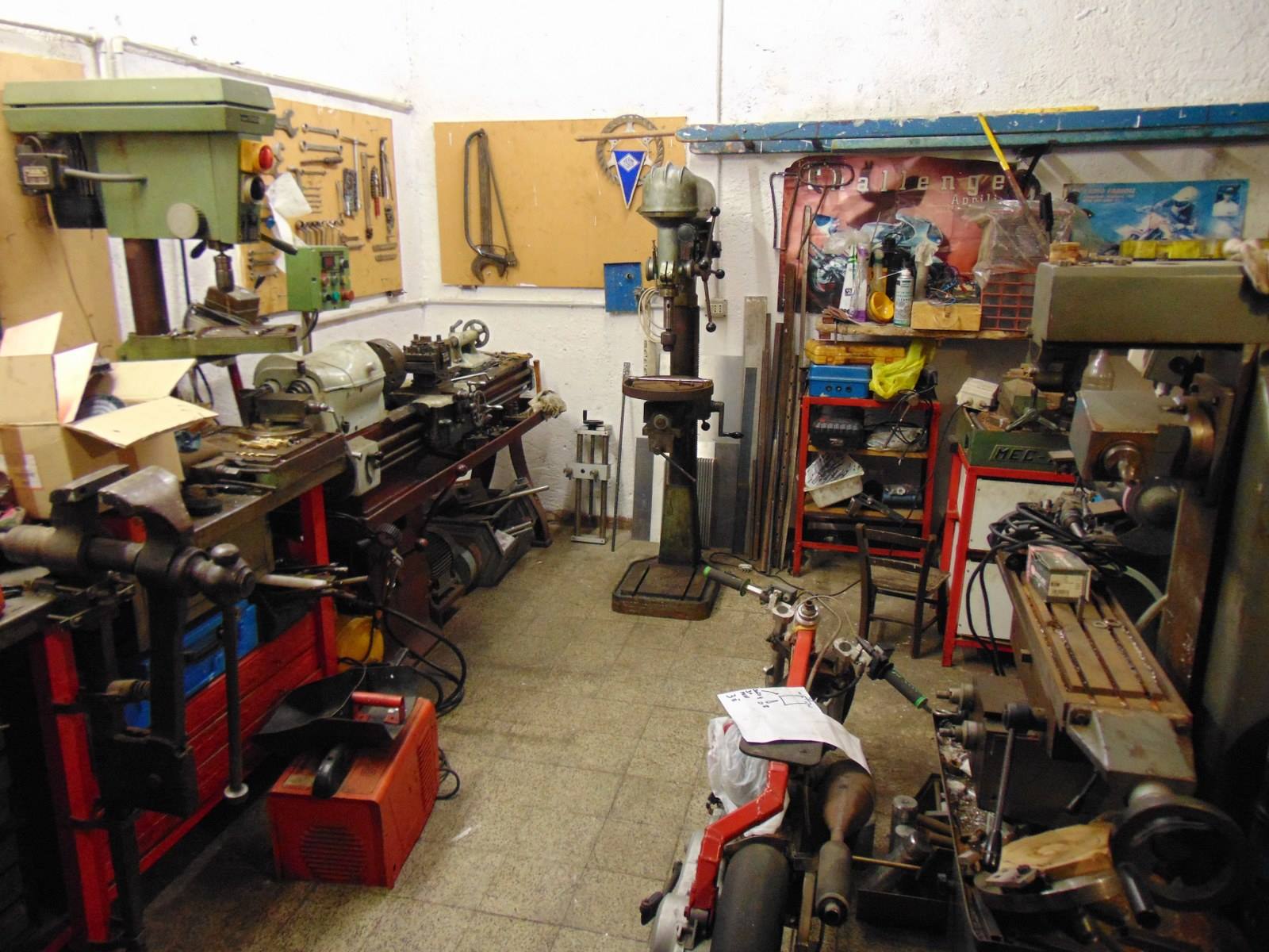

    I can't call myself a machinist, but a good DIYer, I have a little garage with some good old tools and the desire of use them
    list of things to do:
    - learn about drawing, angles and way to keep sharp the blades-
    - build the body of burin, a chasing light hammer
    Need also to find parts for a bowl vise, I saw the one you built, it's wonderful!
    I will study the video about the pneumatic engraver, it seems not impossible to build at first sight.
    Talking about Hss rod, as usual, here it's quite hard to find, normal specialized shop has only basic tools, if you're lucky enough you can find some big square bar for lathe, 100% old unsold. Since it's the first time for me, I decided to buy ready to use gravers this time, but for the future I will try sharpening a rod.
    I am also happy to see your works!
    That's my little garage

    Just tried to build an hammer and an handle from scraps I had.
    I decided for brass because I needed a soft little hammer for lathe centering and other "light" works in the garage.
    The handle is very thin, the control seems quite good (as normal hammer), I don't know if it will be good for engraving. In case, I will modify
