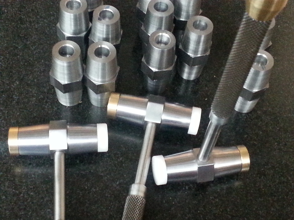

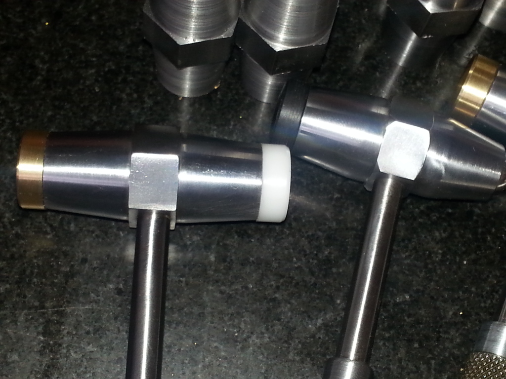

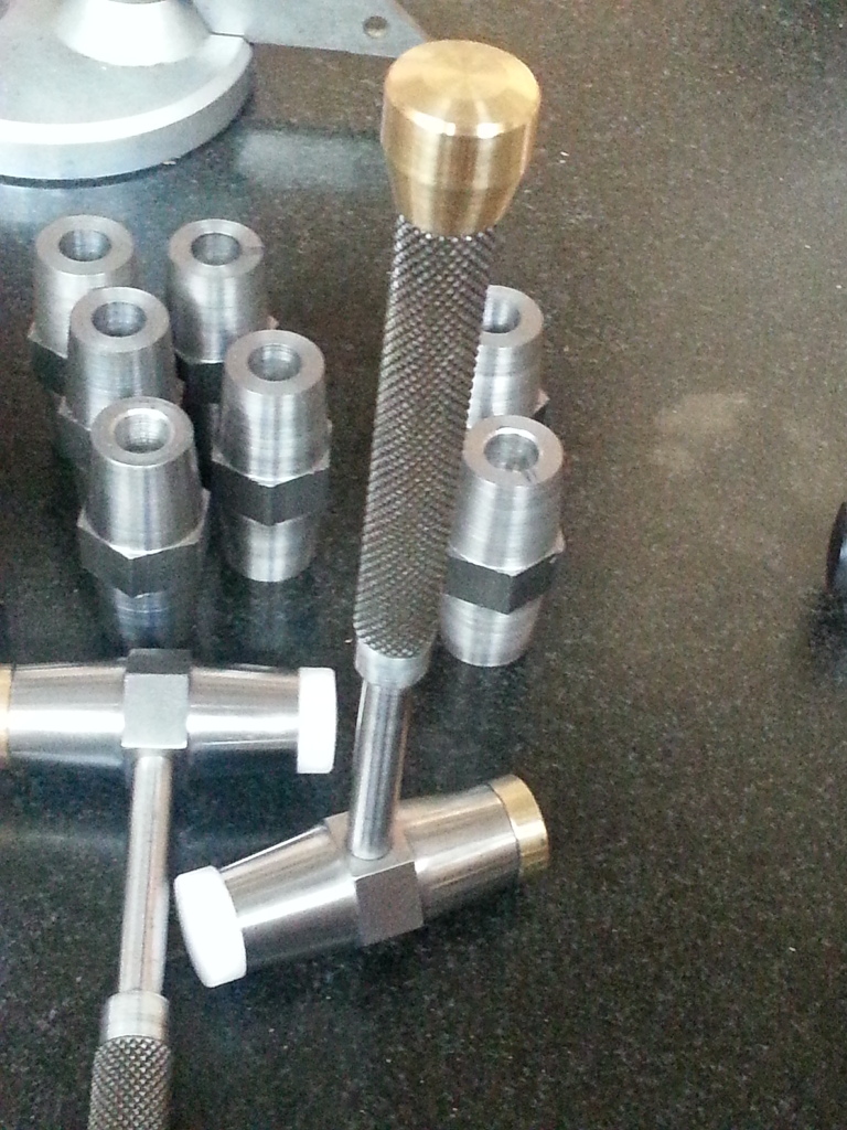

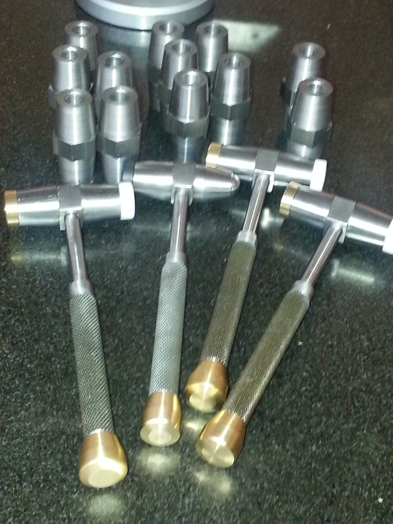

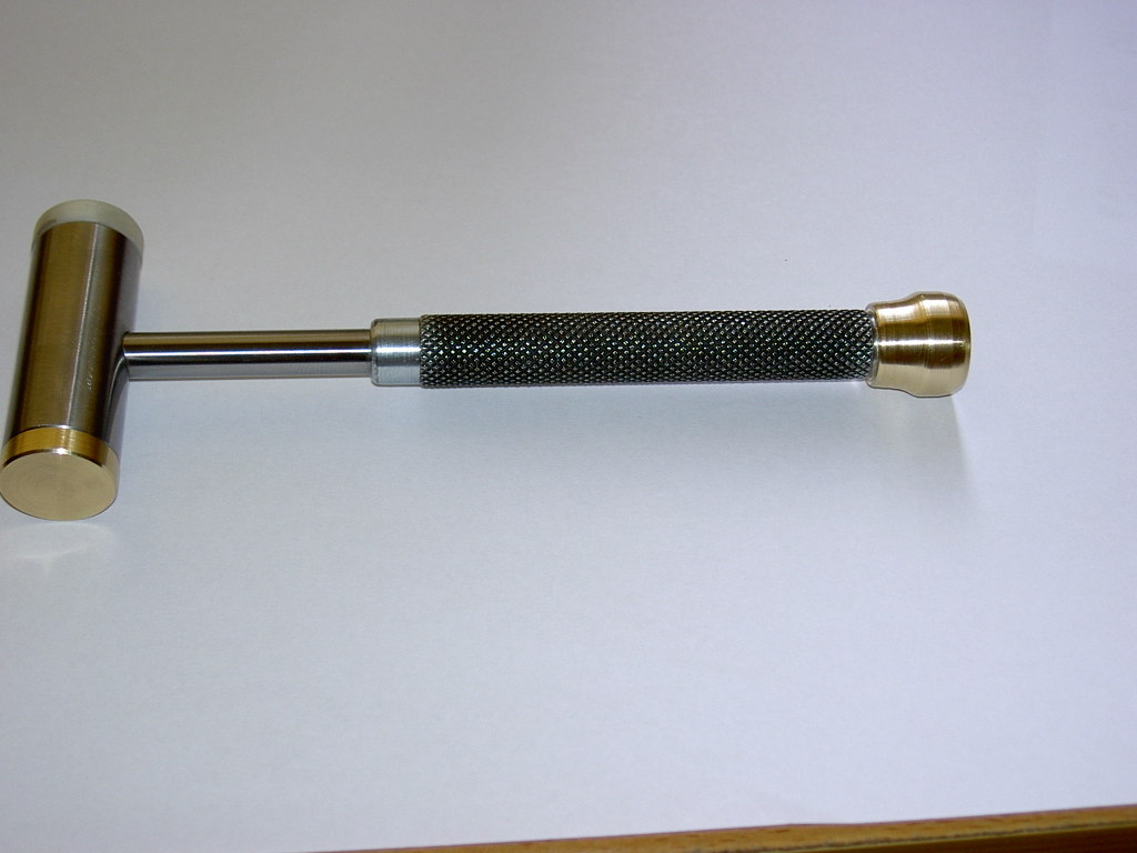

    Engineers hammer- type small
    I saw Rossbotic's nice brass hammer so I thought folks would like to see hammers I make using knurled pin punches for the handles. I use hex bar for the heads which are drilled to take replaceable ends which can be of brass, aloominoom ( wood or some sort of nylon/plastic stuff.... The pin punches are of course hard at the ends so I used my mini tool post grinder to grind a slight taper then used a hydraulic press to squeeze them together-seems to be a permanent marriage as the two I kept for myself show no signs of losing their heads. One has a ball bearing in one end- nice for dimpling etc.
    The first picture shows the first one made then I pimped them up a bit.
    I give them to customers (sometimes)...

    Beauties and a novel idea using pin punches! I like the one with the ball bearing. Is that pressed in also?

    Quote Originally Posted by bobs409 View Post
    They are nice. Almost too nice to hit against things.
    You would be surprised at the range of things "plinked" with this hammer: from draw bars to fine saw adjustments .... I think having replaceable ends is a commendable feature.
