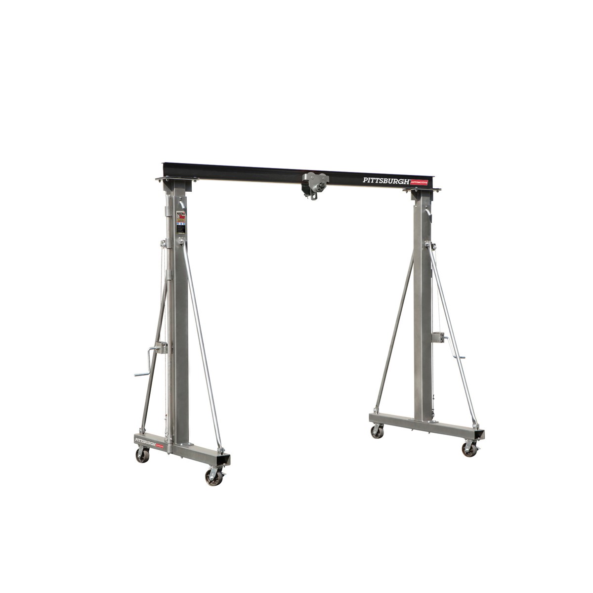

    1 Ton Engine Hoist $729 from harbor freight. You can't build it for that.
    1 ton Capacity Telescoping Gantry Crane

    Two words in the OP's post stand out the first is span the 2nd is center. To me this says he is either wanting to permanently fix a 2x4 tube beam or he is wanting to build a gantry style like shown in post #5
    Had he said words like reach end or tip this would have meant to me he was thinking about those described in posts #4 & 6
    JoBotha I'm afraid you may have dropped a zero. At any rate if one were to either construct a lifting device with either a 10 ft beam length fixed on both ends or one with a 6 ft total reach assuming it was supported on 1 end and the lifting point was at 5 ft, the total stress on the end would be close to double that of a gantry style where a 10 ft beam were used having the load centered on it
