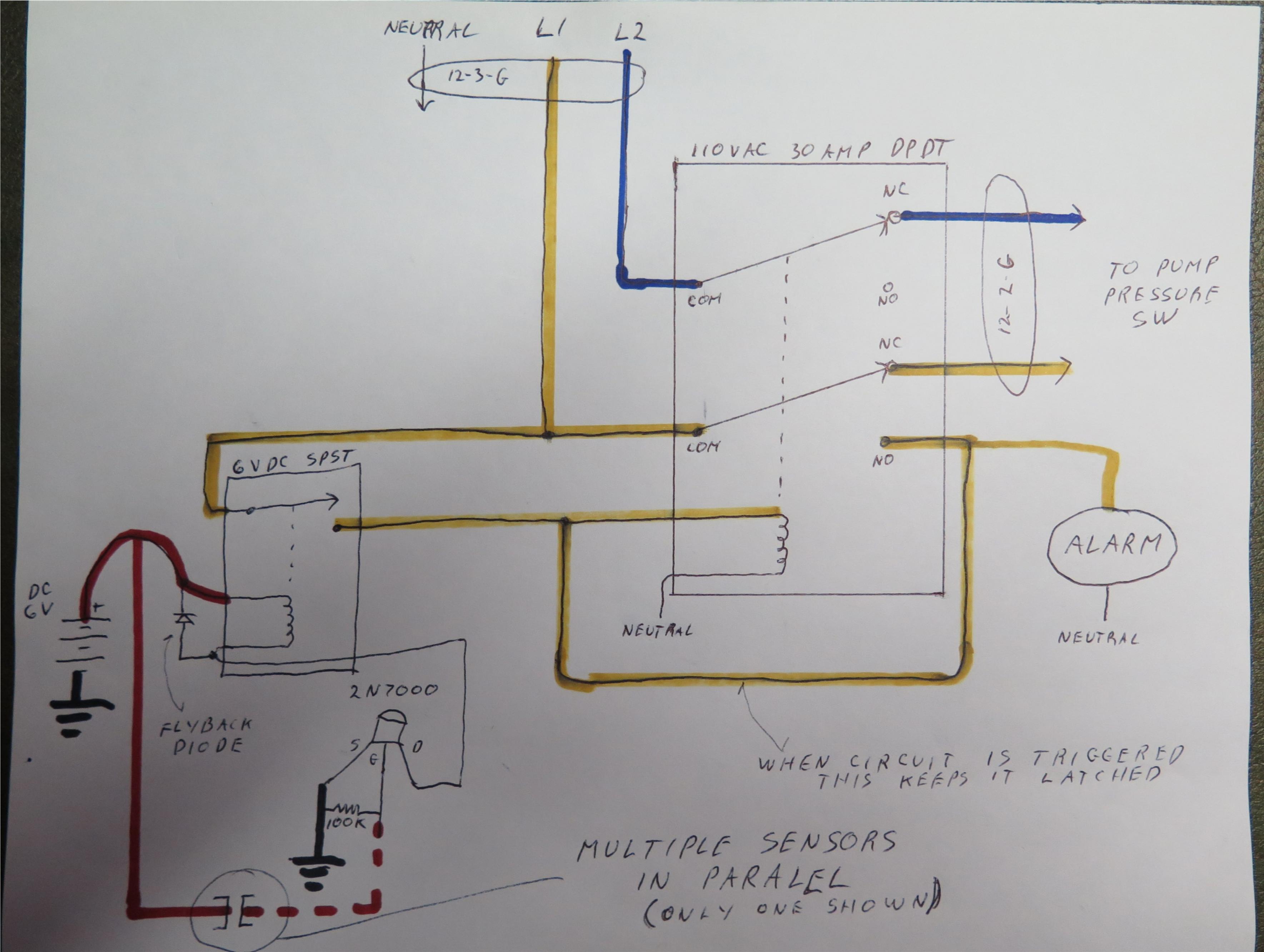

    So I recently built a emergency pump shut-off circuit that will limit spilled water to what is in the pressure tank (4 gallons or less).

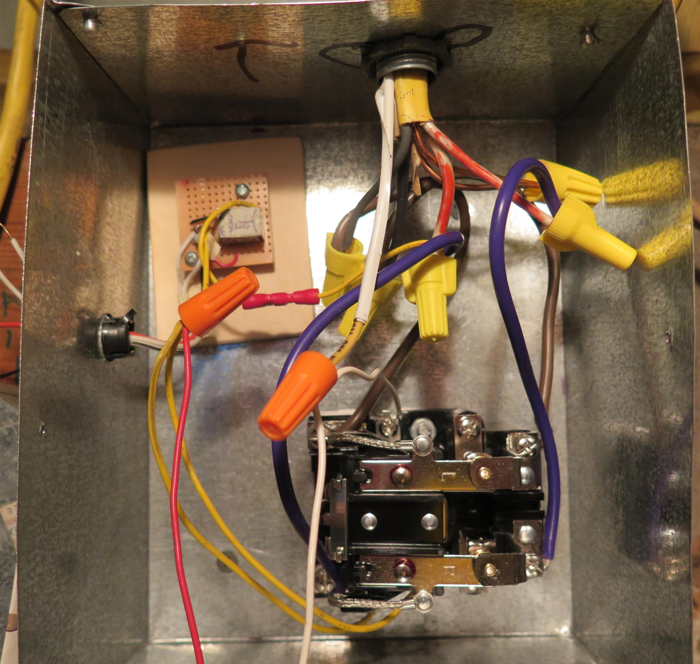

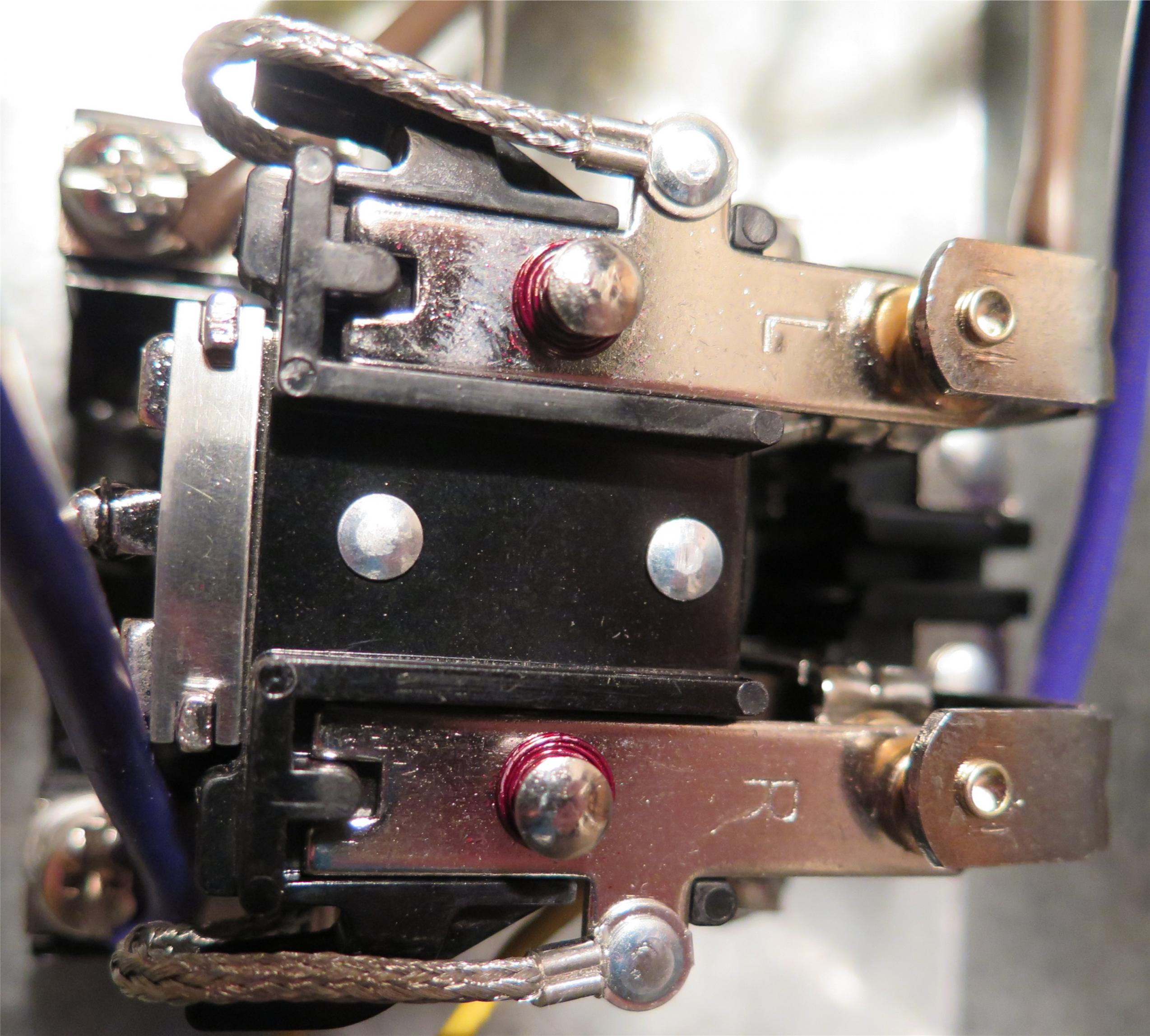

    The circuit uses a 30 amp DPDT relay which is normally in the inactivated state, so there is no power drain until a problem occurs.

    The sensor part of the circuit uses a low voltage relay powered by a MOSFET transistor. This is powered by 4 AA cells to get ~6 volts. I measured imperceptible drain on these batteries (no reading on micro-ammeter) so batteries should last a long time (> 2 years).

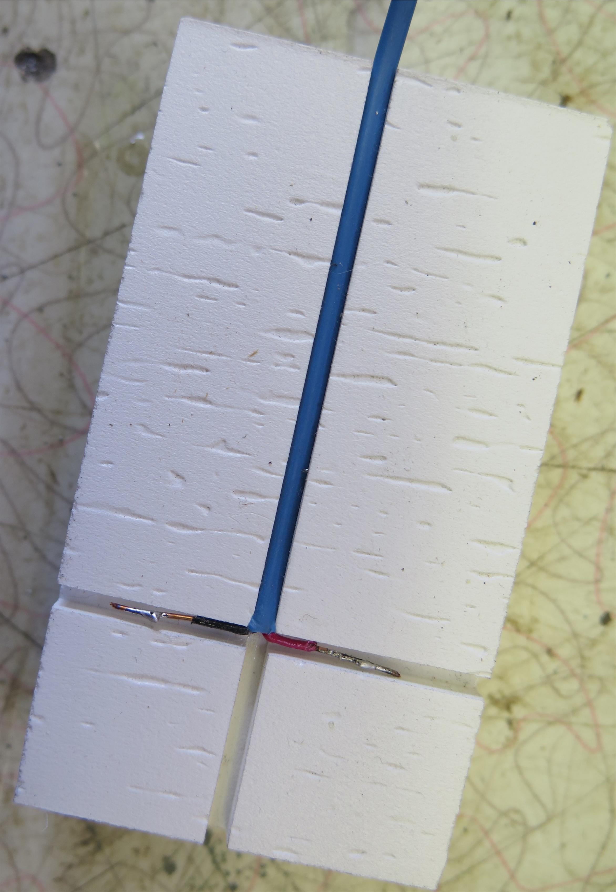

    Sensors are simply 2 wires stripped and tinned and set in a plastic block. I have them at every sink and the main utility room in the basement. The MOSFET is a readily available inexpensive one (2N7000) and is required to drive the 6 volt relay. Besides the 2 relays and MOSFET there is a 100K ohm 1/4 watt resistor to bias the FET to keep it in OFF state and a FLYBACK diode to protect the FET from reverse current when the relay turns off. Most any small signal diode would work.

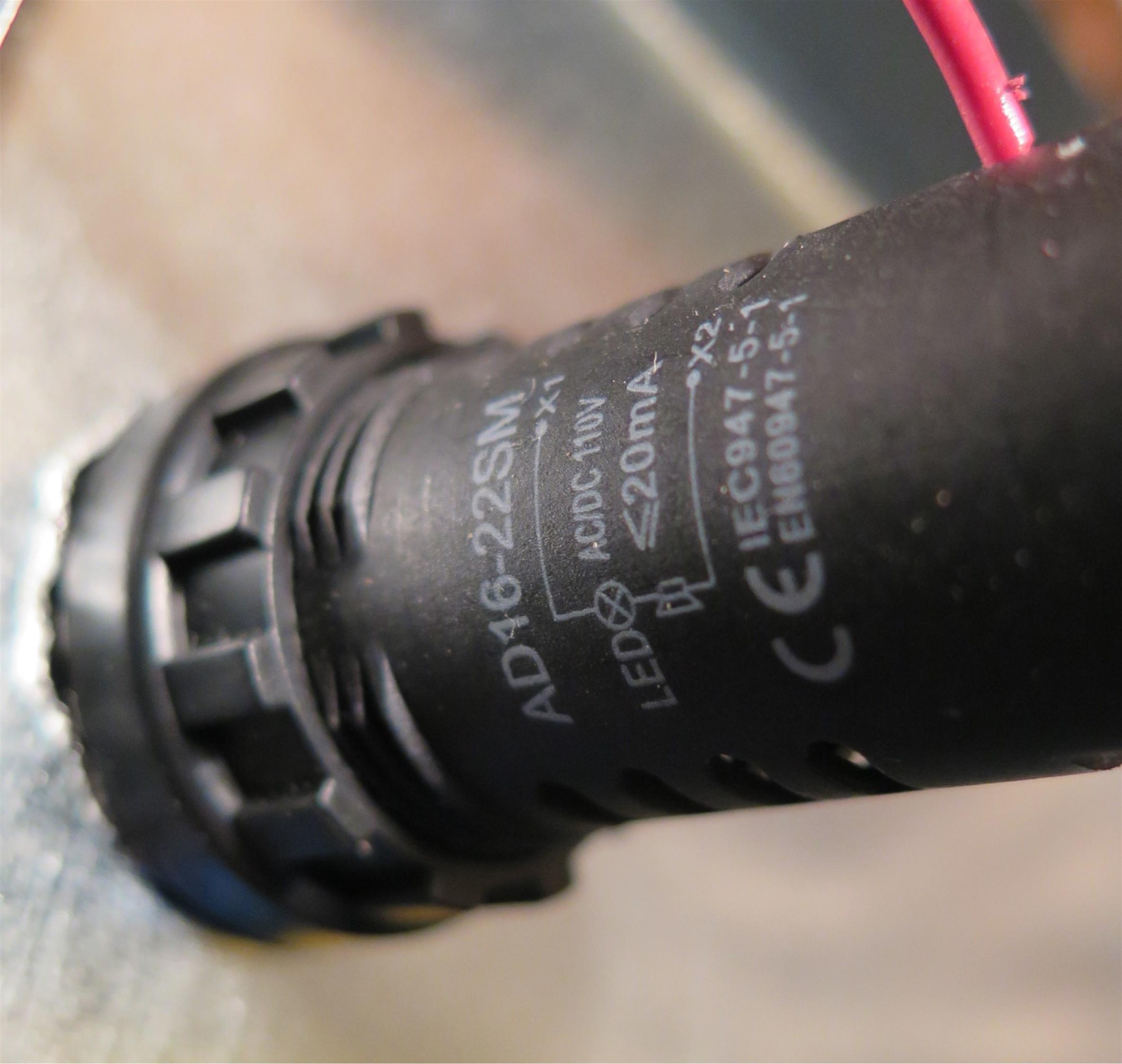

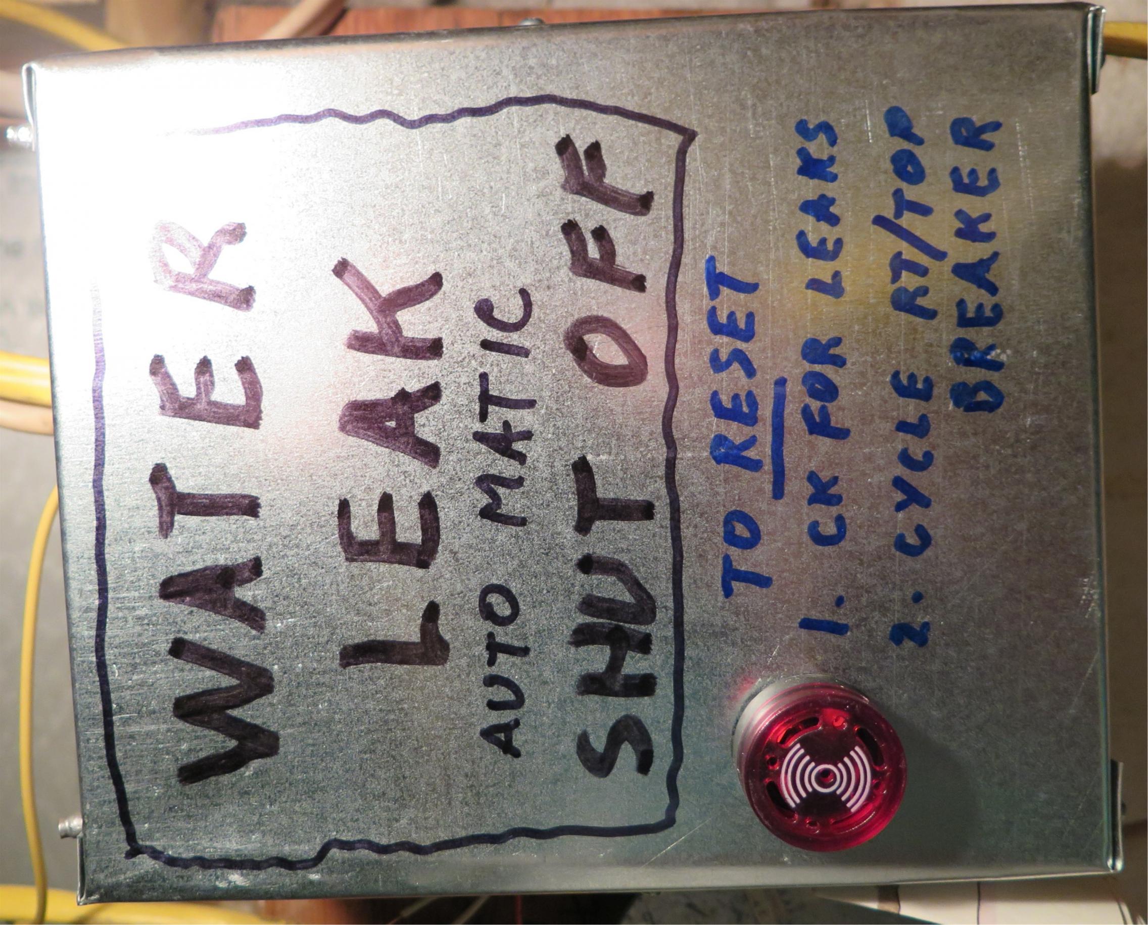

    Once the circuit is tripped by a leak, it latches and turns on an alarm signal.
    To reset the circuit after being tripped, simply turn off then on the breaker for the pump.
