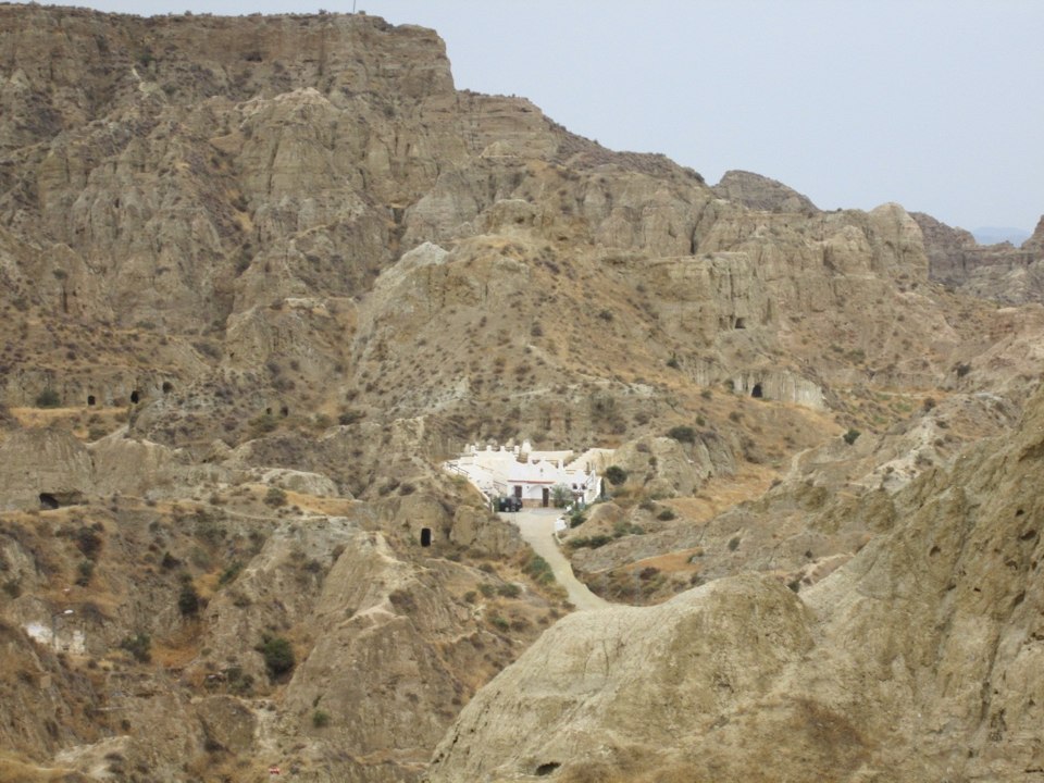

    A few months back my wife and I rented one of these houses for a week's break. It was just outside of the town of Guadix near Granada. This photo shows that it was not in a crowded area although the entrances to numerous abandoned can be seen dotted around.

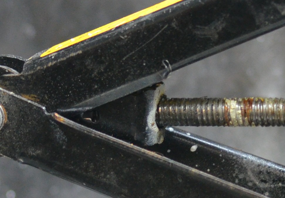

    No problem, I had a spare and a screw type jack. The jack was brand new by Ford. As the tyre was completely flat the jack had to be closed to its minimum height to fit under the car. This is the situation which applies the largest load to the screw. Anyway I started jacking away and the car started to lift when with no warning there was an even louder bang than the tyre bursting and the car dropped down. Firstly, I just thought that the jack had slipped (the ground had a steep slope) and I tried again but nothing happened. Examination of the jack showed that the the screw thread had stripped.
    The car was sideways on a steep slope, the duff tyre on the down side. With hindsight I should have turned the car around 180 deg. That would have lightened the load on the working side, the suspension wouldn't have compressed so much meaning that the starting position of the jack would have been more favourable as well as being less load on it. Hindsight is a useless tool, foresight is much more useful.

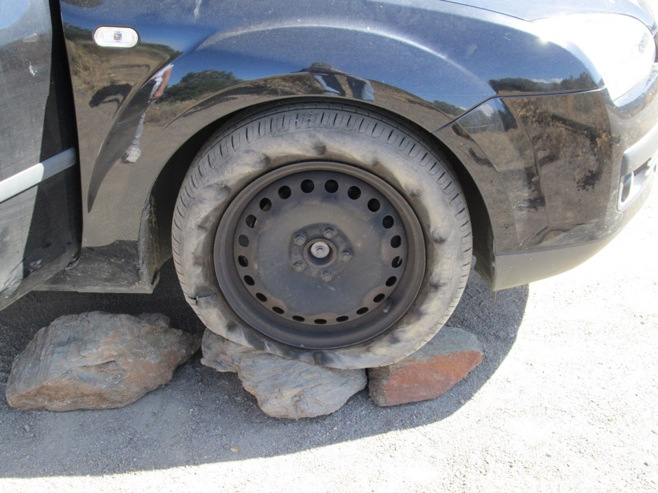

    On the way up the trail I had noticed that there was an area where there were a lot of flat stones. I thought that if I could drive up on some stones the underside of the car would be higher off the ground and I was hopeful that it was only the thread on the screw that stripped and not the nut as well. So I drove back down the hill. With a higher starting position it would have been an undamaged part of the screw in the nut. My optimisum was ill founded though. The nut had stripped as well and the jack could not take any significant load.
    Here is the car on the makeshift ramp. I found one stone with a tapered end, so I positioned that first to ease the transition. Note the tear at the eight o'clock position.

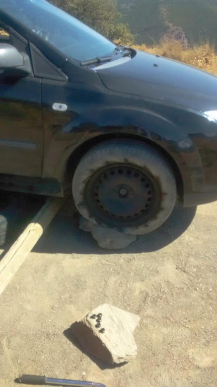

    I needed new tools. I started to look for ideas in the surrounding area and unbelievably I found a long wooden pole 100 to 120 mm in diameter. I turned to my wife and said that the ghost of Archimedes was smiling on us. She had no idea what I meant. I got some more stones to act as a fulcrum and with the pole positioned appropriately I was able to lift the car a little. So I managed to work the car upwards in steps. As I lifted, my wife stacked stones under the car to hold it, then I would add another stone to the fulcrum etc.
    Under the circumstances taking photos was not a high priority, I took the previous one when resting, my wife took this one with a phone, it is the only record of the Archimedian influence.
    Before I got the car high enough to remove the old wheel and fit the new one, I reached the stage of being unable to go higher for two different reasons, firstly the fulcrum became unstable as it got higher (stones on stones) and secondly I had passed my physical limits, the temperature was high and at 3,000 m there is only 70% of the oxygen to breath that there is at sea level. I had experienced heat stroke some years previous and I recognised the early symtoms, so I rested and knew that I could only continue with minimum exertion. I spent 20 minutes wriggling the stone under the wheel until it came free, the suspension then extended a bit more and the wheel dropped to the ground still preventing its removal. Well if I couldn't get the car farther off the ground I would move the ground away from the car. So with my hands and a large screw driver I slowly dug a hollow under the wheel. Then swapping the wheels was a piece of cake, a few minutes tidying up the tools and we were on our way again.
