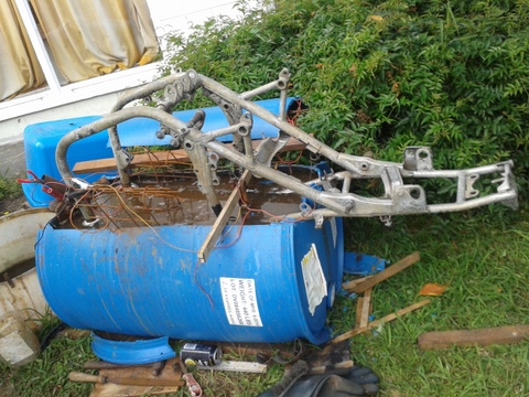

    hi good on ya I have been doing this for past 10 years ,tractors ,motorcycles ,cleaning chromework etc.A light bulb in the circuit will protect against system damage from shorts and give idea of current flow if you dont have an ammeter showing actual current(highly recommended shows gradual drop off in current as corrosion builds up on sacrificial electrodes).Ya dont need such heavy cables the current limiter is the surface area of the work and electrodes and their closeness to each other 4-7 amps will suffice so only small cables needed and wire the scrap electrodes in parallel so when one or two stop working it doesnt affect the others.
    Started with a setup much the same as you but any bolted connections soon become highly resistant so now i just use alligator clips and a pinch of fine steel wool to help maintain the contact,make the connections well clear of the water and if done outside keep them dry.A rinse with phosphoric acid/jenolite or other proprietary solution eats off the black oxide adds a phosphate coating protecting bare metal and excellent etch for priming.
    My last big setup for doing a 79 z1000 frame an parts,frame to big to fit in barrel so had to do it in 3 passes and use extra electrode to get into places that are masked by the tubes of the frame ,process only works line of sight so extras to hang where needed are a mustElectrolysis rust removal-aaa.jpg

    Thank you for the advice, information and the photo of the frame. I take on board all the suggestions. I have just added a cheap digital volt/amp meter I bought on eBay to the project box. It didn’t arrive until after the initial build so decided to run without it until it arrived.
    I am really impressed with how effective and the results of this process work.
    It’s funny the little trowel which was once my late mothers has been painted red and was used by my little girl today for the first time, while we were potting up some seeds for her in the greenhouse.
    If I need a large item to be cleaned I will be using your method thank you again for taking the time to share your experience with me.
