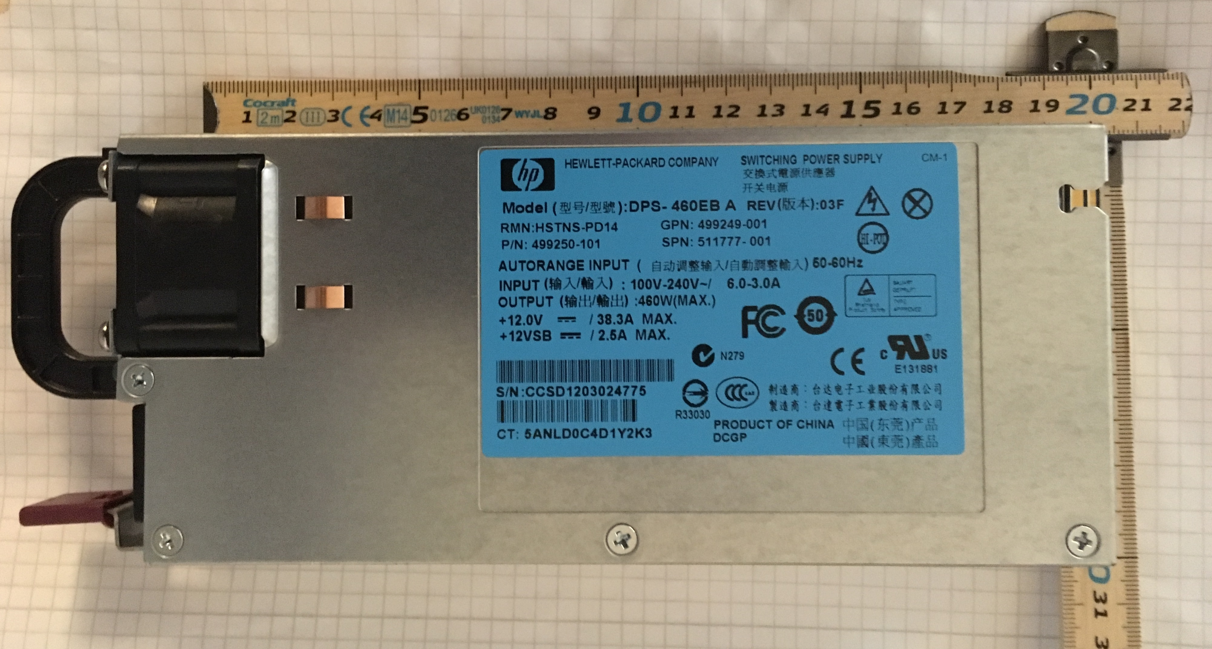

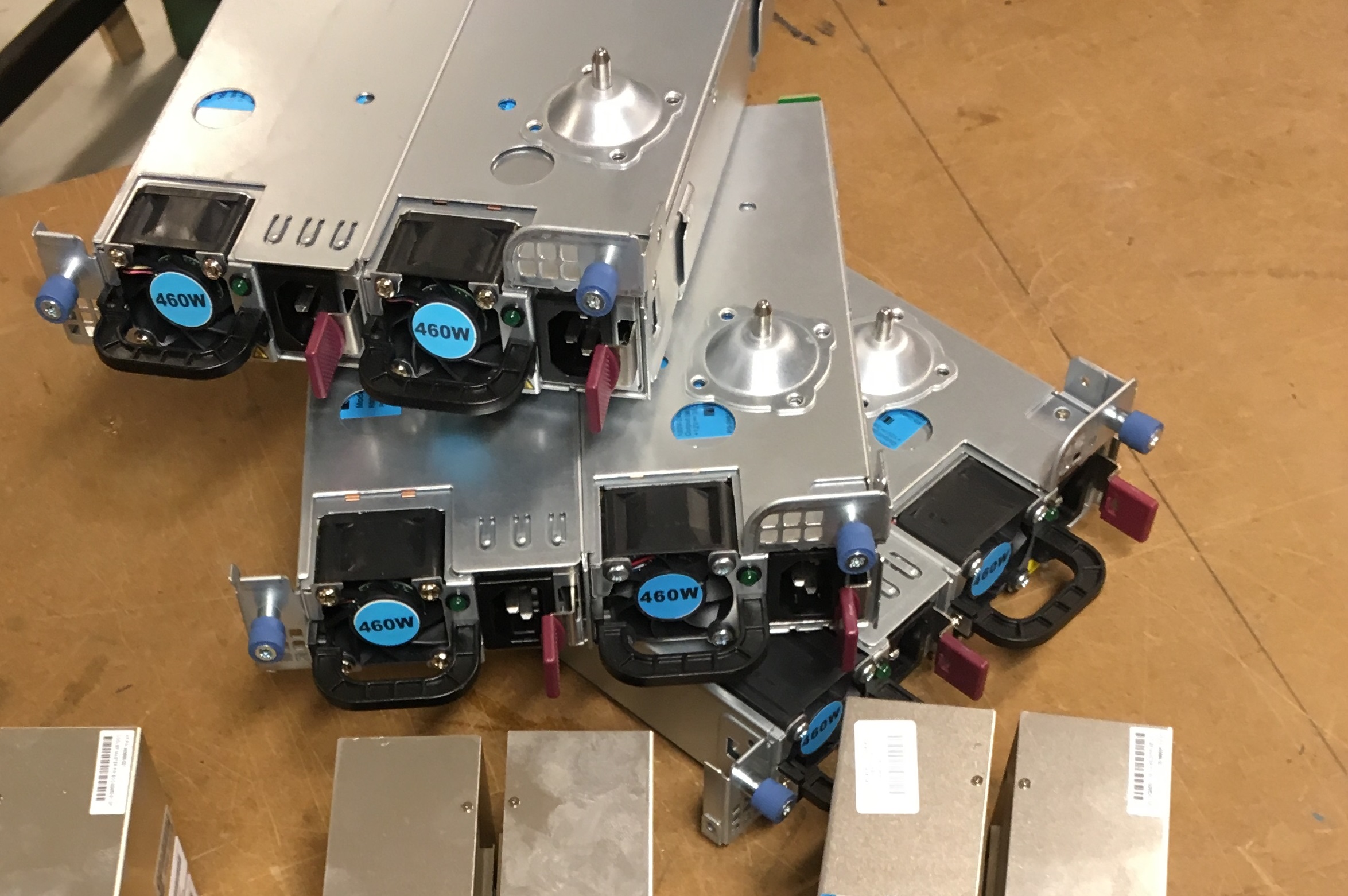

    Some facts from Cougartron:
    Sleeved carbon fibre brush soaked in 50-ish % phosphoric acid solutiom, hooked up to a +30A, 18-12V (assumed DC?) PSU.
    Neutralize treated area w 5% sodium bicarbonate solution (baking soda),
    as pure water rinse just won't cut it - some staining might then appear after drying.
    They claim 1.3 gal of their weaker, 10-25-ish% acid will last some 5000 ft of SS TIG weld.
    So - who'll be the first picking up this challenge and hooking their Computer Server PSU
    (see pics: Just been lying around for a few years...) up to a DIYed Magic Wand?
