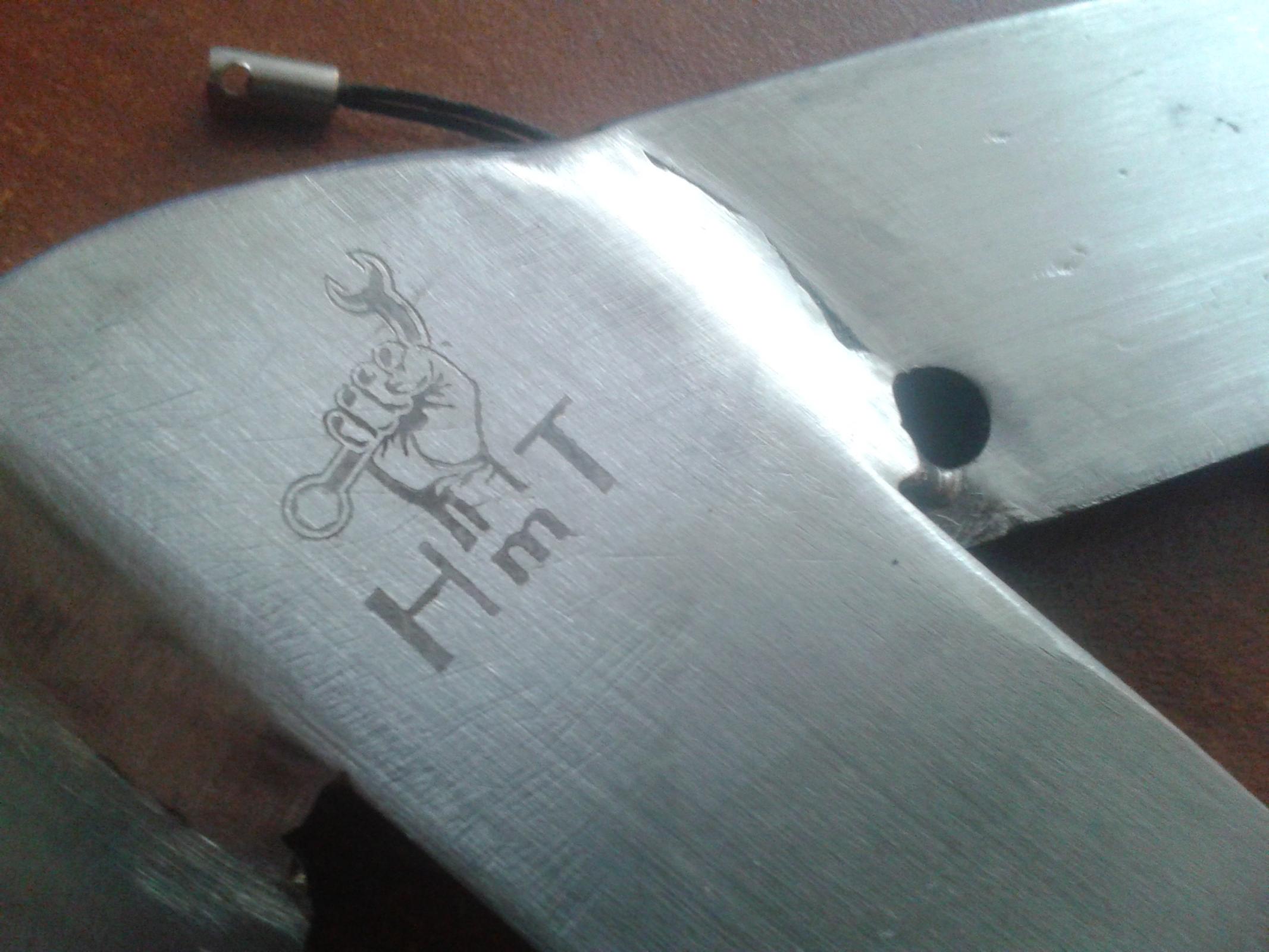

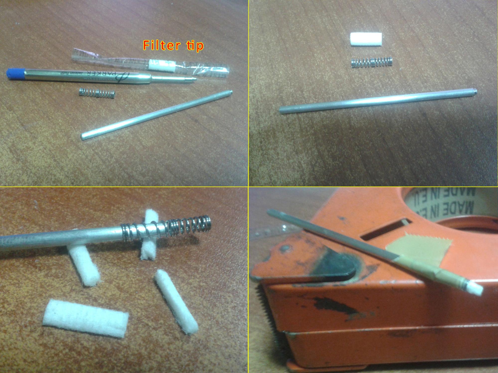

    Hi rgsparber,
    I have tried different ways for the making of electrode.
    A good one for me it was a piece of stainless steel rod a spring from pen a piece from cigarette filter and pvc tape.
    But not the best, so later I replaced the filter with a piece of felt, which is more stable and has much longer lifetime before its polymerization begins.
    Electro-etching Metal Using a Stick On Label-electrode-s.jpg Electro-etching Metal Using a Stick On Label-felt.jpg Electro-etching Metal Using a Stick On Label-20160430_165226.jpg

    If you can source AC after etching with DC it will darken the metal. In order to achieve this you would just have to run some wires of the transformer you are using prior to the diodes in your power supply.
