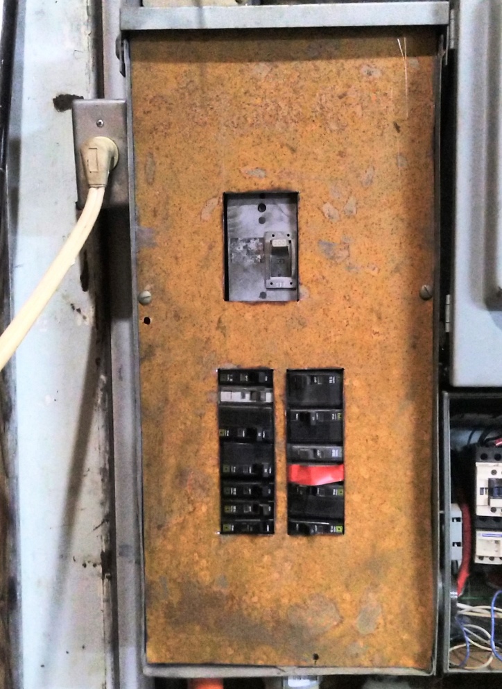

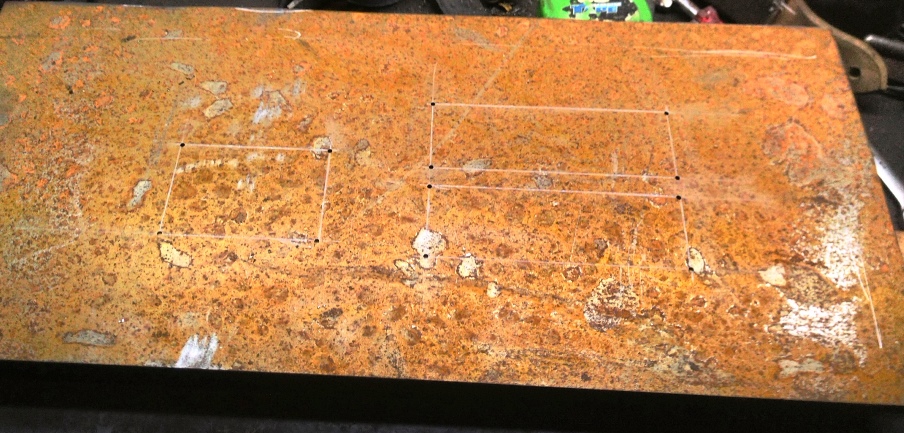

    Thes past few days with the temperatures hovering in the triple digits have found me taking advantage of the 24000 BTU AC unit I mounted in the end wall of my machine shop van. After installing a 20Amp 240 plug for it I ran a few pieces of conduit, added several more quadplex 120v outlets a strip plug under the shelf above my Mill table work bench and a light, Then I noticed I had added as many circuit breakers in the service panel as it could hold but I had somehow lost the breaker cover it was a salvaged panel to begin with so I may have never had it. I have been wiring more and more circuits in it for years and never bothered to look for it. So now that I am done with adding more circuits to that panel I made a cover I didn't care if it was fancy just something to prevent someone "ME", from accidently reaching in without thinking and getting shocked. Getting shocked by 120 or 240 usually doesn't bother me too terribly but if I happened to be sweaty or well-grounded that would be a different story.
    Here is my cover made out of 20 ga steel
    Now it just needs a little gray paint which I am out of currently

    Somewhere I think I have the outer cover that hides the breakers but it still needed this cover to prevent electrical shock

    Preventing accidental electric shock is not the only purpose of the cover. It also keeps any potential fire enclosed within the breaker panel so wood or other flamable mterials in the wall will not ignite.
