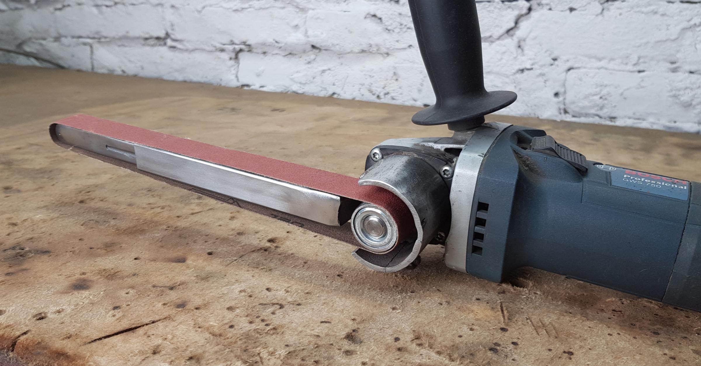

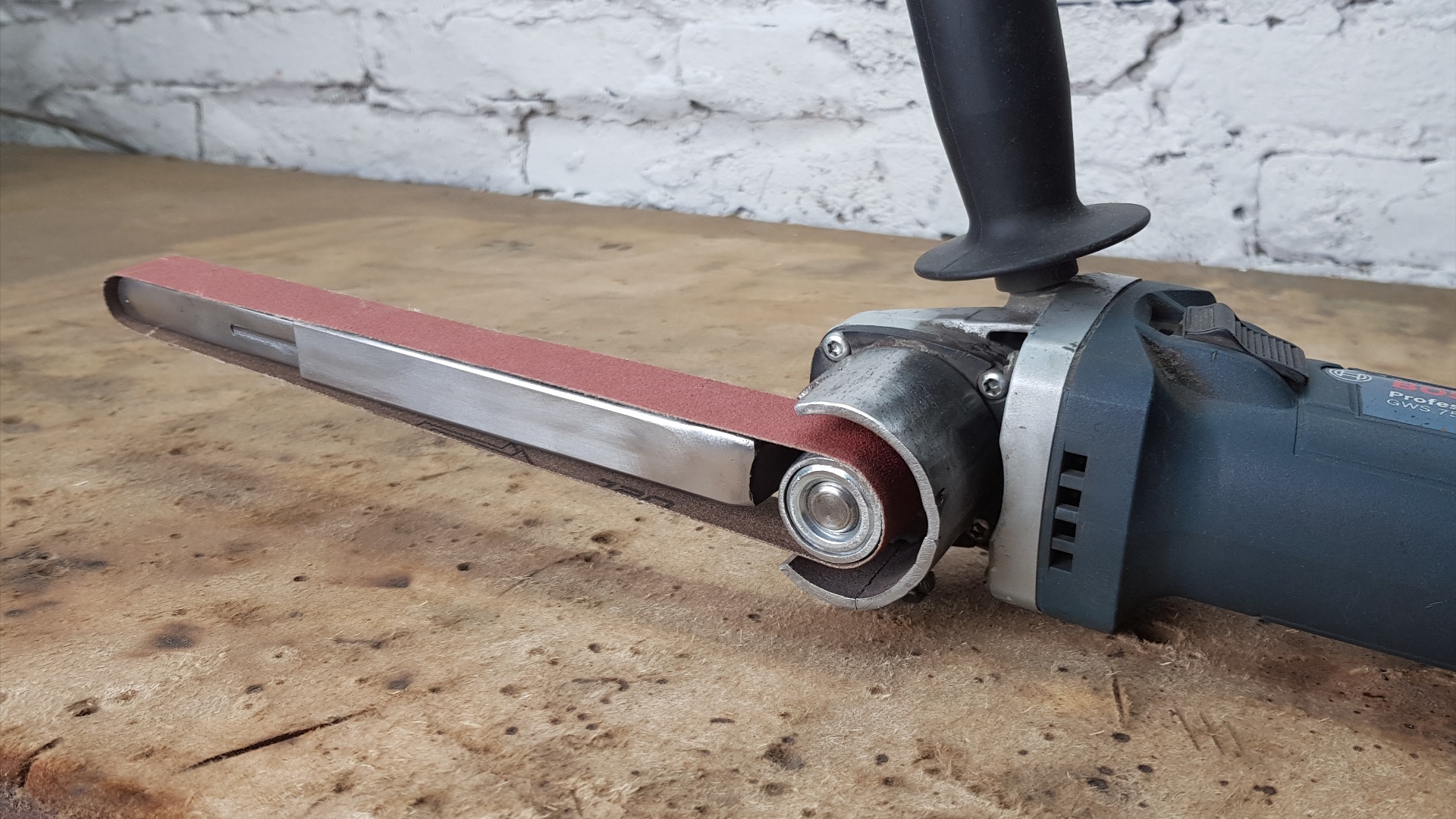

    This time a device that I put off until later, but I missed it many times.

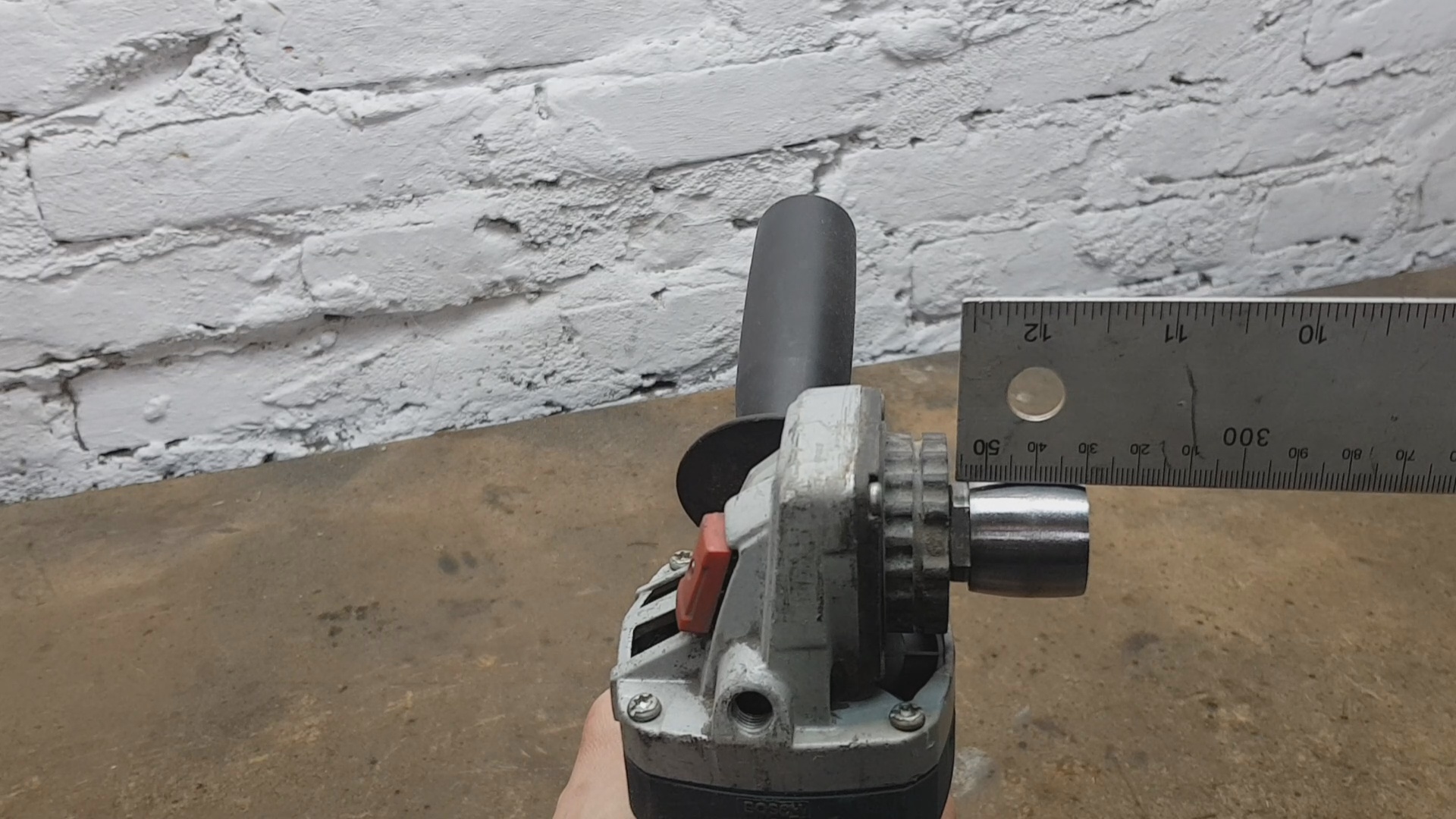

    The barrel-shaped roller is made of an M14 bolt and a tube.

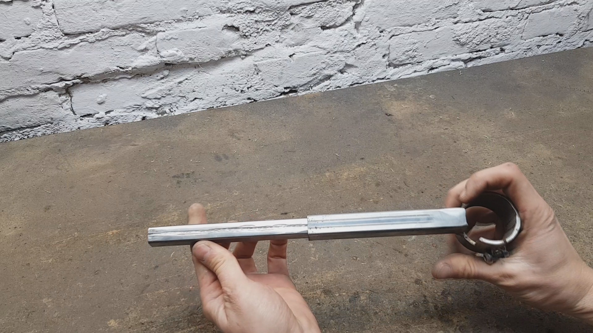

    The guide is made of two profiles that are perfectly matched so that there is no unnecessary play.

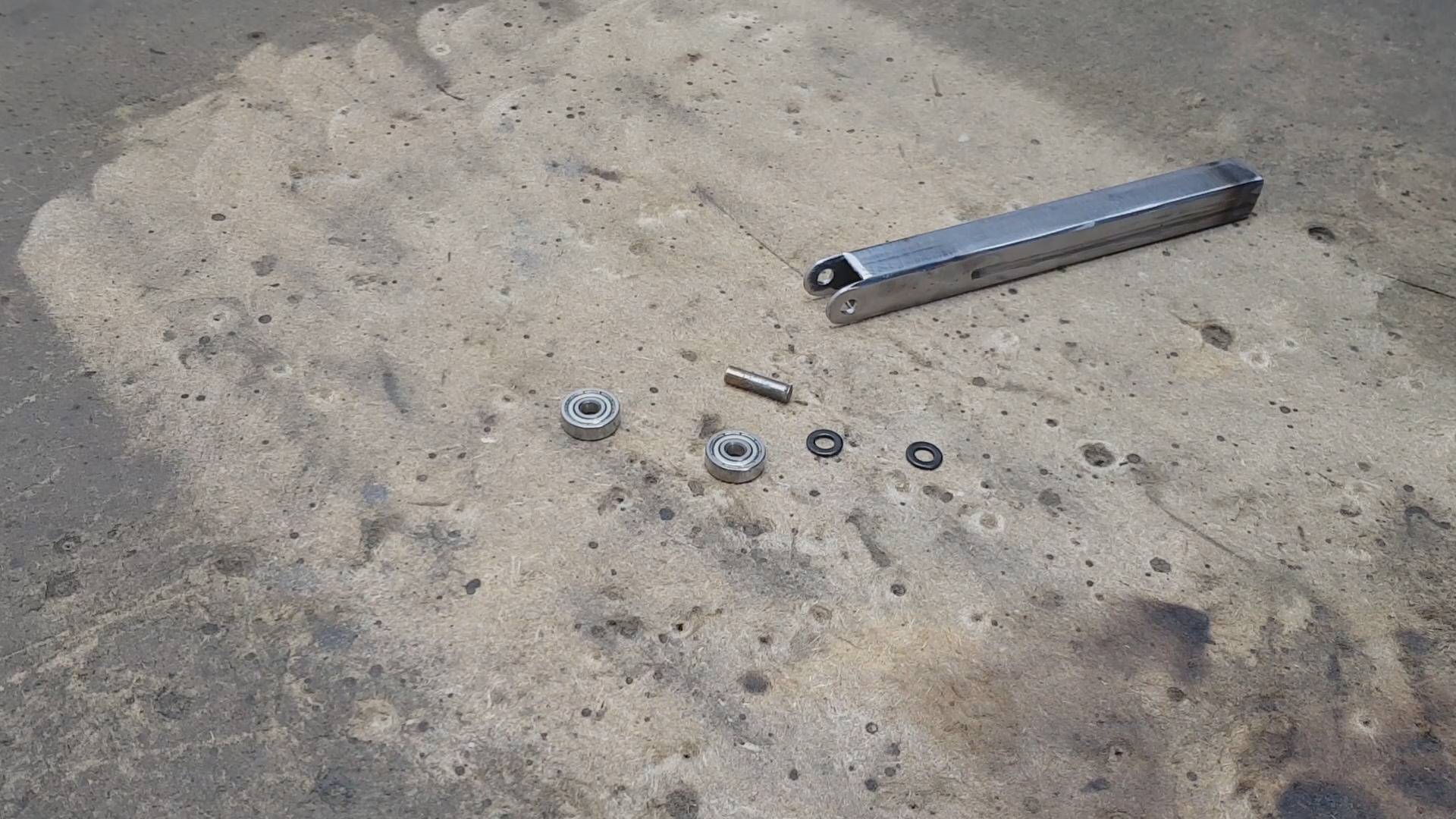

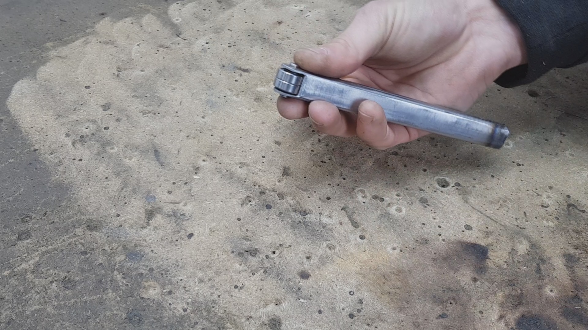

    The front roller consists of two 625 bearings, two washers and a 5mm rod.
