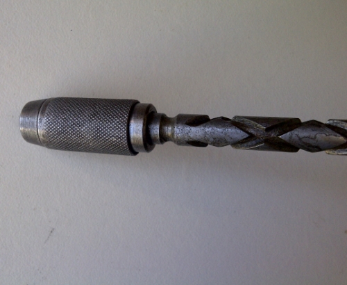

    Dear Olderdan,
    Seeing this chuck taken apart brings to question the dismantling of these small chucks - do you have any advise on the dismantling of a Yankee Screwdriver Chuck for servicing? Any information on taking these small chucks apart would be most appreciated?

    Dismantling of a Yankee Screwdriver Chuck
    Thank you for suggestions submitted with regard to Google Search.
    Have previously searched all links offered in your comment without success of finding any related info on the CHUCK - Info is very informative in dismantling and servicing the Yankee Screwdriver but nothing about dismantling of the chuck ie. Taking the CHUCK apart?

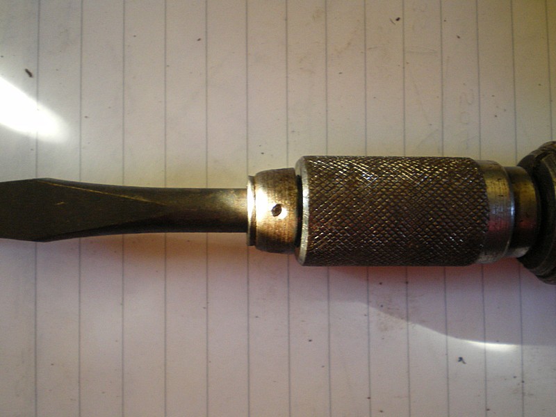

    These chucks are not meant to be user serviceable but having a closer look at the one I have I noticed a small pin fixing the front collar to the chuck body which stops the collar from sliding forwards, this appears to be a blind pin so would need drilling out and replacing with a new one and I am guessing not the easiest thing to re-assemble.
    I know the urge to repair can border on obsession sometimes (I speak from experience) but these screw drivers are so cheap on Ebay is it worth it?, power tools( namely impact drivers) have made them an unwanted item to most but I still use mine for those stubborn screws.
