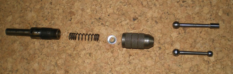

    Easy to make wobbler or edge finder from a standard pin chuck, this does not alter the pin chuck and so it is still available for its original purpose.
    Mine is an Eclipse No 160 chuck but others may suit, for the pivot ball just soften a ¼ ball bearing and drill for the arm , soft solder or adhesive to a shaft with your preferred end shape, I have used a .200”dia for both styles as all my equipment is imperial. 4mm would be good also, one barrel or ball shaped for flat surfaces and one parallel for diameters.
    I have used this for thirty years and it will repeat to better than .0005”.

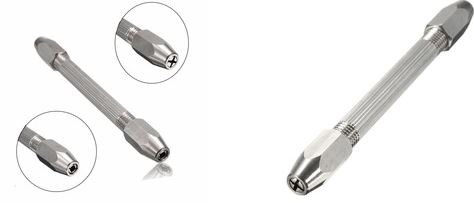

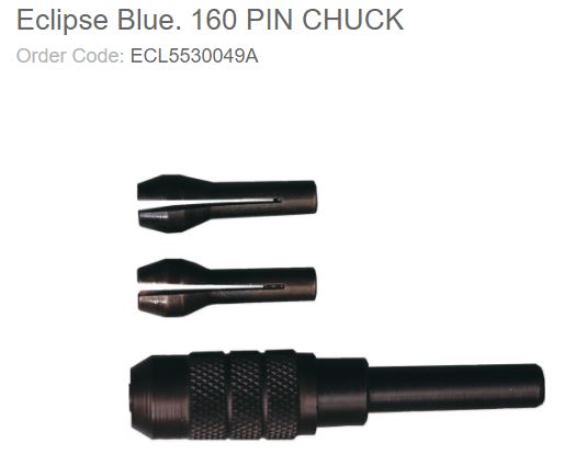

    My ignorance made me do a Google search as to what is a "Pin Chuck"
    Is a "Pin Chuck" and a "Pin Vice" the same thing?
    So one will just not use the inserts and if you buy a cheepy you will have to cut off the "Jaws"

    My interpretation would be a pin vice as having flat jaws and a pin chuck is for holding round items, if you are to copy mine you need removable collets as in your bottom picture.

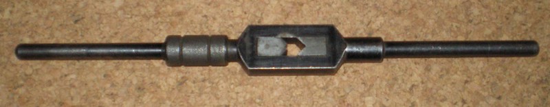

    I think the company is now under the Spear & Jackson name and the quality has gone, I am very fond of my old tools and my favorite tap wrench is a Chatwin from 1944 and is marked with the Uk war dept arrow and is a joy to use.

    Looking at the tool again perhaps I can just make the back part and use my small "T" tapping wrench front part and save some time in making the whole tool.
