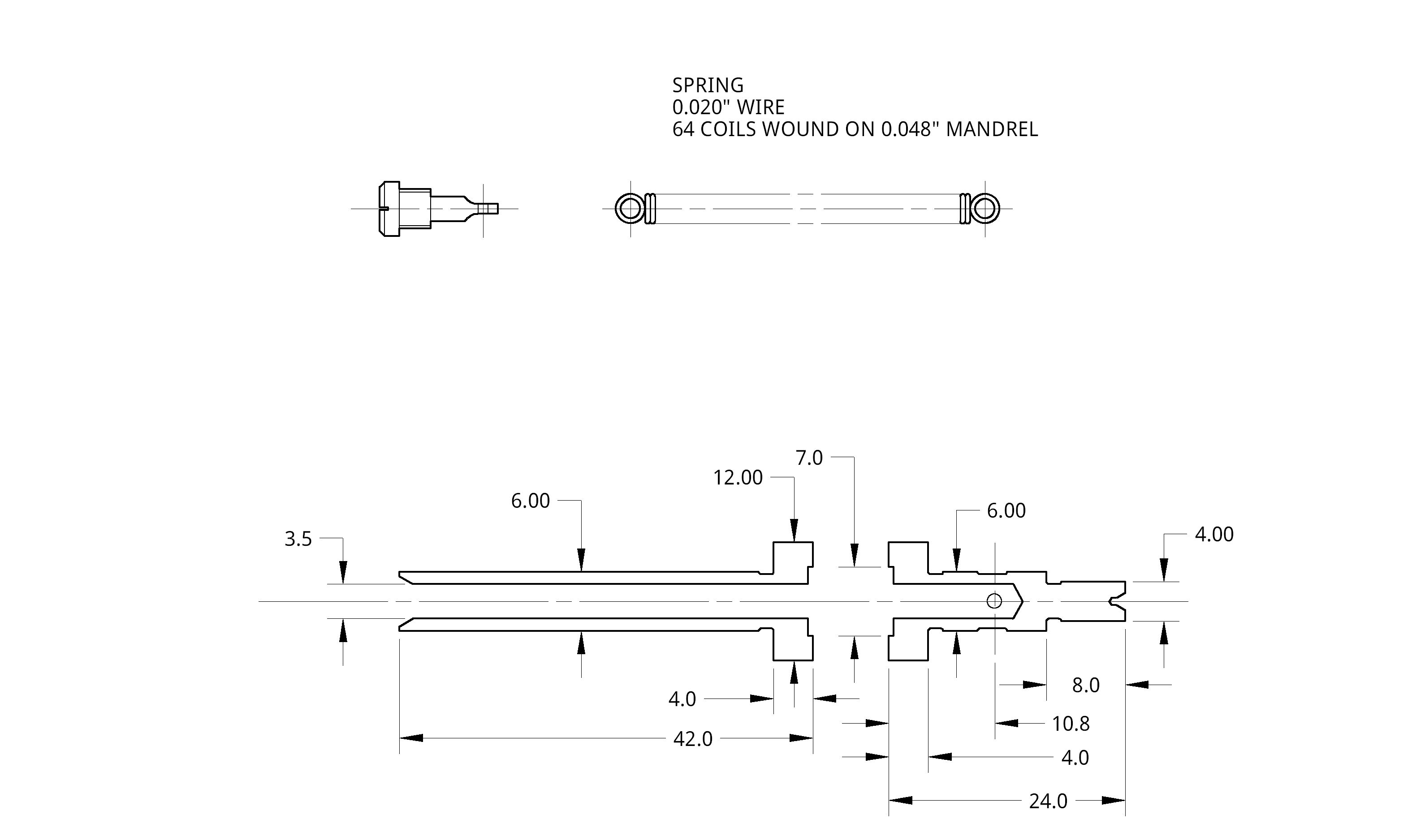

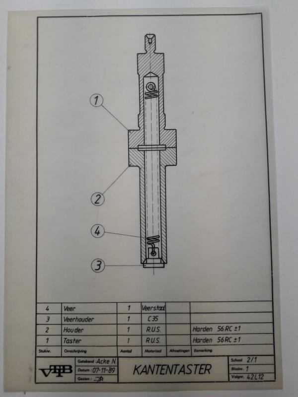

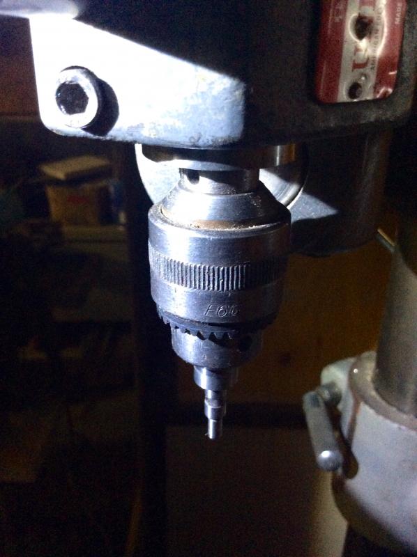

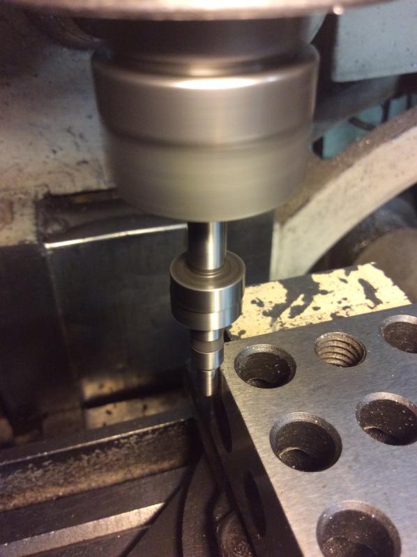

    Someone posted these irresistible old Belgian toolmaker apprentice prints for an edge finder to the “Machinist Museum” group on Facebook. They also showed a boring head, a hand drill, vernier calipers and depth gauge, and a surface gauge.

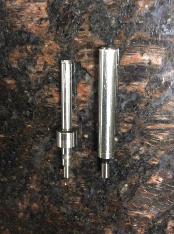

    Based on those, mine’s only lightly modified and it’s 60% the size. I don’t know how that would affect my grade, but it seems to work alright and it’s a good size for my Unimat and other small machines.

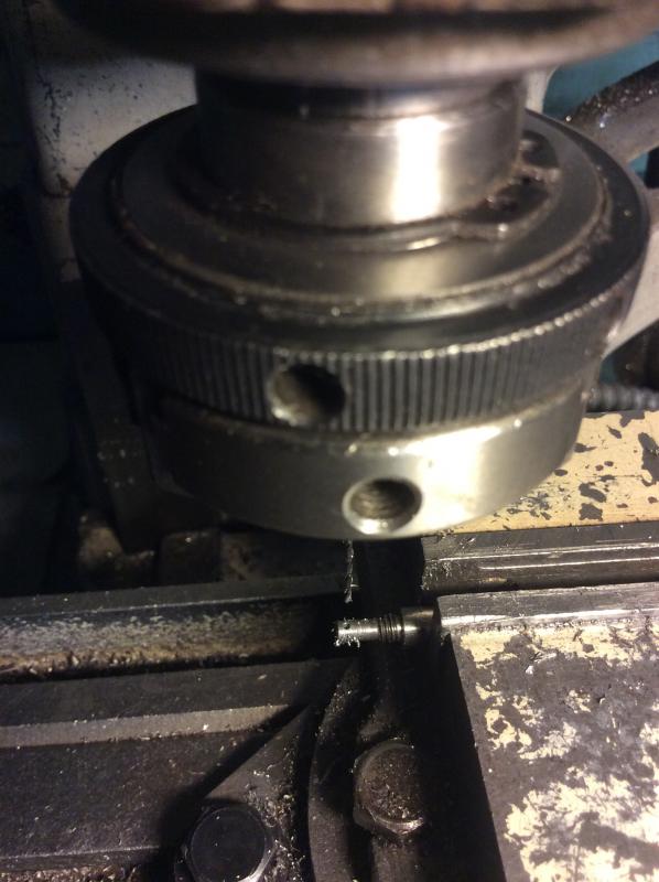

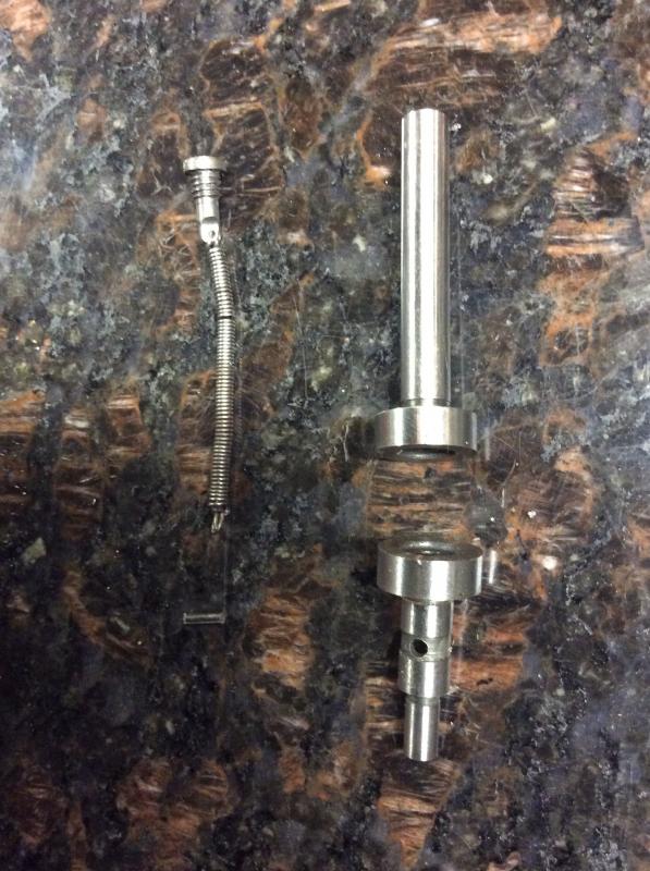

    Parts

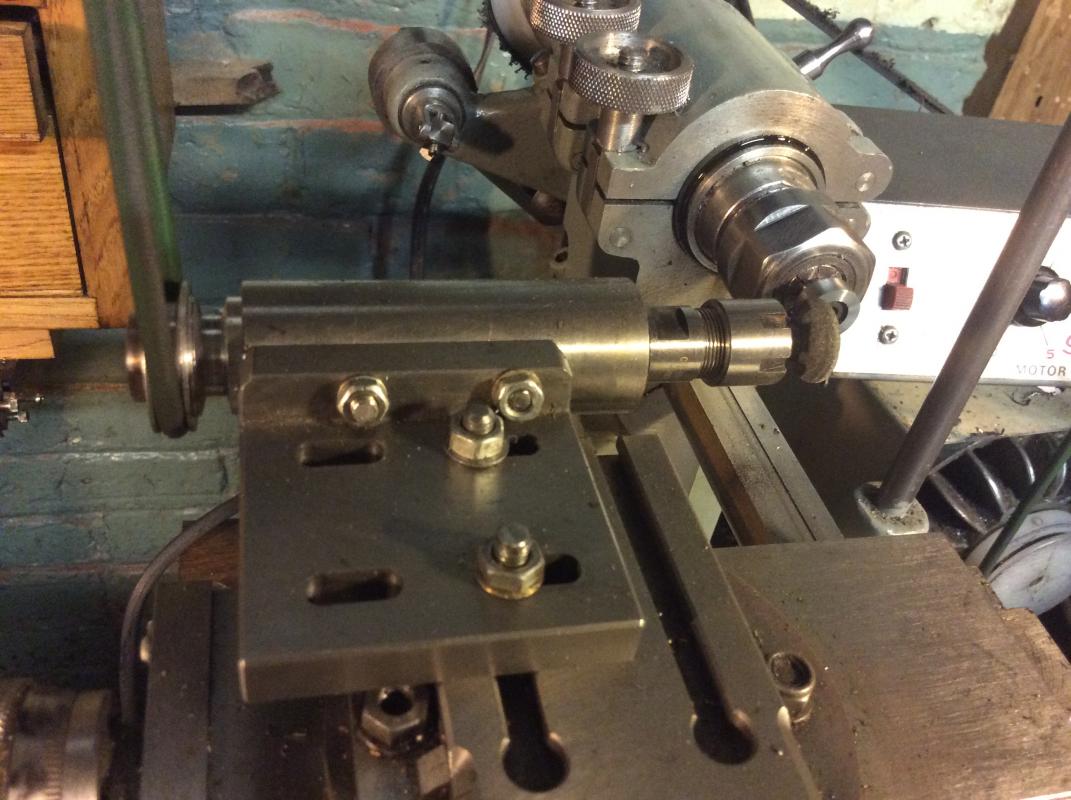

    Some operations
    Edge finder-07_edgefinderonunimat.jpgEdge finder-8e729cbc-a8bd-4c73-8125-984002580f73.jpg
    In a Unimat drill chuck, and next to a 3/8” shank Brown & Sharpe edge finder for scale

    Thanks, Dick,
    This should take you to the Facebook post where I found the drawings: https://www.facebook.com/groups/1687...5396386379373/
    Did you check out the pair of little edge finders from Proxxon?
    On the Unimat I usually leave the key screw disengaged so I can pull the quill out when there isn’t clearance in front of the chuck. I guess you could make the shank and the probe shorter, though - I’m not sure how useful it is having two smaller diameters on the working end.
    I imagine it was a good apprentice project because of the different processes and tools involved, but didn’t take so long so what it teaches stays clear.

    Quote Originally Posted by old_toolmaker View Post
    threesixesinarow,
    I forgot to ask if you wound your own spring.
    Yeah, just with the lathe slow and in reverse and feeding and supporting the music wire mandrel by hand.
    I guessed at the diameters and made the ends where the tension matched the B&S.

    threesixesinarow,
    I have some 4140 pre-hard steel. I am thinking of using that. What steel did you end up using for your edge finders? Did you harden them?
    threesixesinarow,
    I think it’s about the same but I hardened it.
