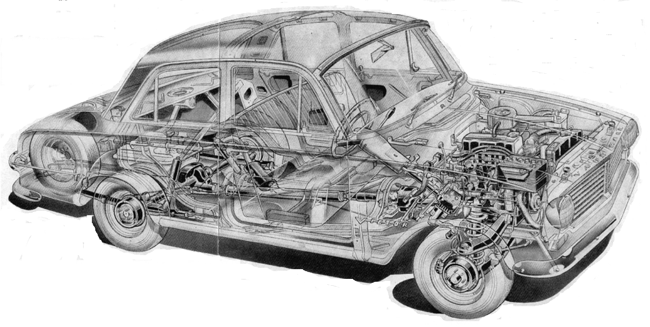

    Thanks Ulrich for yet another worthwhile tip (pun intended)!
    Hat off again for your very explanatory drawings that quickly, simply and clearly only convey the necessary and relevant info.
    Short, crisp and to the point - instead of cluttered pics or tedious videos stating some or other point.
    Bit of nostalgia hits - your drawings reminds me of those and diagrams of my (engineering) youth,
    and those pics where the crucial items were highlighted and contoured - the rest toned down,
    or even the x-ray drawings of cars that kept my concentration and imagination for hours:

    Thank You, Old Swede, for the very typical and nice example.
    These were the work of rare specialists. I guess that your picture could have taken them 2 to 3 weeks to complete.
    I find photographs more difficult than sketches. The King of ergonomics - Apple - illustrated its manuals with black and white drawings. Very elegant.
