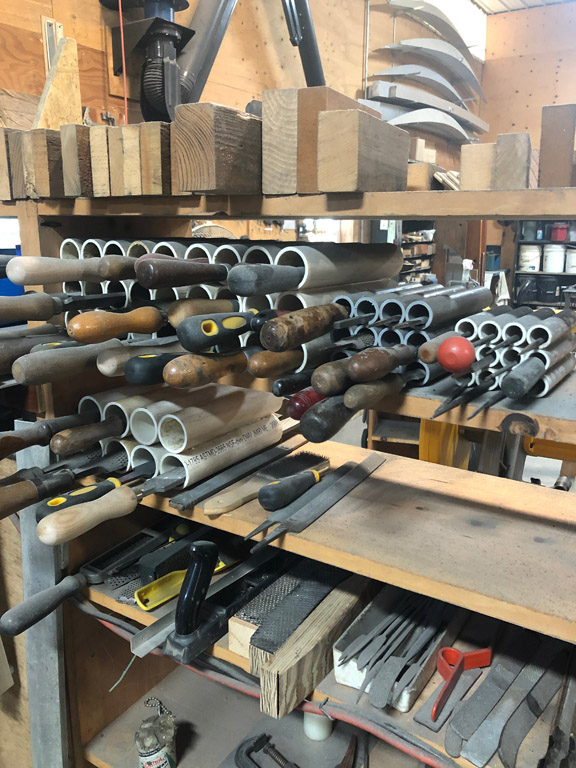

    easy cheap file rack
    Quick, effective, file storage. PVC tube hot glued together.

    Jolly good idea!

    I like that your file storage protects the files and is stacked several layers deep, reducing your footprint. I like to see what file I'm reaching for, so I've opted for magnetic tool bars... not as space efficient, but visible. I appreciate seeing different approaches to common "problems", as this expands the available options in our "toolboxes" filled with life-experiences.
