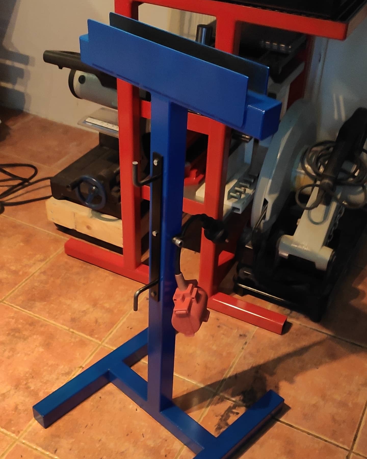

    I made this simple stand / rest.
    Where i can put grinders to rest, meanwhile i weld or do something else.
    Easy angle grinder storage stand / rest-img_20210530_143445_758.jpg
    Stand is made from 40 x 40 x 1.5mm square tube.
    To the upper part i weld pieces of plate to the sides of the tubing.

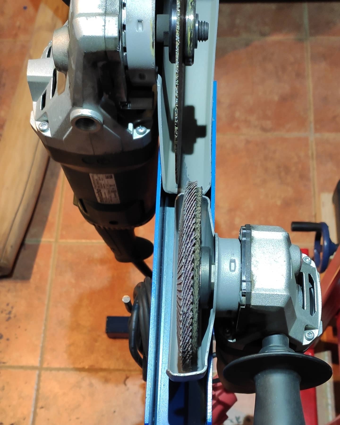

    Easy angle grinder storage stand / rest-img_20210530_143445_809.jpg
    This creates a groove that holds grinders from the guard / or wheel.

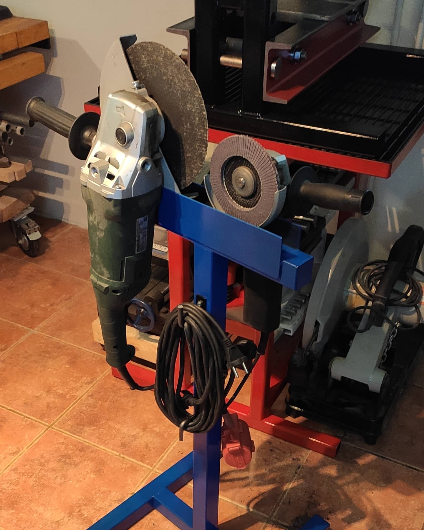

    Easy angle grinder storage stand / rest-img_20210530_143445_794.jpg
    When not in use, there's hooks for the cords, and grinders are nicely stored. When i go outside, i grab the whole set with me, and im ready to work.
