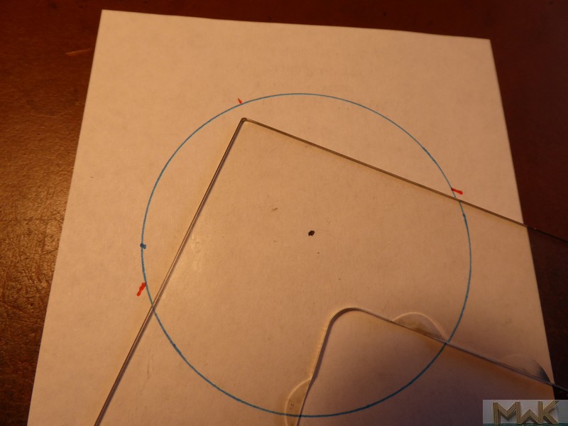

    I've positioned the right angle of one of my drafting triangles on the circle and marked the three points where it contacted the circumference.

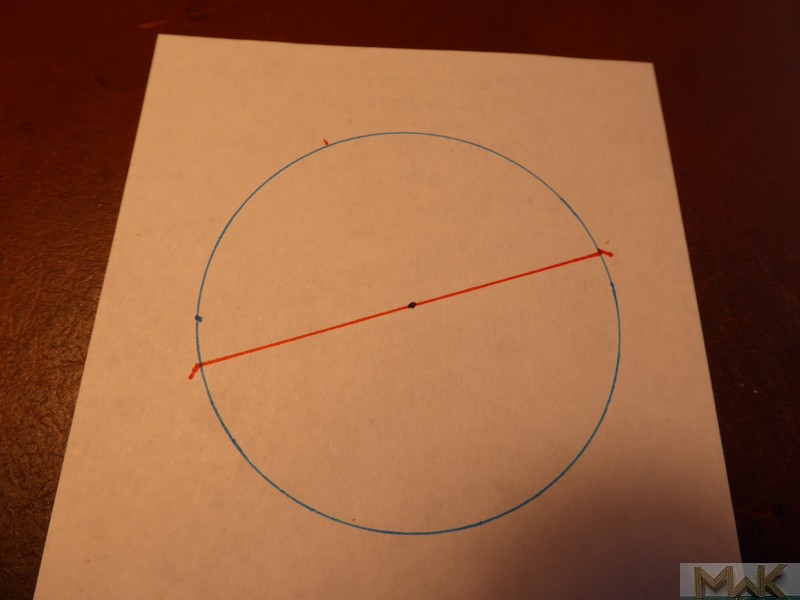

    After connecting the points defined by the legs of the right angle with a straight line, we note that the line passes through the middle of the circle; therefore it is a diameter.

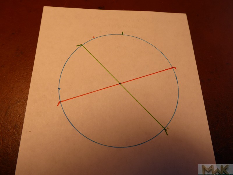

    Repeating the process with another randomly chosen point on the circumference yields another diameter that intersects the first diameter at the center of the circle.

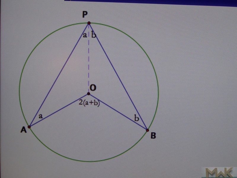

    APB is termed an "inscribed angle"; its vertex lies on the circumference of the circle.
    AOB is termed a "central angle"; its vertex lies at the center of the circle.
    Both of these angles intersect the same arc on the circumference, AB
    We want to prove that, under these conditions, the central angle is always twice as big as the inscribed angle.
    By drawing the radius, OP, we create two smaller triangles, POAP and POBP
    Each of these triangles are isosceles so their base angles, 'a' on the left, 'b' on the right are equal.
    Then the angle POA = 180 - 2a and POB = 180 - 2b
    Along with the central angle, AOB, these angles must add to a complete circle, 360 degrees.
    (180 - 2a) + (180 - 2b) + AOB = 360
    which reduces to:
    AOB = 2 (a + b)
    The inscribed angle satisfies APB = a + b
    So, the central angle is always twice the inscribed angle if they both subtend the same arc on the circumference. QED

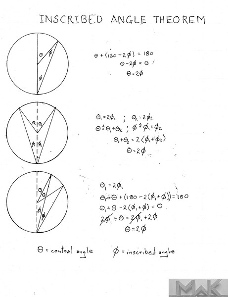

    In order to not scare mathophobes away, my proof above does not take into account other possible arrangements of the two angles. Nevertheless, the relation that the central angle is twice the inscribed angle (assuming each subtend the same arc of the circle) is always true. I proved that a long time ago as shown in the attached figure.

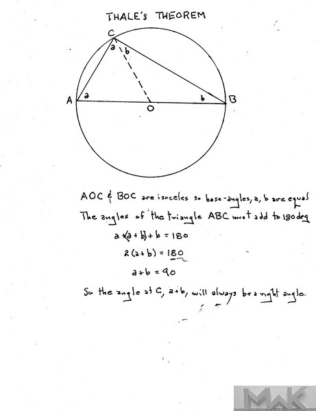

    There is an even easier way to prove that any triangle erected on a diameter will be a right triangle. It's called Thales's theorem and it dates back to the sixth century BC.
