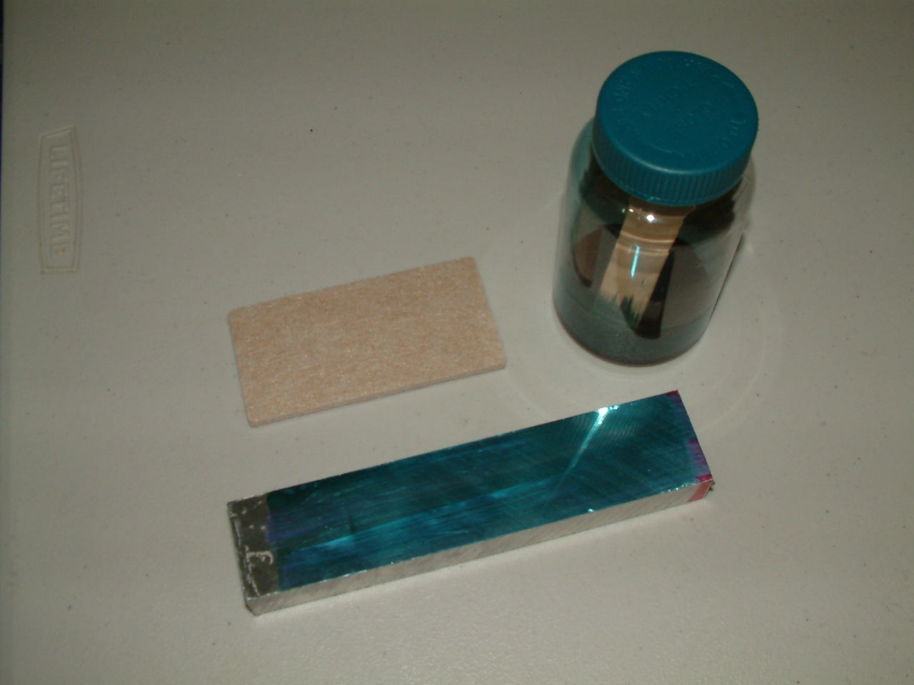

    Thanks Frank, that sounds like a good source. I did a quick eBay search for air fresheners and got something like 66K hits...
    Who knew the air was so stinky.......Any how I then thought of oil lamp wicks and found some in 1" widths. Might just buy a short order of that and see how it would work for a wide marker and at the same time use it for way wipers on the lathe.
    Cheers, JR

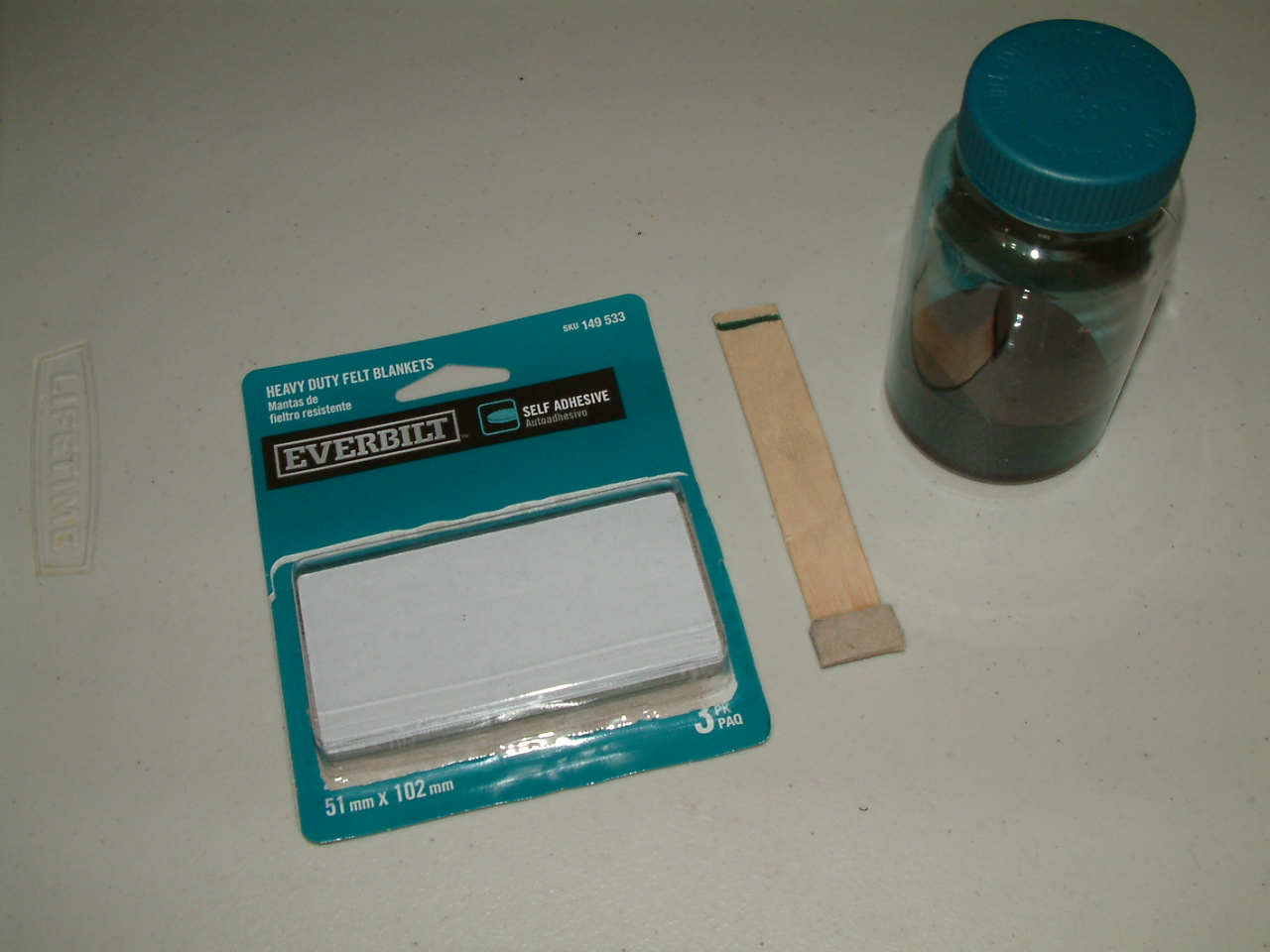

    More Dykem Applicators
    Thanks again Frank and Toolmaker51. I found some machinery felt or insulating felt at Zoro for a good price if you order $50.00 worth of stuff but I don't have anything else right now to order. I really wanted to try the felt. So I ran over to HD and found some stick on glider felt that was almost 1/4" thick. It is sticky back but I removed that tape and found that the felt had a stiff resin applied for a minimum thickness on one side only. So you can see by the pictures what transpired. Used a bit of super glue to put it on a flat stick. I only made it about 1" wide and it really lays down a thin light and very even coat of Dykem. It works great for a wide applicator and I think I will just save my Oil Lamp wick for some other project. So If I want wide I just go to the plastic jar with felt "brush" and for a quick smaller applicator I will use the refillable Magnum Sharpie.
    Thanks again for all the great comments.
    Cheers, JR

    I've got some of that felt glider stuff laying around and am going to make a applicator like yours JR. Is there a reason not to make it replace the brush in the Dykem bottle?

    Sounds like a good idea to me. Remove the Dykem brush bristles and maybe open up each side of the crimped part of the brush area a bit. I would think that a good cleaning of the metal with alcohol would then allow the CA to hold everything solid. I made mine wider than the can opening and used a different bottle that would fit the wide tip. Anything that replaces that coarse brush would be good.
    I had thought about just getting a good camel bristle brush, removing it from it's wood handle and gluing or crimping that to the in can brush stem as an improvement for obtaining a light thin coat. May still do that.
