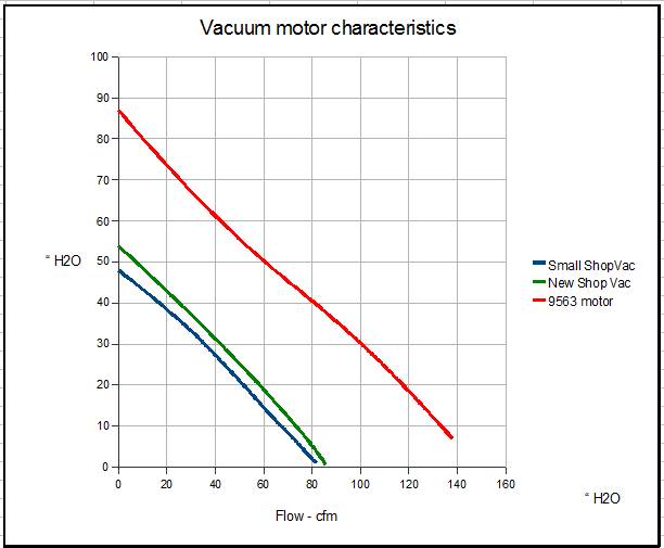

    But I might be wrong. My gut feel says strongly that you want high air velocity. But gut feel can lead us astray, so I just worked it out from a head loss perspective. Going from 4" round duct to 6" round duct will save you about half a PSI. The 4" will have about 0.7 PSI of loss, and the 6" will have about 0.1 PSI. For a shop vacuum that may only make -3 PSI (guessing here), that may be significant. You might very well get 10-20% more suction at your endpoint by increasing the duct diameter.

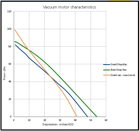

    I have measured various shopvacs and none get to 3 psi with useful flow. Here are the results of tests of different shopvacs, without further explanation. The axes show pressure in inches WG, for reference 28" is 1psi.
    Dust extraction - sizing-vacmotorcomparison02.jpg Dust extraction - sizing-vacmotors_01.jpg

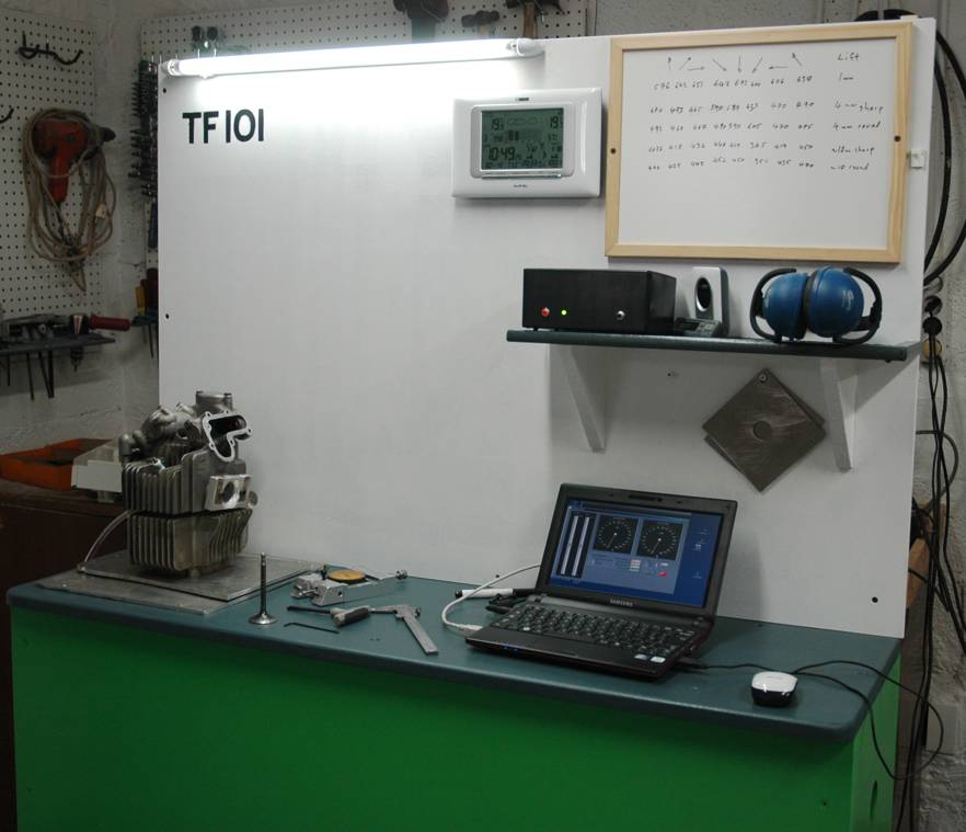

    I needed the info when designing my flow bench.
    That's interesting. I've never had the opportunity to mess with one, but I've wondered about mounting a loudspeaker to do Helmholtz resonance tuning as well as flow. Is that a thing that people do?

    Pressure waves can be very important to the performance of highly tuned engines. I pointed out that the suggestion to evaluate this on a flow bench would have problems due to the need to emulate very high exhaust temperatures, because the wave velocity various with temperature.
    Quote Originally Posted by mwmkravchenko View Post
    .... Tony I think is looking for unidirectional flow.
    Actually I test flow in both directions. The wave action at certain parts of the cycle at different RPM causes reverse flow. It is good if you can reduce the reverse flow without reducing the forward flow. Hence the two way testing.
