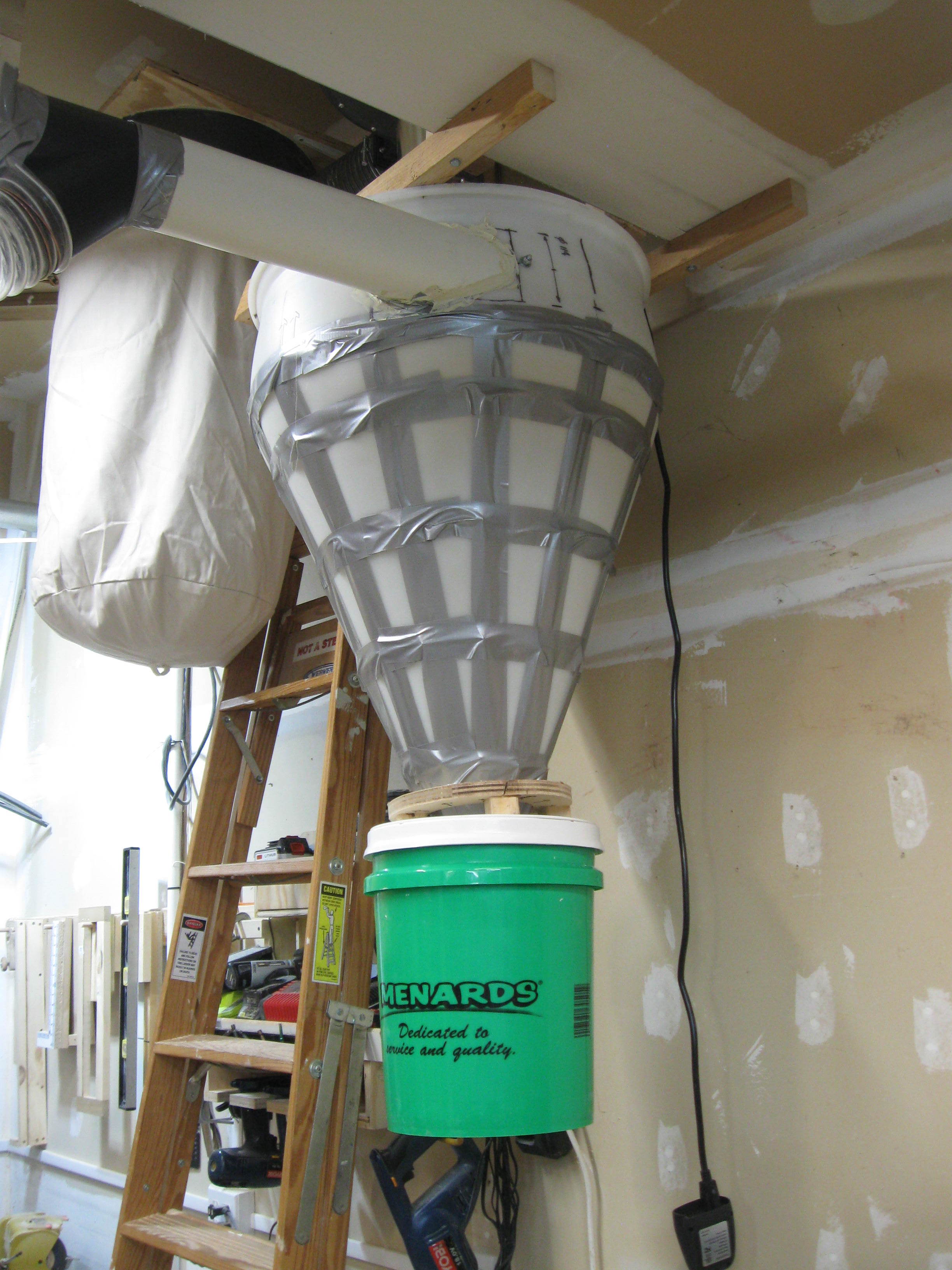

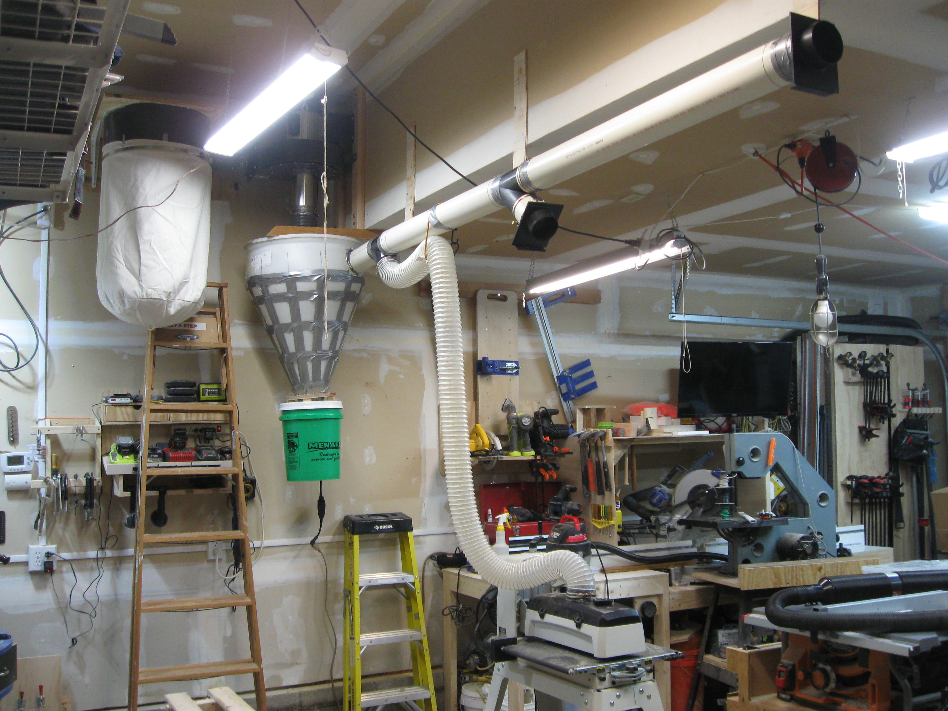

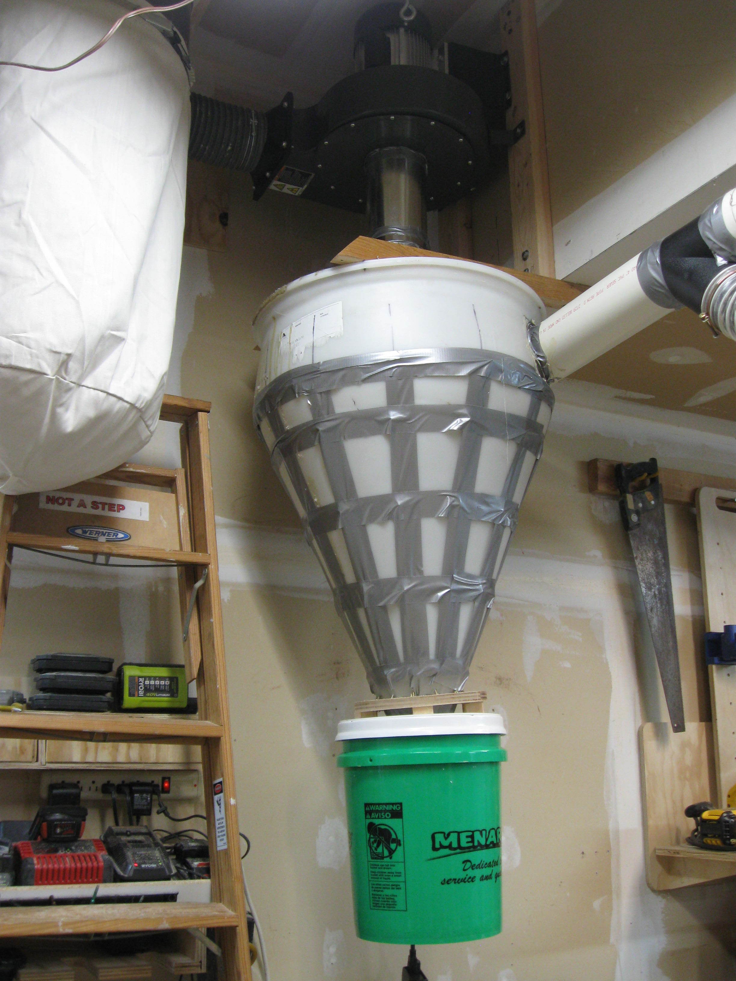

    Hi Gang:
    I spent a weekend with my brother in law and we built this dust collector:
    Dust cyclone separator-img_3429.jpgDust cyclone separator-img_3430.jpgDust cyclone separator-img_3431.jpg
    We started with a floor model Harbor Freight dust collector:
    https://www.harborfreight.com/35-gal...dust+collector
    He wanted it off the floor and also wanted a cyclone. He had us cut a plastic 55 gallon drum down to form the cone. We divided the circumference into 4" slices, here I made a mistake when I marked each slice to form a wedge by tapering only one edge. This threw everything off center and I had to correct it later. We drilled a lot of holes in the edges of the wedges so we could "sew" it together with wire ties. The bottom was joined to the removable lid for a 5 gallon bucket. The blower was added to the top and the whole mess hoisted to the ceiling. The exhaust still goes through the bag before returning to the room. A bunch of duct tape to seal the joints and brother in law likes it! Good luck, Carl.
