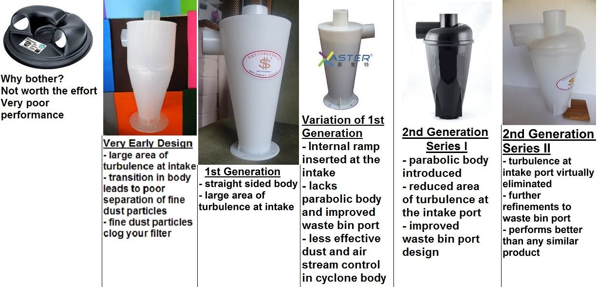

    Is there anything special like baffles or vanes around or under the inlet & outlet ports? I've seen some different models/brands and would swear that there were some vanes directing airflow but they never showed the inside details and I don't know if it was typical, required, or just an added feature that does increase performance.

    I agree, I looked and read carefully and could never seem to get details. Like I said it was seat of my pants on my part. I could not see how a short cyclone could be able to get the vac pipe far enough away from the inlet to be effective. There are no baffles and I decided to not angle cut or taper the inlet pipe. I wanted to direct it to the top inside of the cyclone and shelter the inlet from anything that was going on in the top of the cyclone so it's just a straight piece of PVC just a little beyond the hole in the side of the cyclone. The vac pipe is just straight, 14" down the middle of the cyclone, no baffles and no support except where glued in the top. I have no idea how the guy in the link(BTW thanks for that ) figured out turbulence. I just vac'ed some powdercoat off the floor and the opened up the bucket and the vac afterward to see what happened. To my surprise the powdercoat was flakes in the bucket and not in the vac. I also vac' the mill and listened and it swirls around for a while. Wood and swarf are no problem and somewhat a test. Fine dust is really the test IMHO.

    If it helps, this is all I could find on specs:
    Specifications :
    Material: ABS
    Color: White
    Airflow Capacity: 174-280 m3/m
    Airflow pressure: 2.5-22 Kpa
    Wind speed: 18-28m/s
    Efficiency: 90-99%
    Dust particles: 0.3 μm - 40 mm
    Dimension: Approx. 320mm /12.6''
    Outlet Diameter: 56mm / 2.20''
    This was for the latest plastic version. It also gave these circumstances:
    Cyclone dust collector Equipped with power in three forms:
    1, Connection vortex fans,
    Fan Selection: The minimum power is more than 750W, with high dust removal efficiency, dust removal efficiency was between 90% -99%. 24 hours uninterrupted work. After connected filters the power must be more than 1100w.
    2, Connected industrial vacuum cleaners,
    Industrial vacuum cleaners selection: 220V1200W above, Continuous working time of about two hours. Dust effects above 99.9%.
    3, Connected Household vacuum cleaners,
    Household vacuum cleaner selection is not limited, as long as the power more over 1200W can be used, cleaning is very effective, dust removal efficiency also reached 99.9%. Notice: Continuous use of time can not exceed vacuum cleaner prescribed half hours.
    Then, I found this:
    This new version Turbo charged features a spiral in the air intake, a parabolic body and an improved dust bin exhaust port. These enhancements improve the cyclone's efficiency and avoid the stagnation of particles in the upper part of the cyclone. A tapered exhaust port flange that fits through the collection container lid makes the use of an inner flange unnecessary when using metal or sufficiently resilient plastic lids. A template pictured, for cutting and drilling the collection container lid, and stainless steel fixing screws and washers are included.
    Spiral air intake – quickly establishes a downward flow pattern alleviating the previous models tendency to have particles stagnate in the upper part of the cyclone
    larger outlet in to the collection bin (66mm, old model 60mm) – improves particle entry in to the bin and better separates the incoming and outgoing airflow's leading to greater capture of dust and cleaner outward airflow
    parabolic body shape – dust falls more quickly and loses more velocity than in previous straight sided model leading to greater capture of dust and cleaner outward airflow
    manufacturer claims improved efficiency of 10 - 30%, energy consumption reduction of 20% and minimum 99% particle capture.
    They also had a few videos too, I'm not including those... hope this helps.
