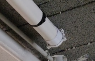

    Here are some photos of my setup :
    End connection to the CNC dust shoe (see my other post about this one)
    Connection of the CNC hose to the port just above mounted on the ceiling :
    View of the PVC hose network, heading towards the shop door, where the remotely activated shop vac is installed.
    Here is the port above the conventional mill, closed when not used.
    I use it on the mill mainly to cleanup metal chips, but as I don't want metal chips in my network, or in my central vac, I have a small cyclone next to the mill to collect these metal debris.
    And here is where the shop vac is installed.
    You can see on the wall this connection box, and sockets marked "Télécommande", meaning "remote control".
    The box is were is installed the remote controlled relay that is used as a switch to power the socket where the shop vac is plugged in.
    Here is the remote control box open.
    And here is the remote control itself, it's radio activated and can reach up to 100 meters away from the relay, it works like a charm.

    Where did you source the spring closed access ports at the end of the pipe runs? These:
    Dust collection network for the shop (high depression)-screenshot-2023-06-07-163450.png
  8. #6
    Jul 2014
    France, Brittany !
    913
    832
    Thanked 1,711 Times in 481 Posts
    Christophe Mineau's Tools
    I purchased the PVC pipes, the ports and also the grey 50mm soft pipes for the curves at an online store here in France called Atepac.
    It's the kind of store that sells household central vacuuming systems and whatever necessary to install them.
    These ports have two electric contacts that can be wired to the vac to trigger it and which are closed when you plug in the hose , which has a chromed metal ring at the end.
    you can see that on this picture:
    The two screws connect the wires, and you can see the metal end of the hose.
    Oh I purchased also the 6 meter flexible pipe with the metal end at the same store, I cut it down for more convenient lengths, but it's far better than plumbing flexible pipes, which are way too stiff.
