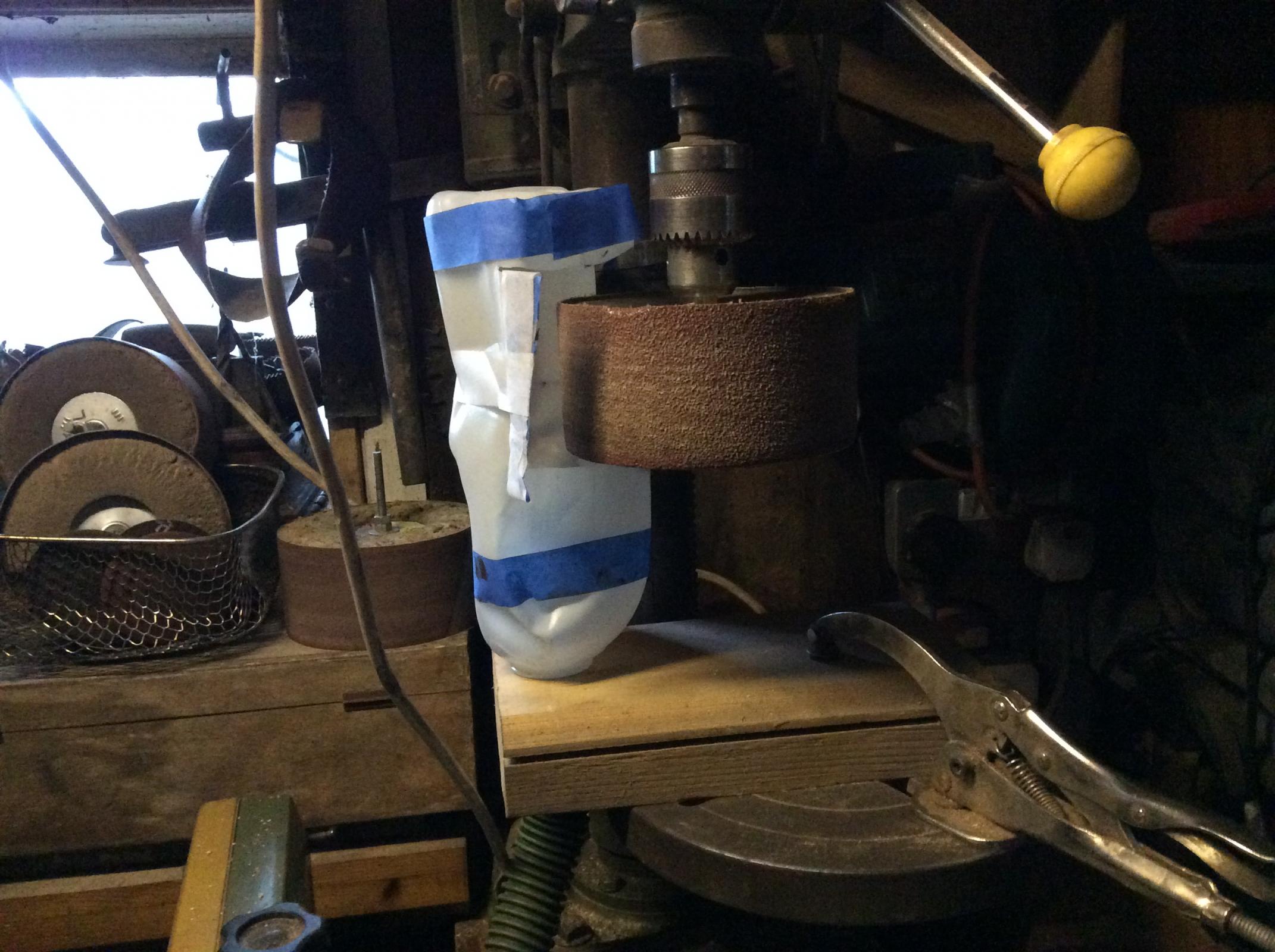

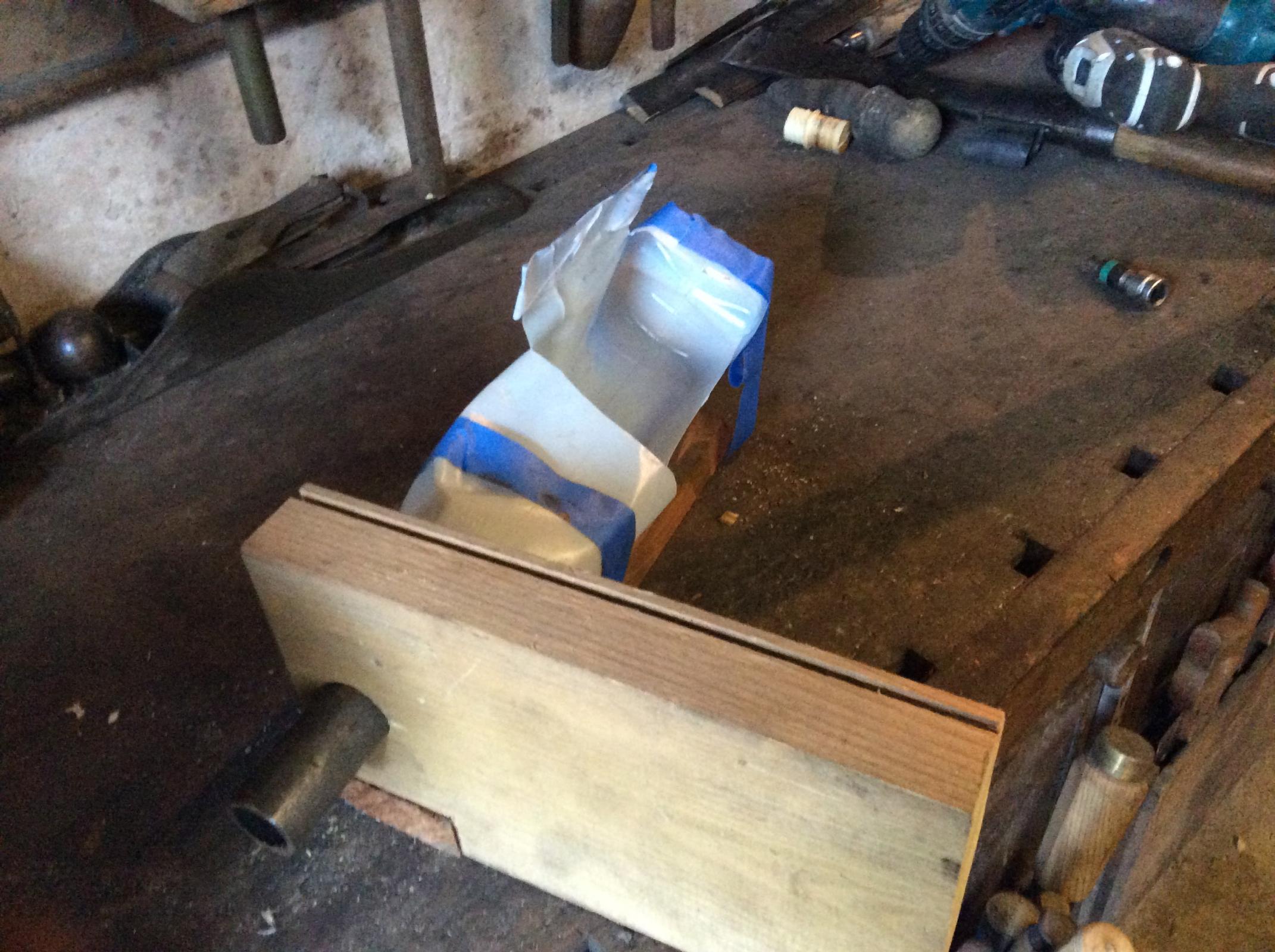

    This is very rough and ready. Dust catcher for drum sander (bench drill attachment)-b62bf025-813b-4514-8fb2-63db56d43574.jpg
    That is a milk jug you see.
    Not sure how efficient this will be but it must be better than none!
    !Dust catcher for drum sander (bench drill attachment)-85338301-65e8-40b1-befc-3c30b810bf08.jpg

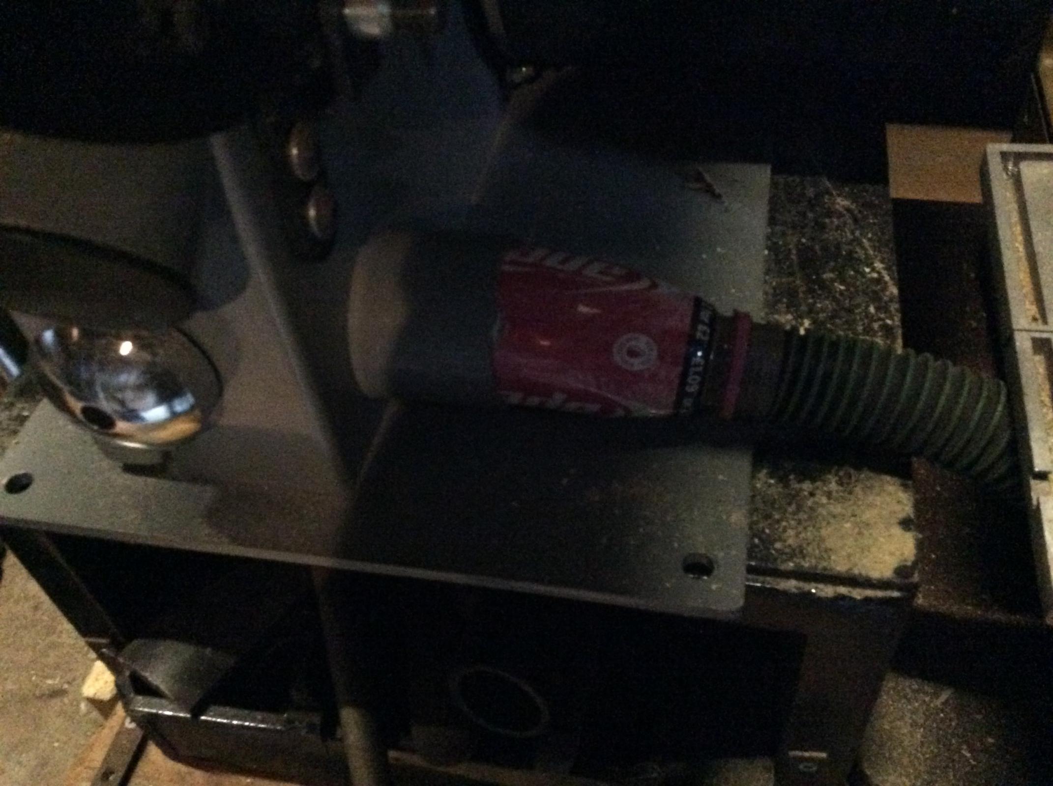

    I was not going to include the thumbnail picture, and deleted it. However, if you can make it out, it shows the reduction sleeve, formed from a plastic Lucozade bottle, which serves to collect dust from the bandsaw nearby
