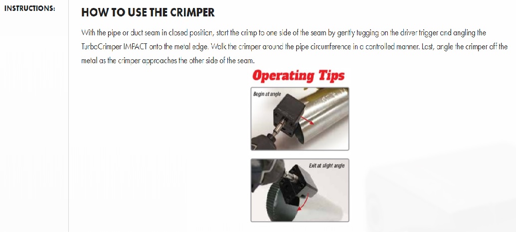

    What’s inside?
    Rick
    Rick

    I would guess two gears.
    That, or possibly a pair of dies, driven by a rotary cam (?)

    Cams make sense. The gears must back away to allow the metal to enter
    Rick

    Seems to have no eccentrics, a mere 2 gears (with tapered ends?) and loose fit is rugged and "field expedient" enough,
    as the manufacturer's own instruction tells you to enter/ exit at an angle:
    2 cents
    Johan

    Ah, now I understand. The key is that you enter and exit at an angle. I didn't see that part of the process in the video.
    Rick
