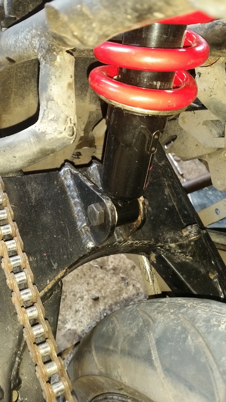

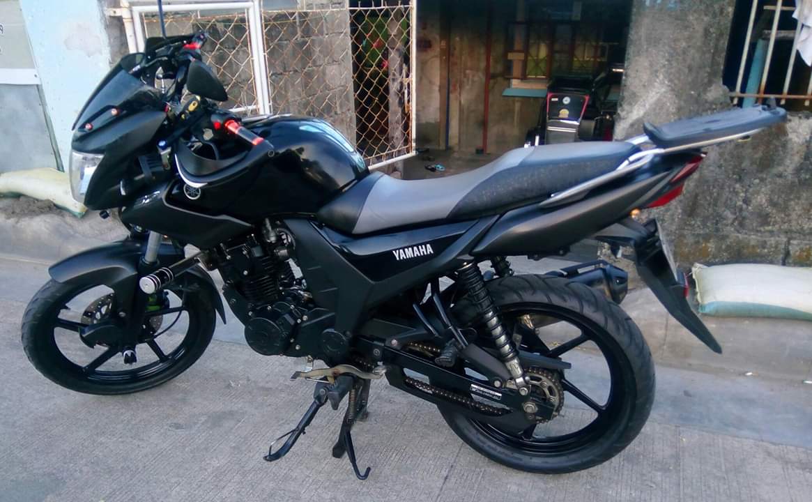

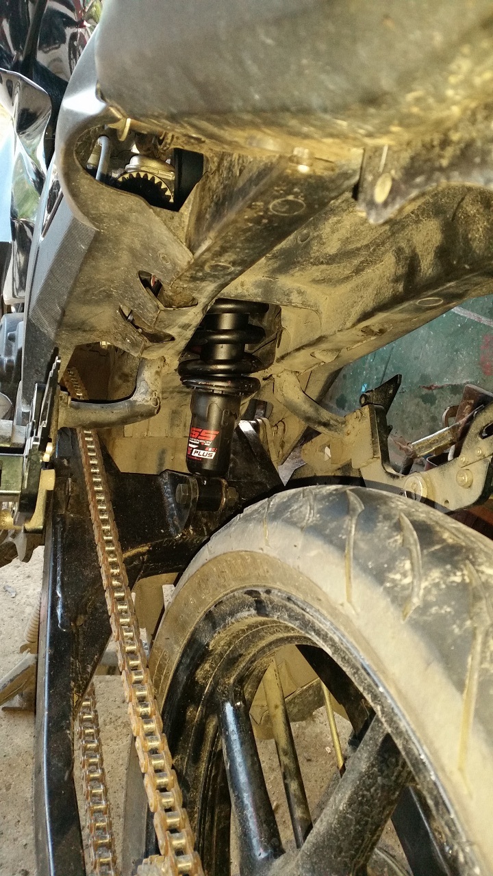

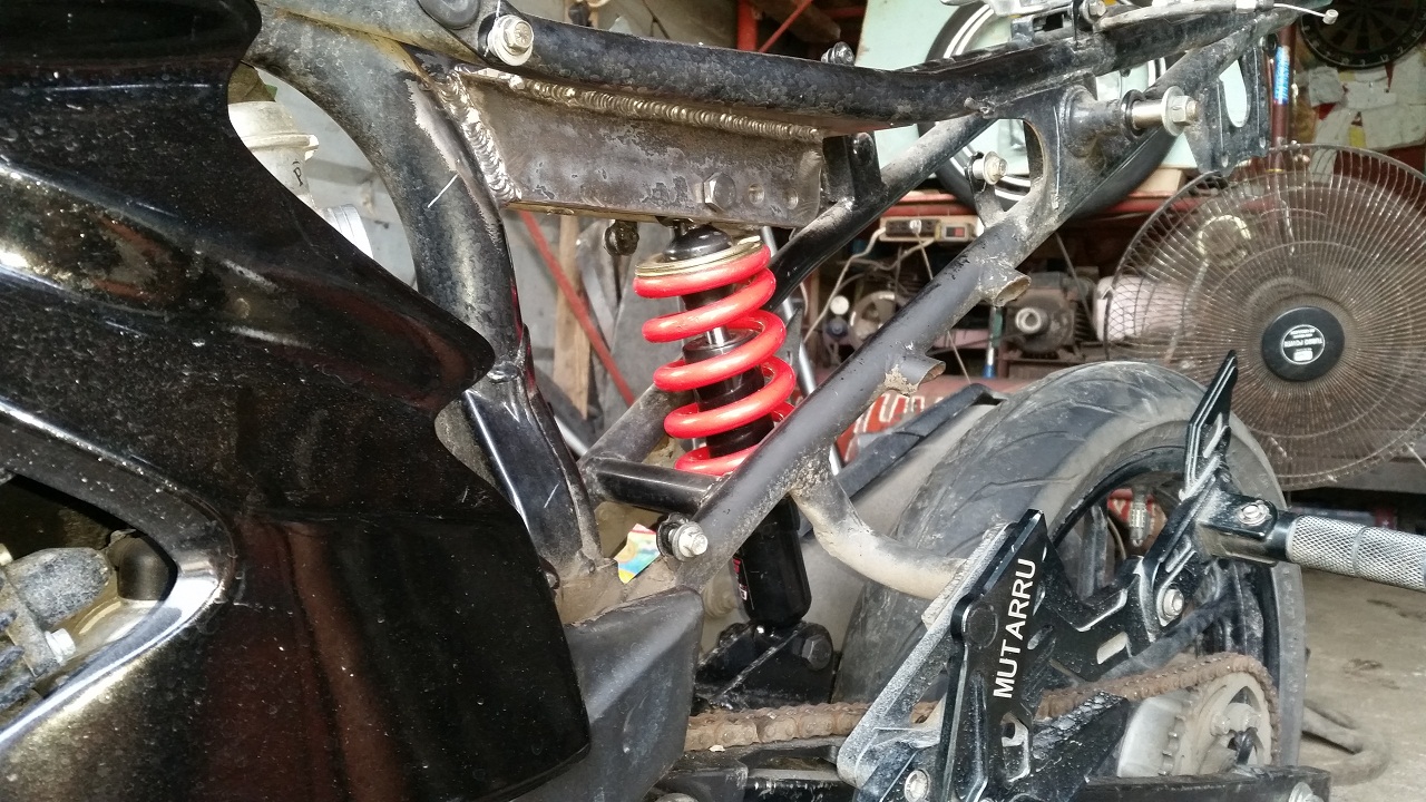

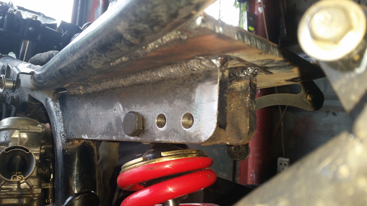

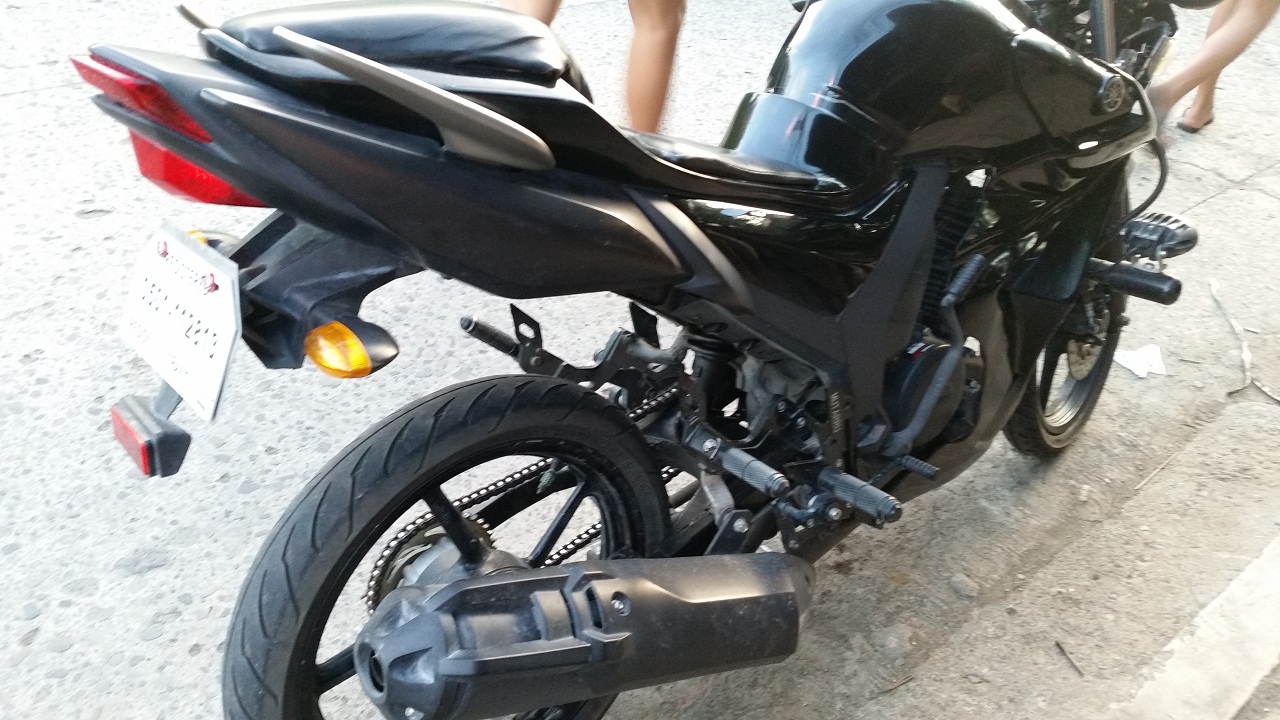

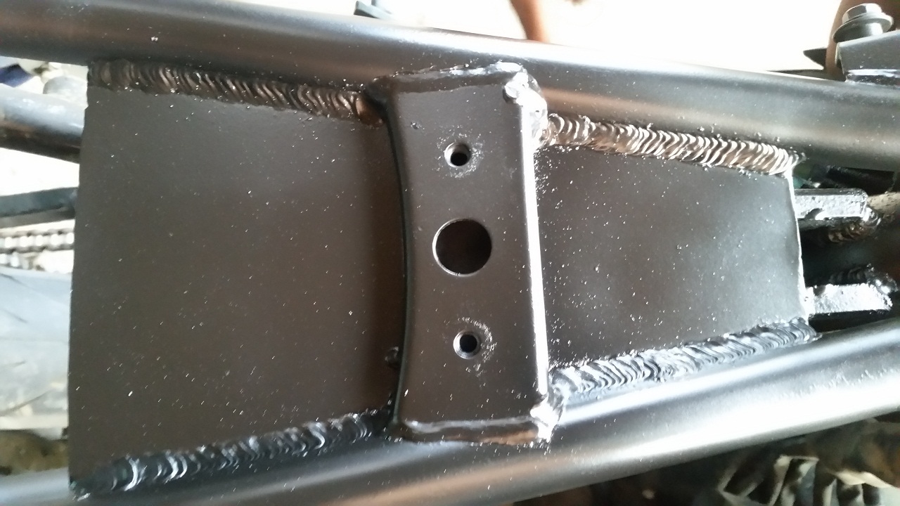

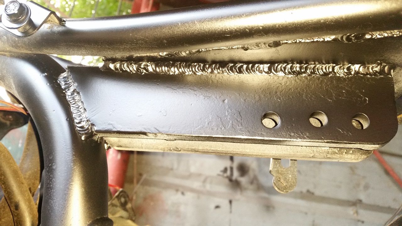

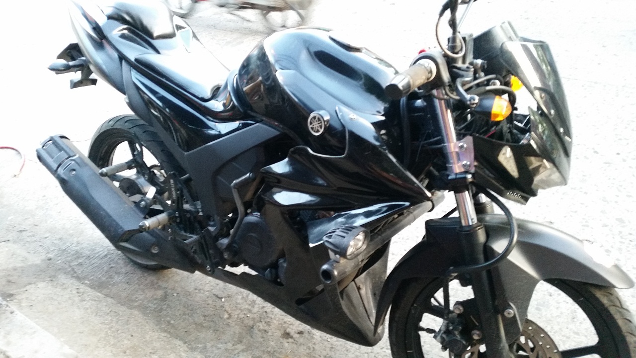

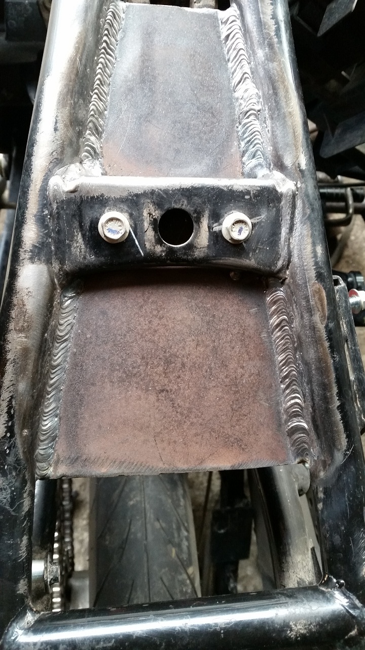

    Guys this is my neighbors motorcycle he wanted me to convert his
    motorcycle dual to mono-shock and that is the result and i want to share it to you guys
    This is the original model look like when dual shock plug in
