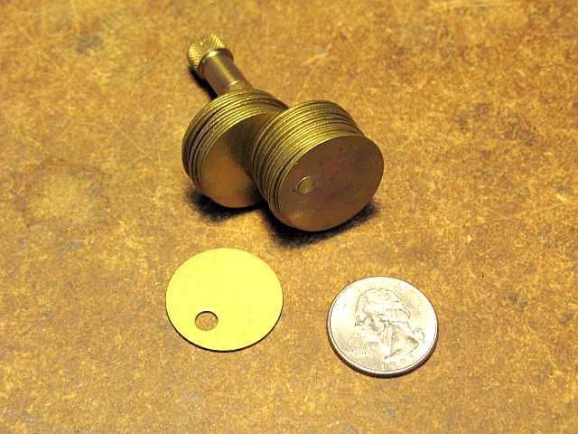

    Sometime ago I acquired more brass key tags than I will ever need and so decided to make an adjustable spacer with them...

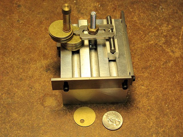

    I've used it numerous times on my milling block...
    but, now, with the benefit of your post, I realize it would work perfectly as an adjustable vise shim.
    Regards, Marv
